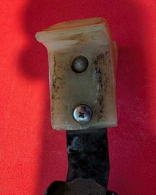

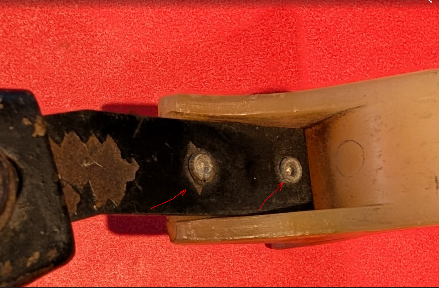

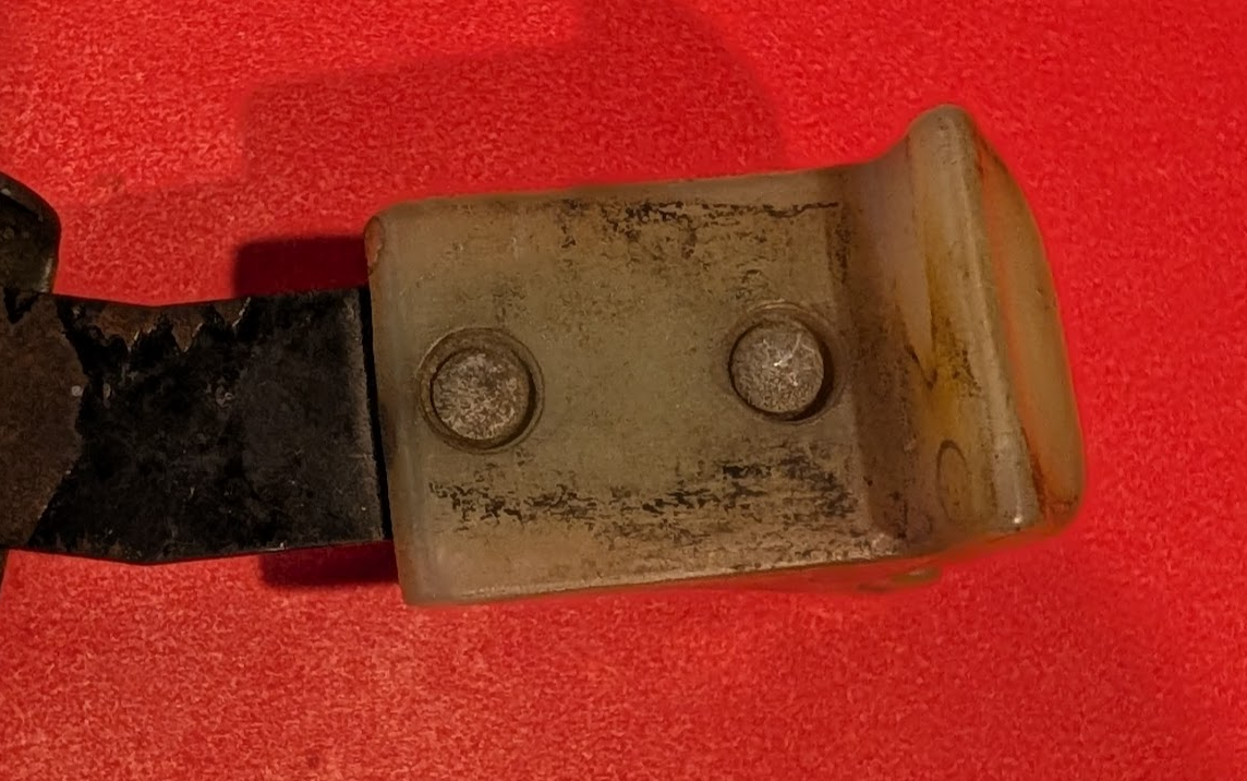

I'm in the process of reproducing the 70-71 E body Manual top hold down plastic latch and I wanted to get your input.
The OEM fasteners are pressed in rivets requiring a press and a die to compress the shaft of the rivet. Most of us do not have the tools required to sucessfuly install rivets.

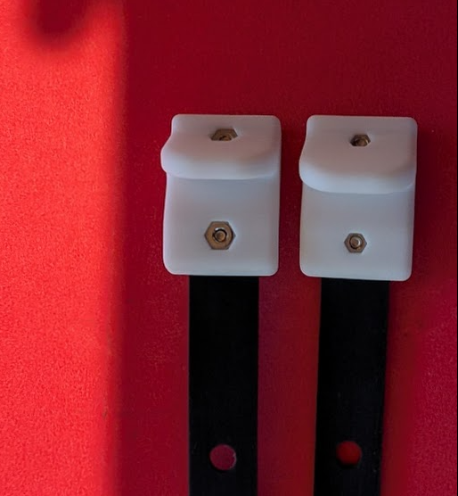

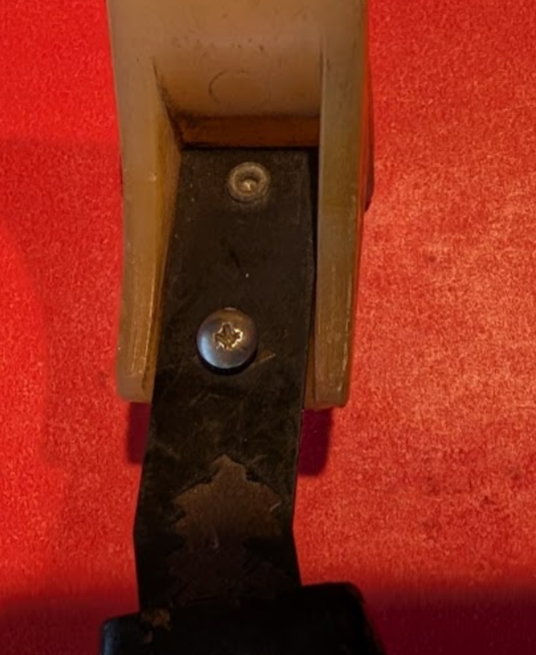

The 65 A Body has the same part but is shaped differently. It originally was held in the same way with 2 Rivets. I modified the design to accept a captured nut and use 2 4-40 or 5-40 screws (haven't decided yet) to attach it.
This is the look
For the E body I can do the same and have a captured nut on the side where the OEM rivet head is OR have the head of the screw where the existing head of the rivet is with a nut on the back side.
Here are mock ups of the options:
Screw head on the rivet head side
Standard sized 4-40 nut on the opposite side (you can see in the photo of the 65 A Body part there are 2 sized nuts, standard and small either could be used)
Captured nuts on the rivet head side
4-40 Nut (It would be captured in a hex shaped recess. you can see in the photo of the 65 A Body part there are 2 sized nuts, standard and small either could be used)
Screw head on opposite side
A pop rivet is an option but I think the blob of the pop rivet look cheap.
Let me know which way you all prefer.

A rivet won't loosen up as quick as a screw if at all. I think a drop of blue Loctite would be a good idea. Or just spring washer. If posable. A properly sized pop rivet when compressed wouldn't have to much pressure on the material. Clearance would have to taken into consideration.

A rivet wont loosen up as quick as a screw if at all. I think a drop of blue Loctite would be a good idea
The a body guys are trying to talk me into rivets, I think I'll make it for a screw with the head where the rivet head is. That way if someone wants to rivet it on they can.
And I expected a drop of lock tire would be a good choice.

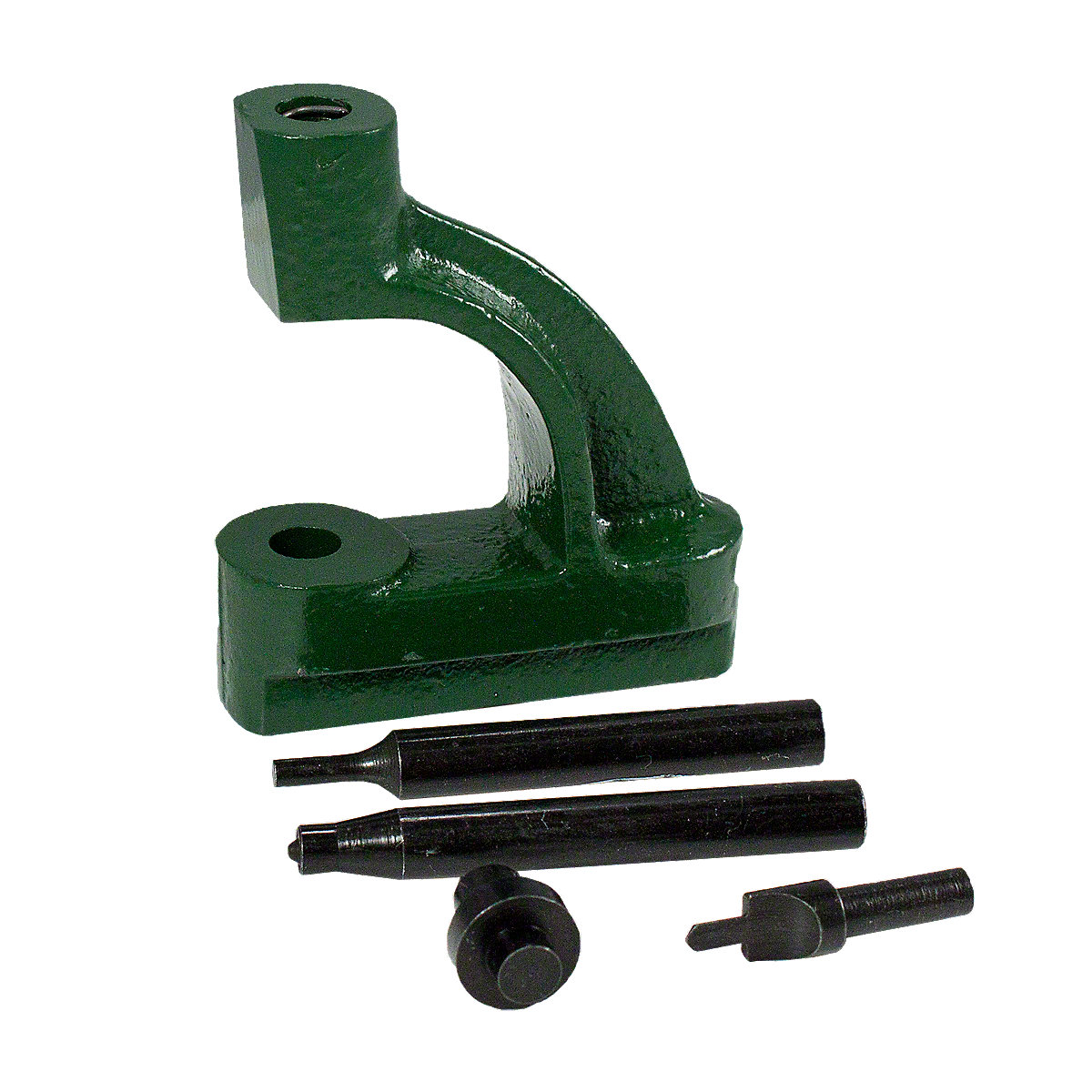

As far as the expense. I was referring to a piece of equipment like this. There is type that is manual . It is operated with foot power. There is a small hand job type. That doesn't sound right! I have one somewhere. I'll have to look for it.​
Mild Steel Brake Shoe Liner Riveting Machine (Hydro Pneumatic), Riveting Capacity: 3 - 12 Mm
