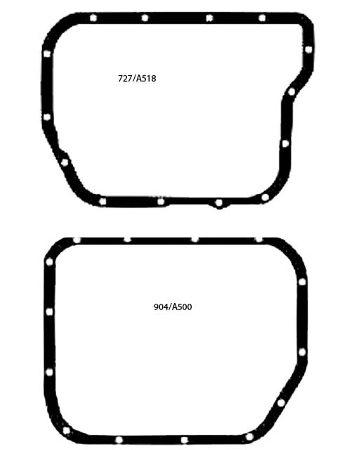

The car came with a 904. Same trans that came from the factory in my '74, same code on the data plate.
Wanna be sure that it hasn't been swapped out in the intervene years check the pan.
The 904 can safely handle around 300 horse in fairly stock form with a just a few bolt in mods. A 904 can be built to handle what you want if you're willing to pay the price. But if you're looking for a drop-in, with just a few mods for longevity's sake, hunt down a 727.

You right Ramenth hard to find reliable info. I did find that S/6 and 318 came with 904's. Only way to know for sure though is to ID it. Here is a link to a thread that may help you do that. http://www.forebodiesonly.com/forum/showthread.php?t=62
904 is a good trans and can be built to handle 400+hP. The 727 is stronger stock but will also have more power loss through it than a 904. I would just use what ever trans that is in it m self but thats just me.
