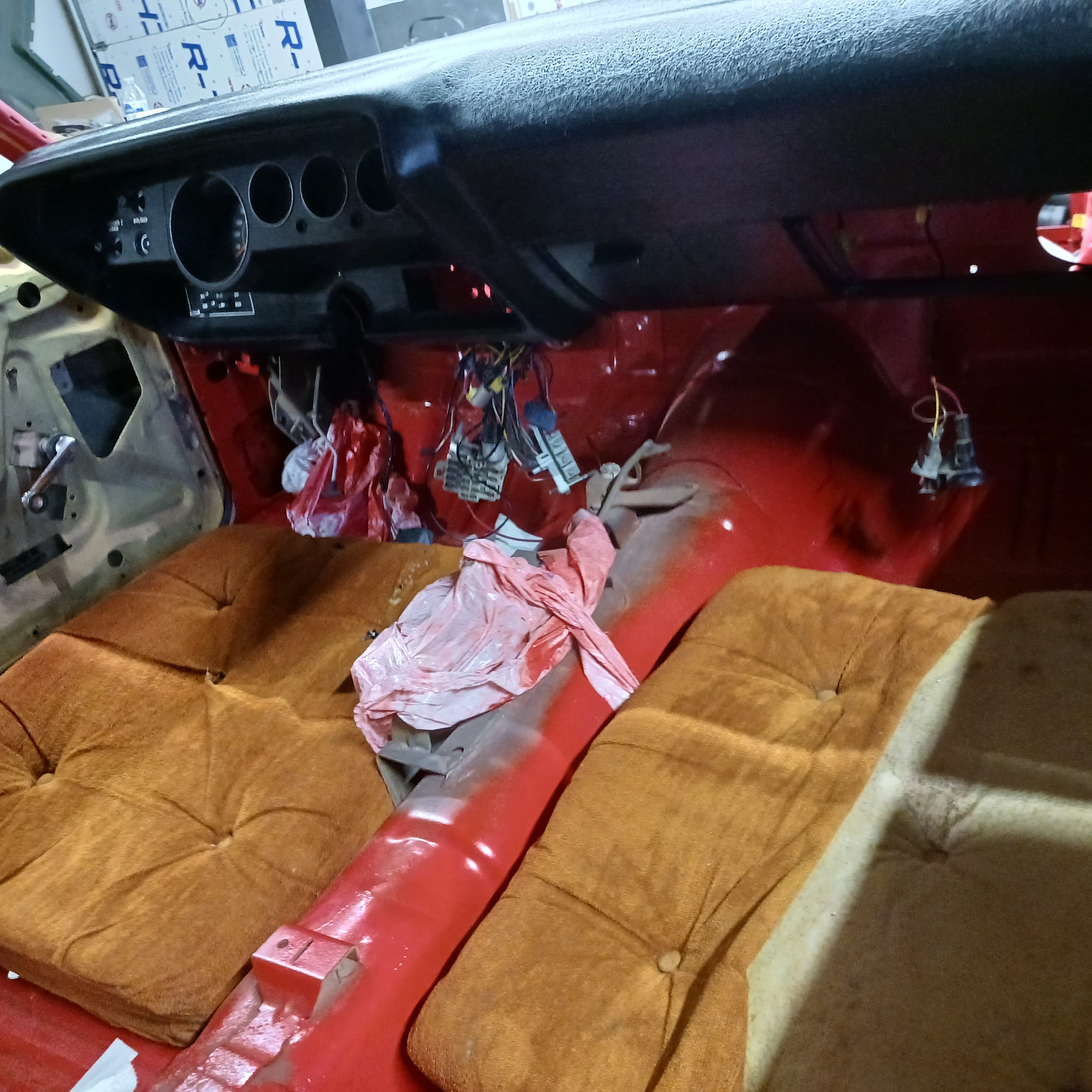

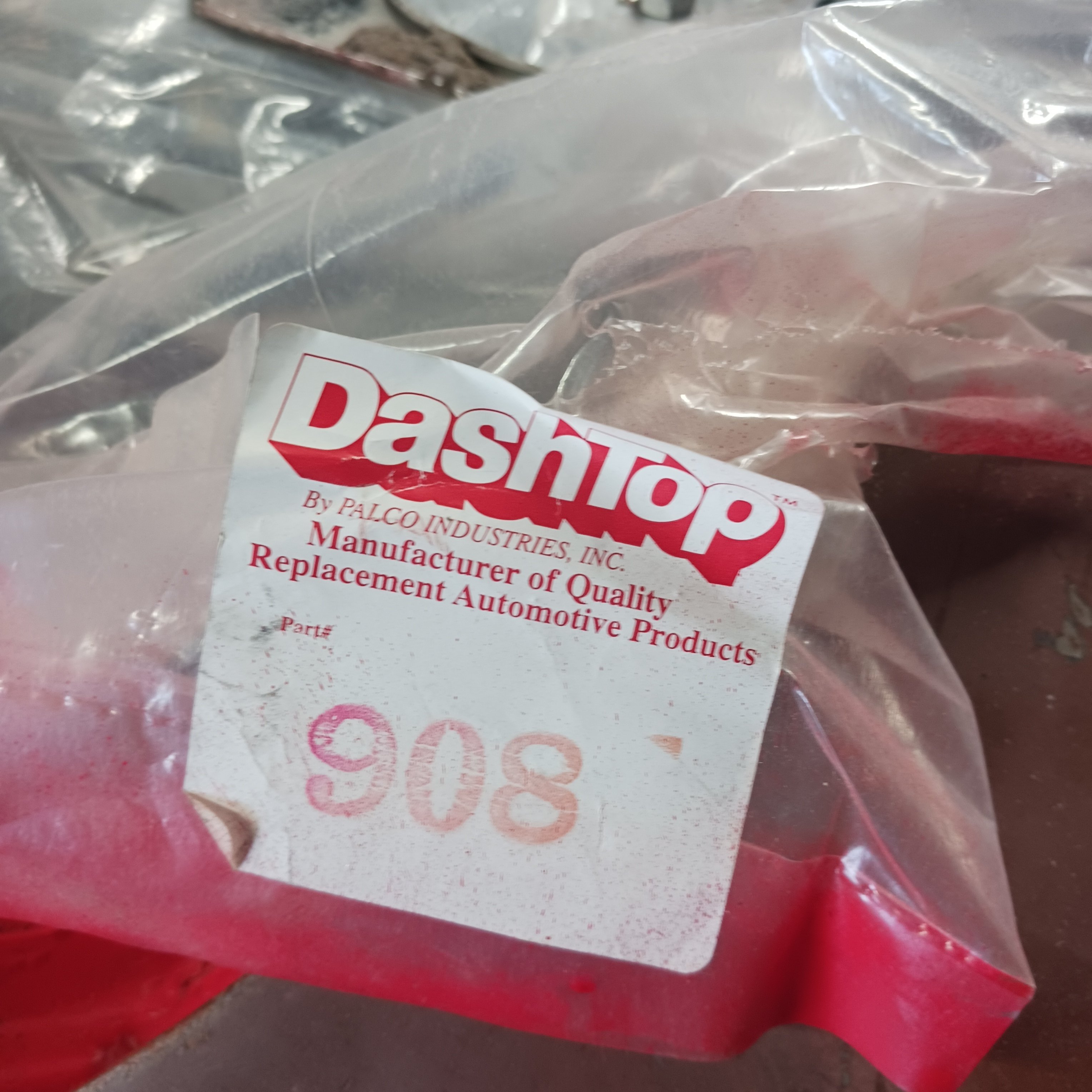

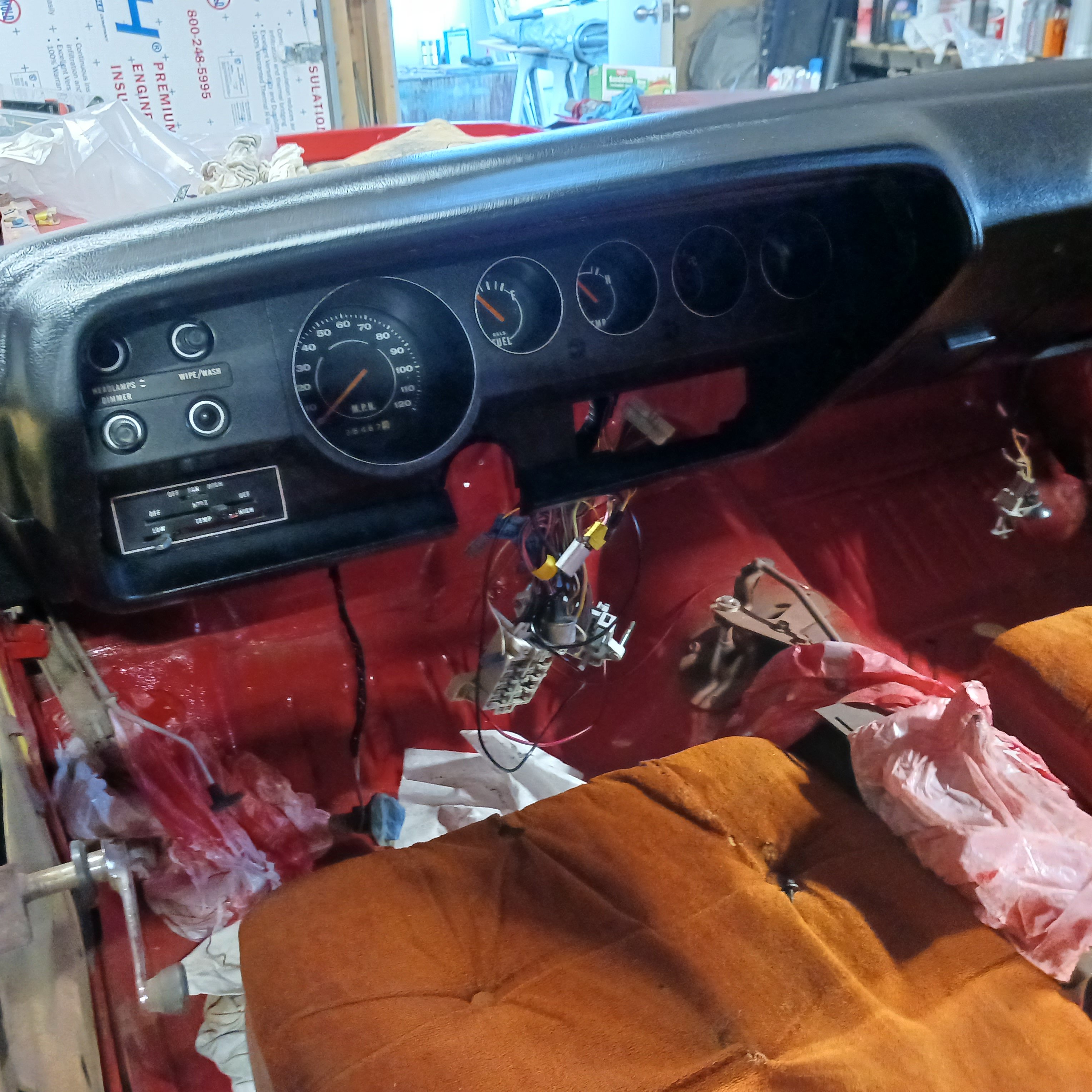

It depends on what your plans are for the car. A driver that you won't be entering in car shows to win trophies will probably be an okay use of a dash cap. As stated, it's a hard plastic cover that goes right over the cracked pad. Some prep work needs to be done so the dash cap looks okay. The grain is different from the vinyl grain. I have a dash cap installed in my 72 Challenger I'm working on. Trimming is required and you can see the edges when looking around the VIN tag recess, the front edge near the windshield, bottom edge of pad and around the pad ends at the door. I used more silicone adhesive than the tube that came with the dash cap. Ad I said, it's okay for a driver and costs less than $200 compared to almost $2000 for a vinyl one. Here's a couple of photos of mine. In a couple of areas, I very carefully used a heat gun on low setting to reshape the cap.
