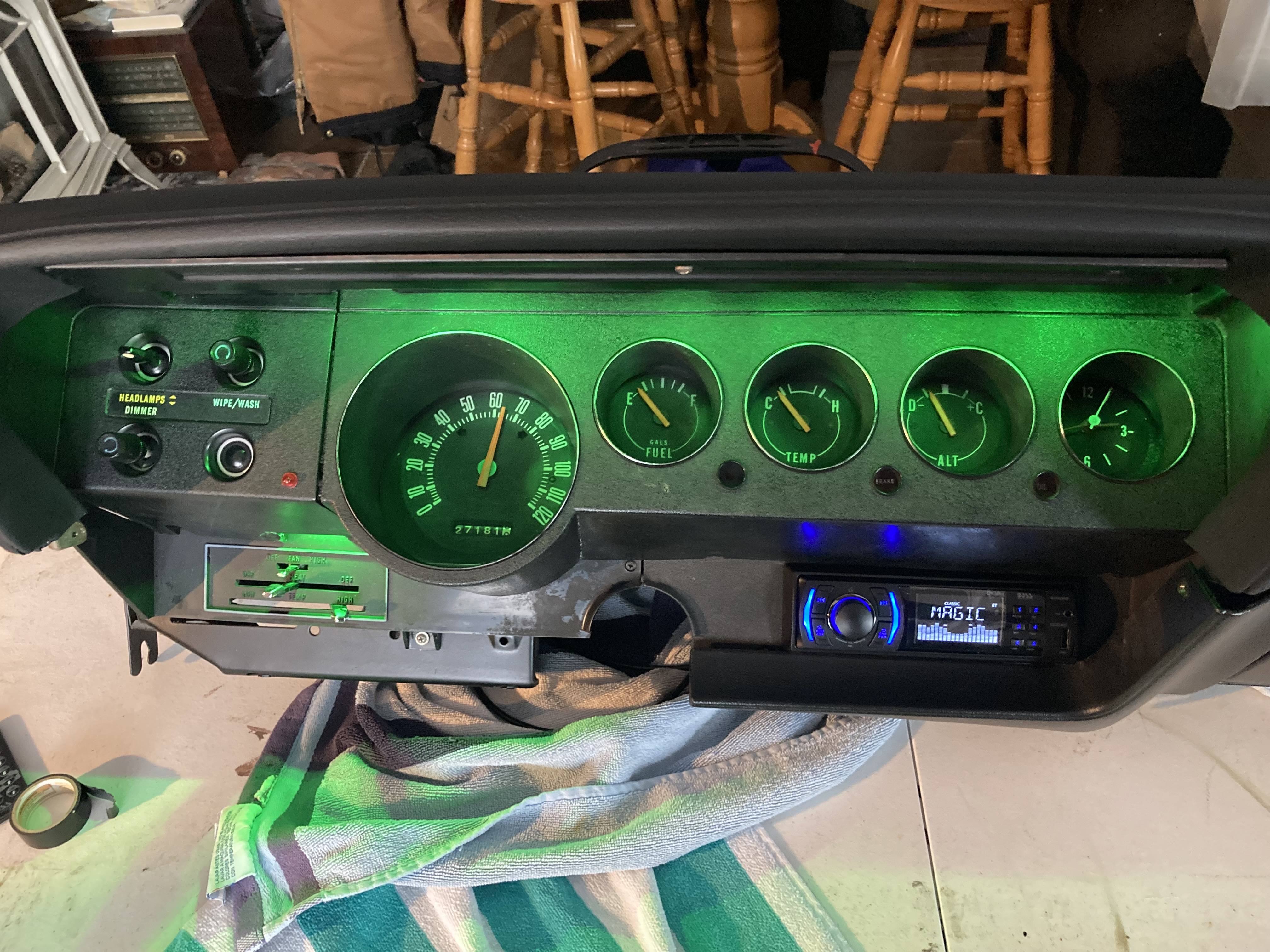

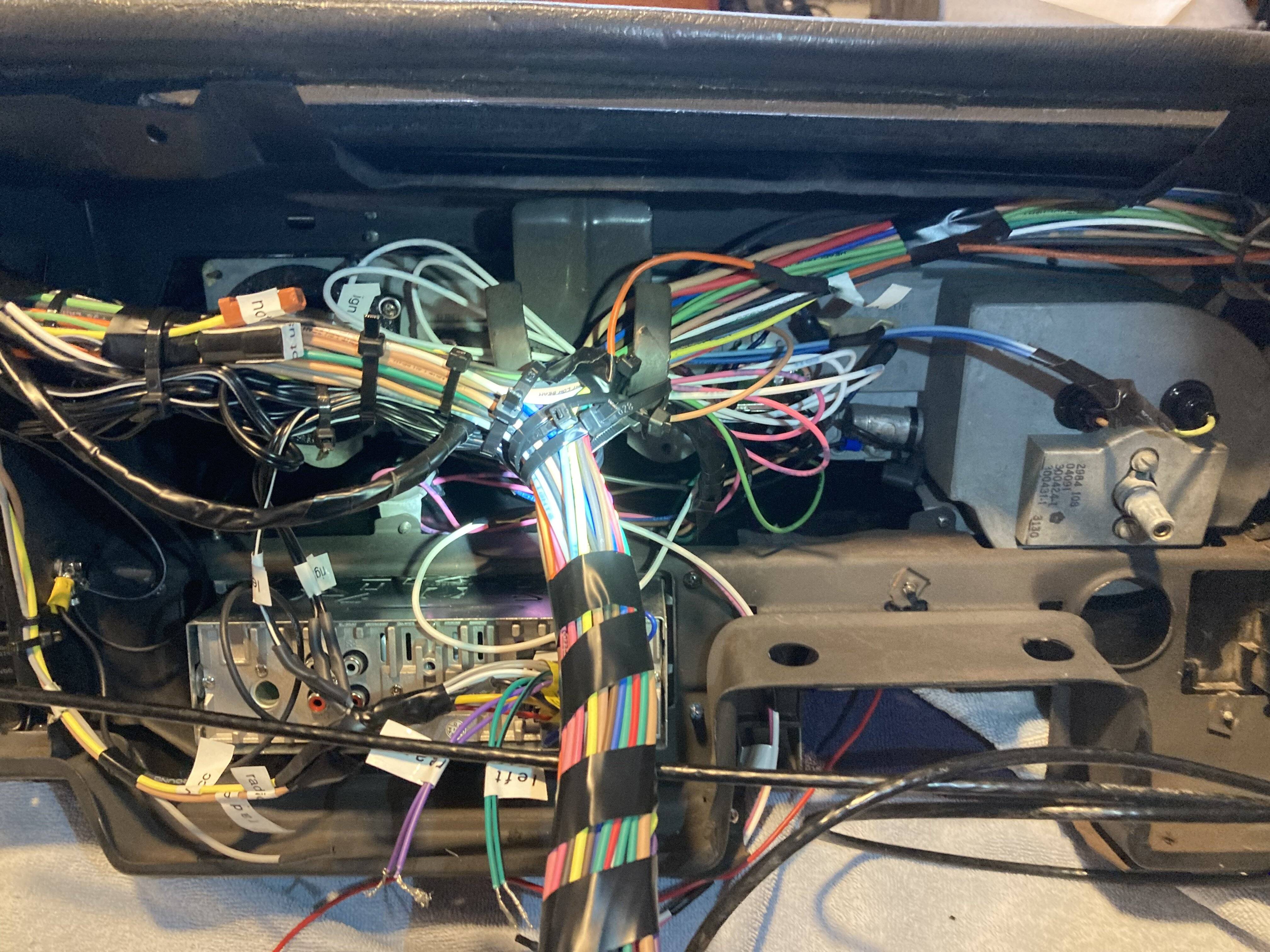

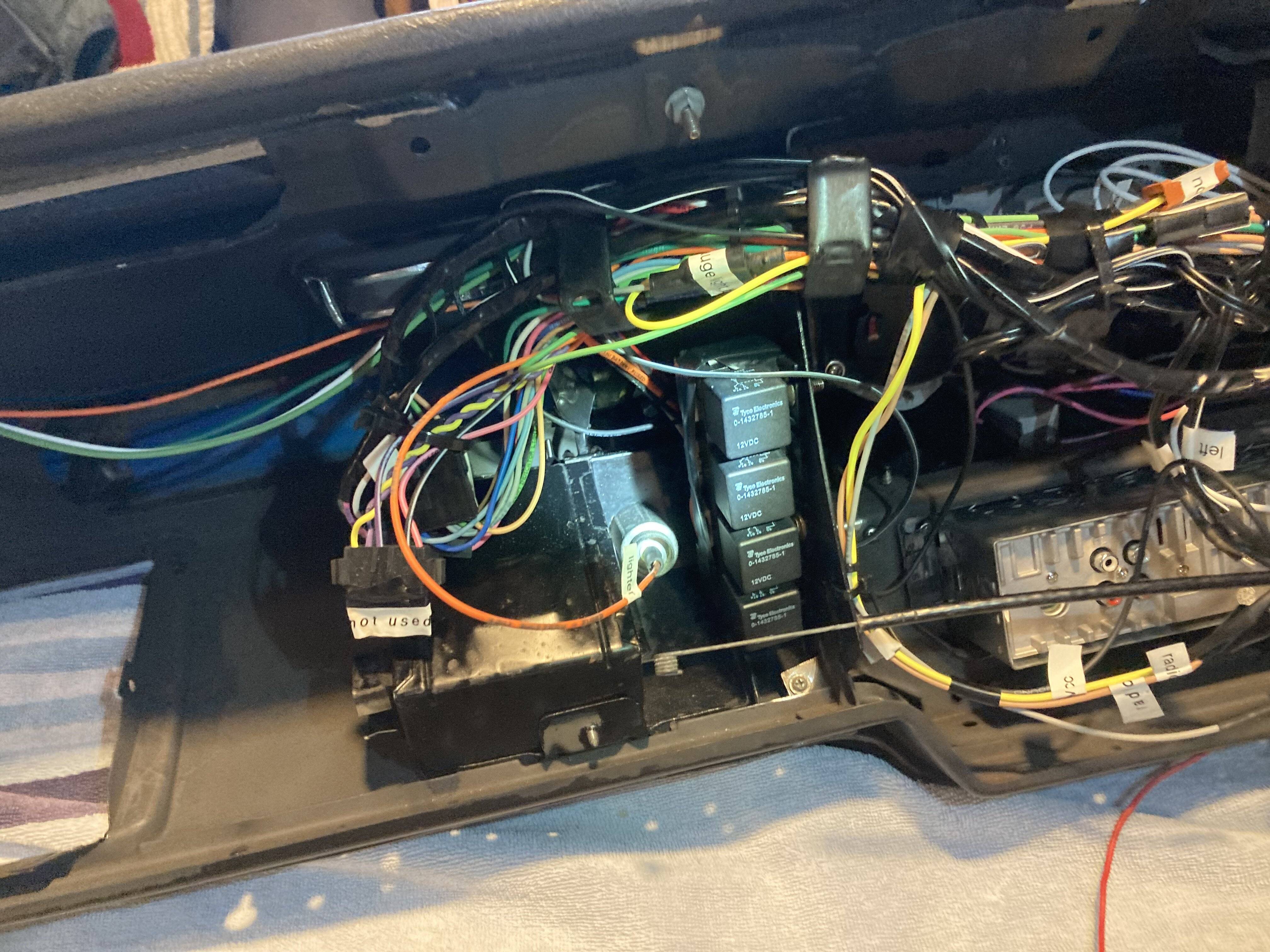

Using a kit from American Autowire I have rewired all the dash switches and gauges in my '71 Challenger. Dash reskinned by Just Dashes in El Paso. Used to be brown. Painted the plastic and metal satin black. Aftermarket battery powered clock fits right in. I labeled everything. Even the stuff not used as I get older I will forget! Used a RETRO SOUND dash speaker. Sounds great through the BOSS receiver and bluetooth. All I need is my #$%^& car back from paint where it went the Friday before Memorial Day in 2021. Will save the negative story for another time. Special thanks to @Rapidfire for the brake light indicator lens. Much appreciated! - TJ

Any idea how the light bar is fastened to the dash pad?
Should be 6 screws hold if up, looks like its mounted in the pic. an fyi instead of cutting excess off of wire ties twist with side cutters they will break off flush. No sharp ends sticking out.
The 3 under the lip of the dashbpad don't seem to have a hole in the metal frame of the pad???
drop the light bar out completely and check the frame for the speed nuts in their locations and make sure they are centered. You're out of the car so dropping the light bar on the steering column isnt a problem!
Thank you I will check again tomorrow. I used a pick and could night find any holes in the metal. Now that I know what I am looking for I will be a bit more liberal Thanks! Todd
