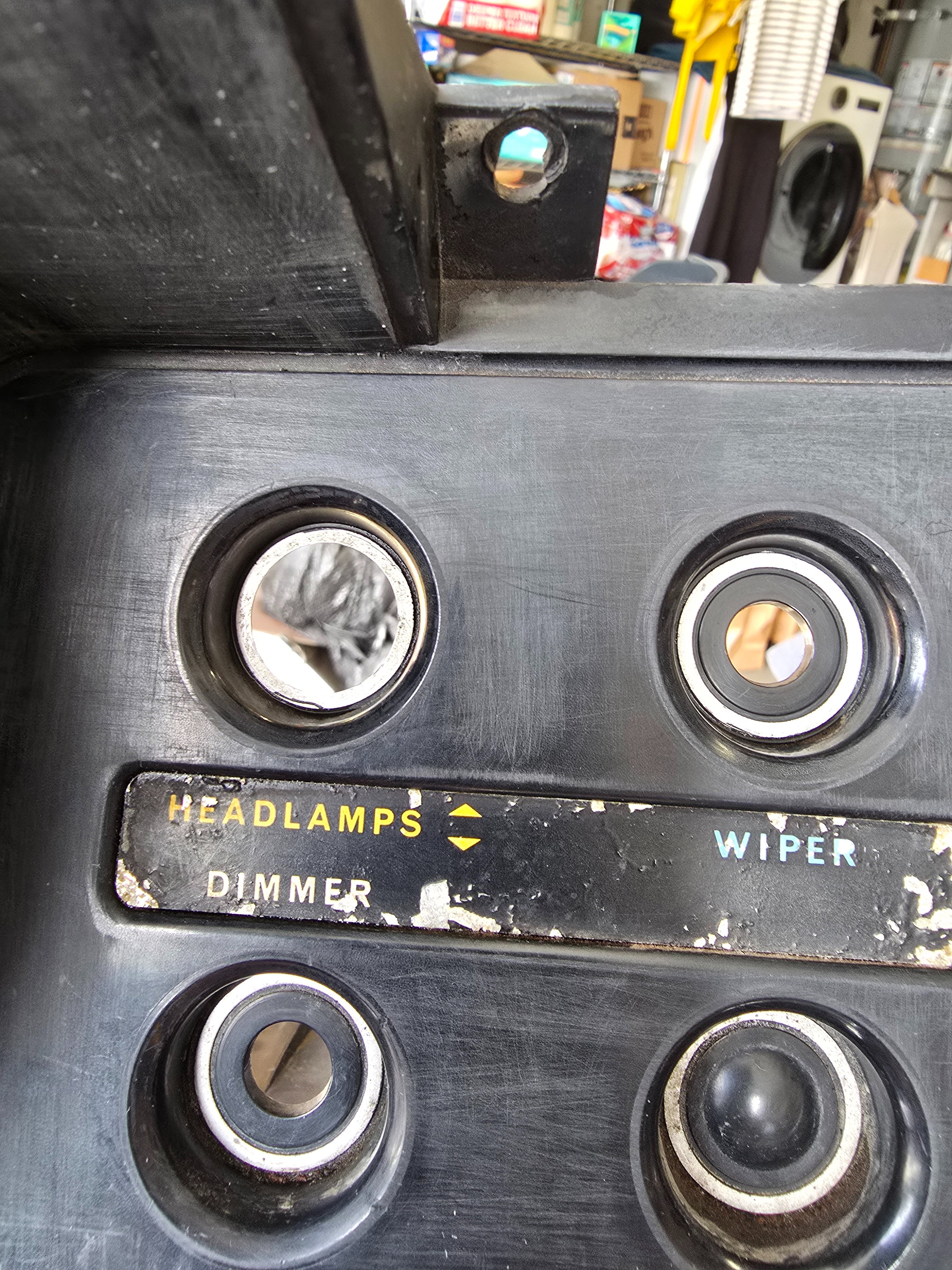

Does anyone know where I can find a sticker or decal for the headlight, wiper, and dimmer? I plan on painting the panels and would like a new decal. Thanks

That is the standard dash switch plate.
Performance Car Graphics has the new plates - or they did?
Set the switch plate up flat and soak the decal plate in turpentine over night to break down the glue.
I just levered my one up with a toothpick.
Fix the new one on with Elmers rubber cement.
I just ordered a new switch plate. Thanks for your help.
