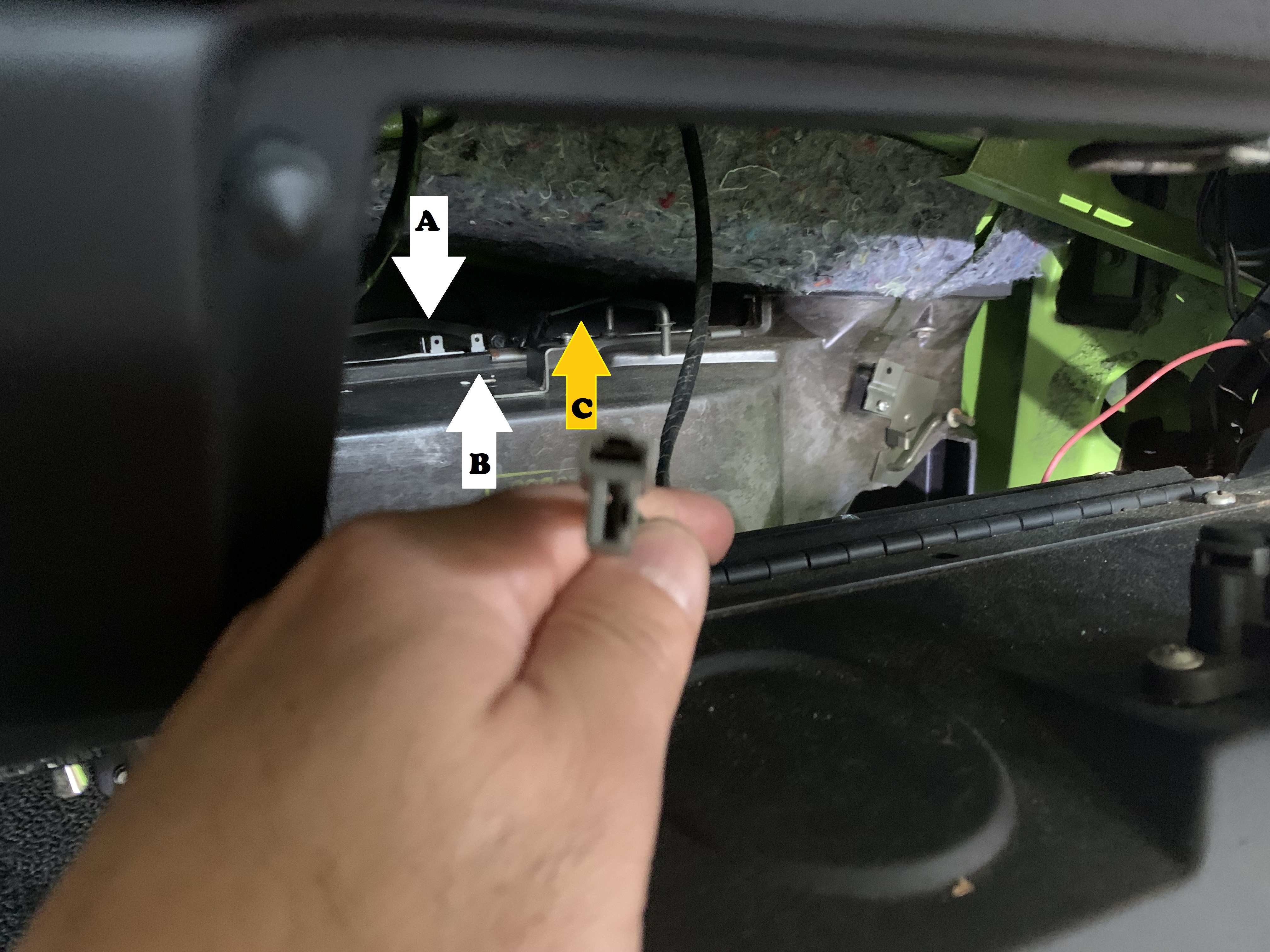

KennyCuda, my car is taken apart so I took some pictures. You can easily access the connector at the heater box if you remove the glove box. I checked my FSM and the FSM does not show where the resistor is. I believe the resistor is inside the heater box. The FSM just says there are two wires going to and connecting at the heater box (high and low) but my box has 3 connections. My guess is the 3rd connection is for the ground. I am not sure why the FSM does not show the 3rd wire. Perhaps it is shown in a different schematic than the one I was looking at. The 3rd wire may eventually go through the nuts that hold the motor to ground but I am not sure about that. Maybe someone else can chime in.
In the picture below arrow A is pointing to where the hot wires go from the High/Low switch; arrow B is pointing to where the 3rd wire goes, the wire I believe to be ground; and the orange arrow C is pointing to the 3rd wire. It is hard to see. I am holding the connector (sorry about it being blurry) which should be the High/Low hot wires. It's the only wire connector that will fit my heater box. I would check for 12V on each one of these wires at the connector. If you have 12V at the connector then I would look for a ground problem or a motor problem. Even if the resistor was bad it should still work on High. Also looking at the connector in my hand, the bottom connection is the High and the top connection is the Low. If I am wrong about any of this please correct me. I am not an expert. I hope this helps. Good luck and keep us posted.

Thanks what a big help after i checked the switch which is good I found out the dark green wire is positive. On the top of the box you show 2 wires go to one side and one to the other. I tested the 2 wire side dark green wire and im getting power there which plugs into the resister which mounts from inside the box just the tabs stick out, Then I checked the single side which is dark green and im getting power there also which tells me the resister is good,( the single plug goes right to the blower motor) Then I said if the motor is getting power it might be a ground so I used my test light as a ground and scratched the ground lead hoping the motor would run but it didn't so im 99% sure the motor id bad, bummer
