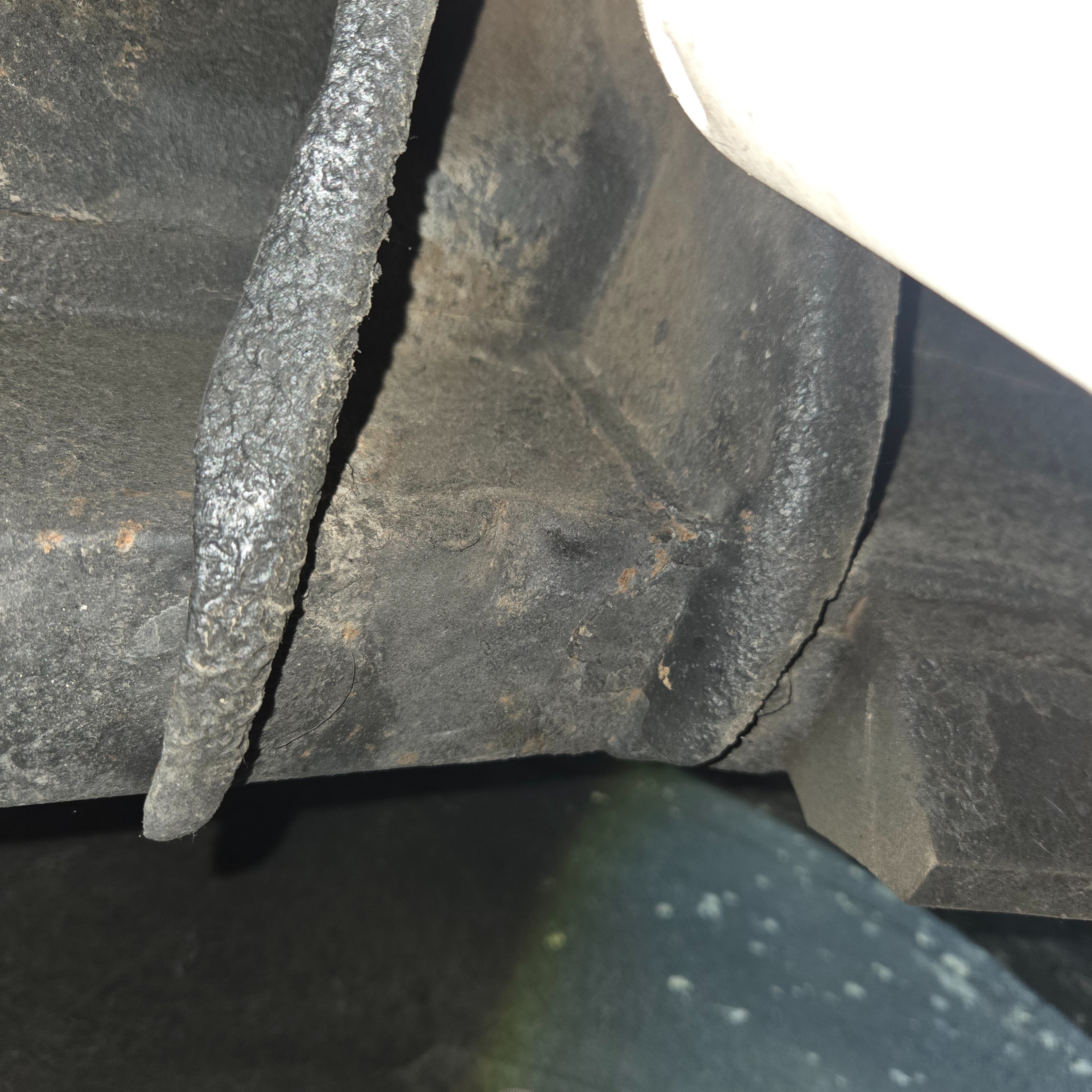

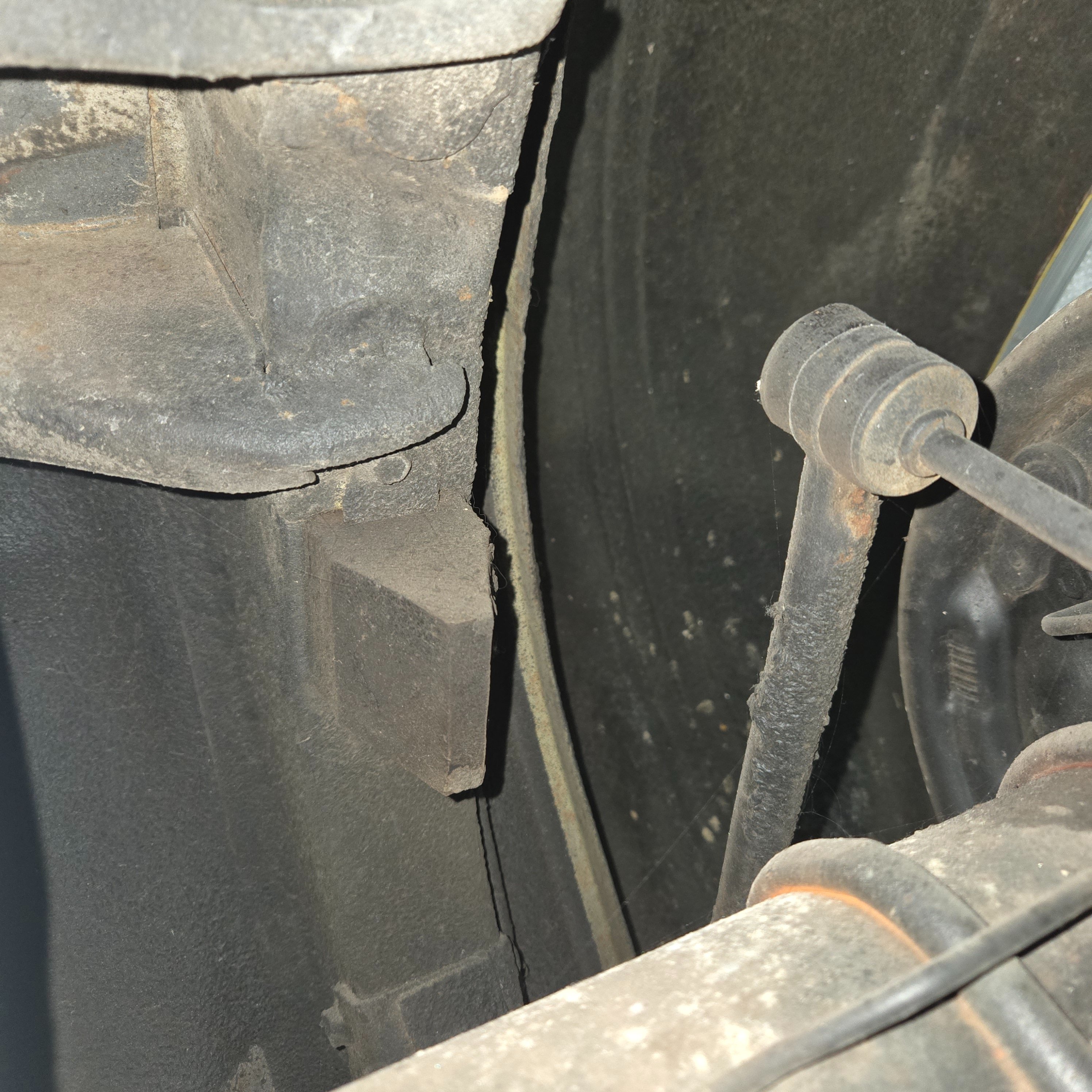

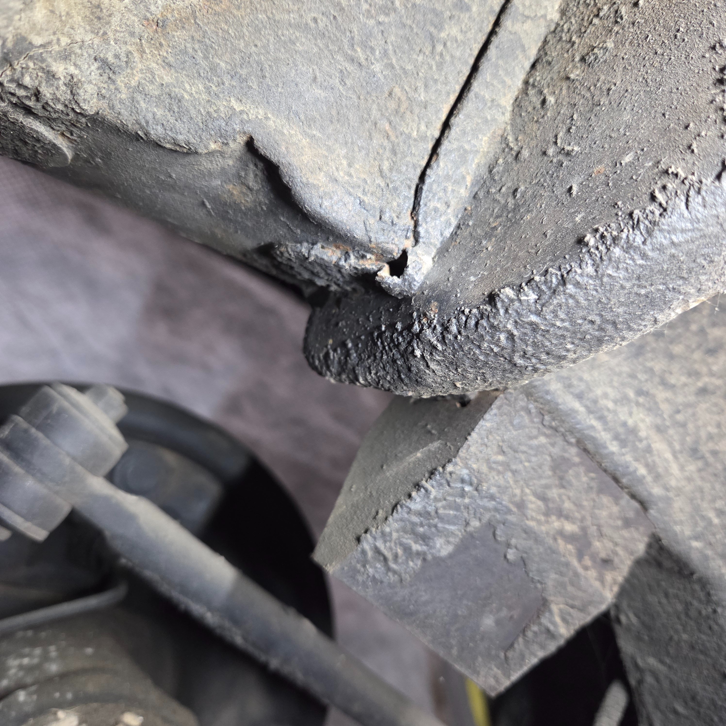

Hello all,
Been working on my 70 challenger and noticed some dents in both sides of the rear frame rails above the axle. It looks like someone hammered them but for the life of me I can't think of any reason someone would do this...everything appears normal on the axle and sway bar incase something had broken and hit the frame rails. Passenger side is worse as seen in the pictures.
