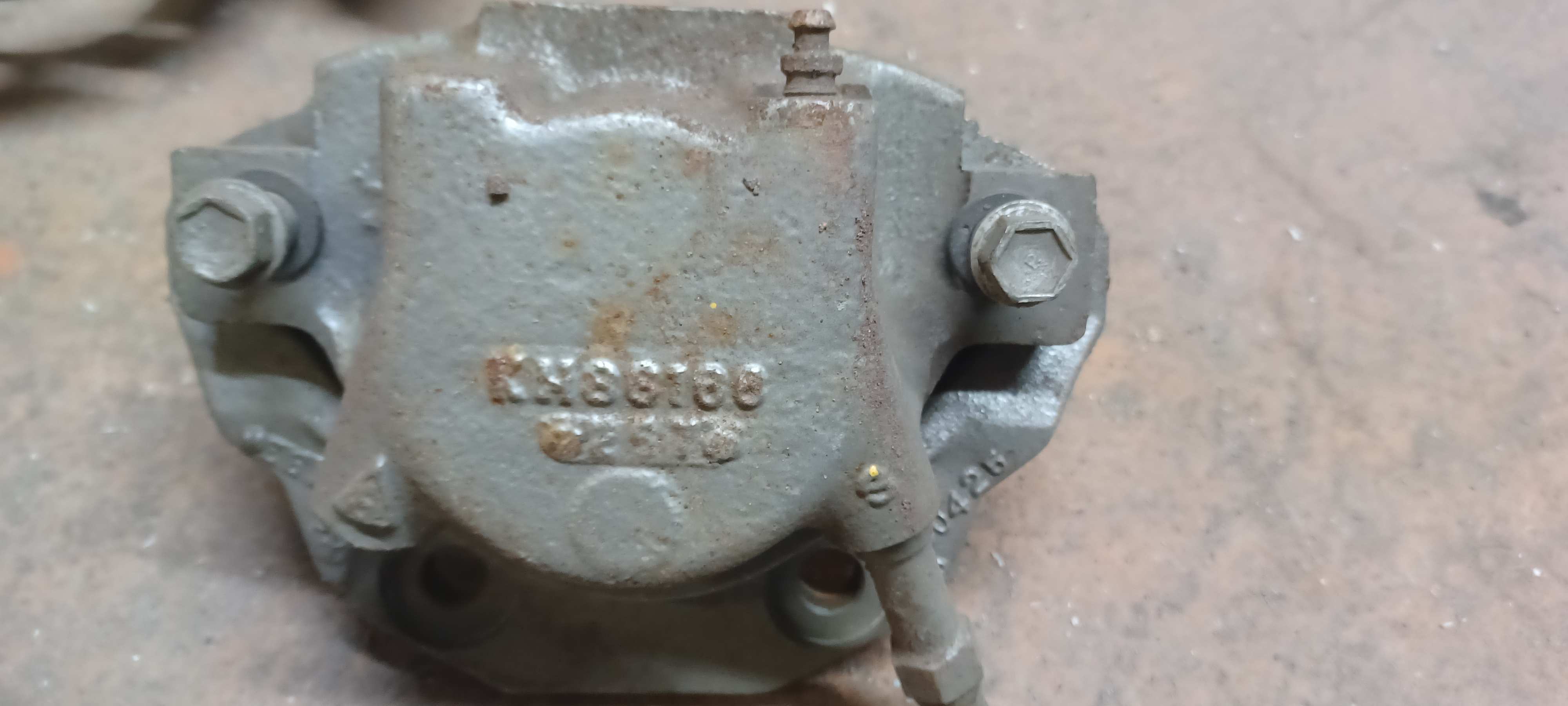

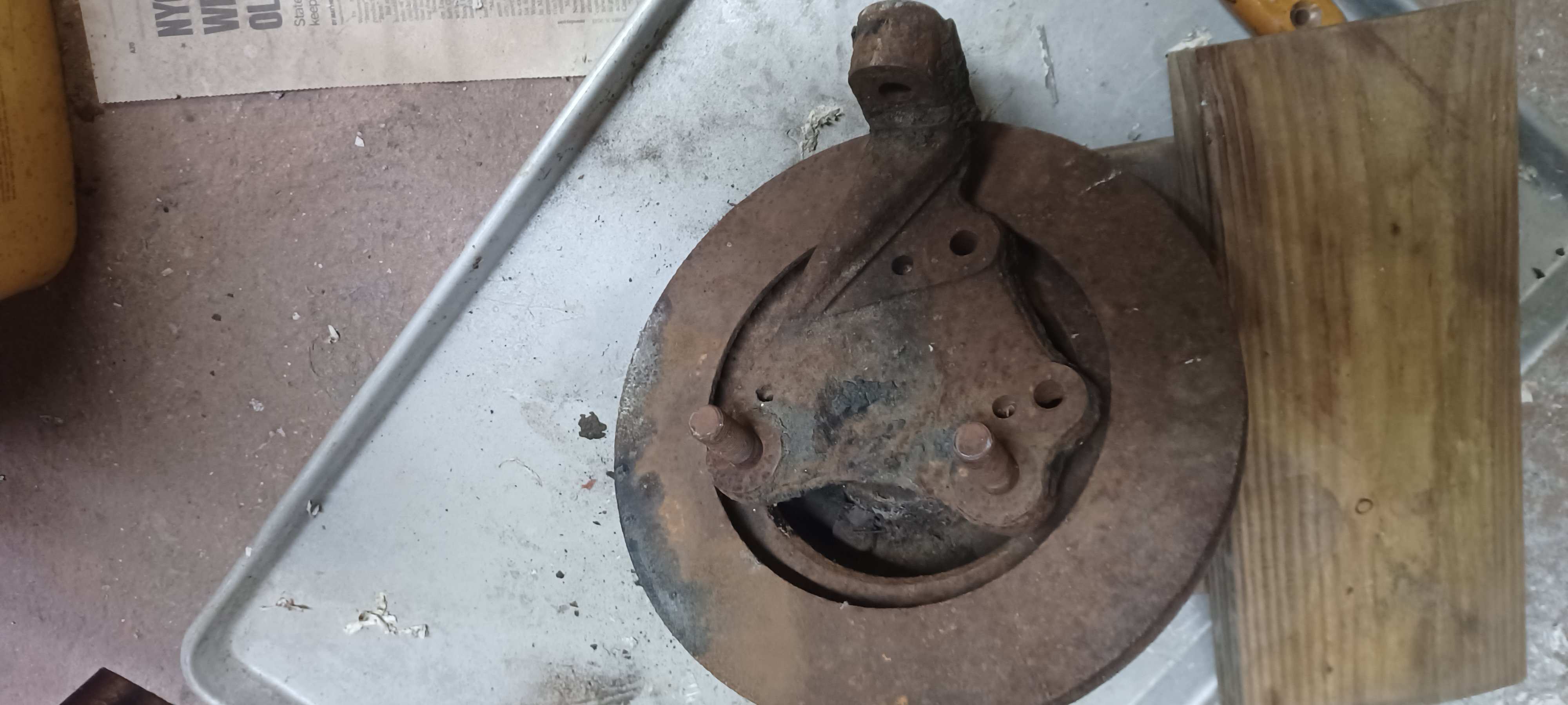

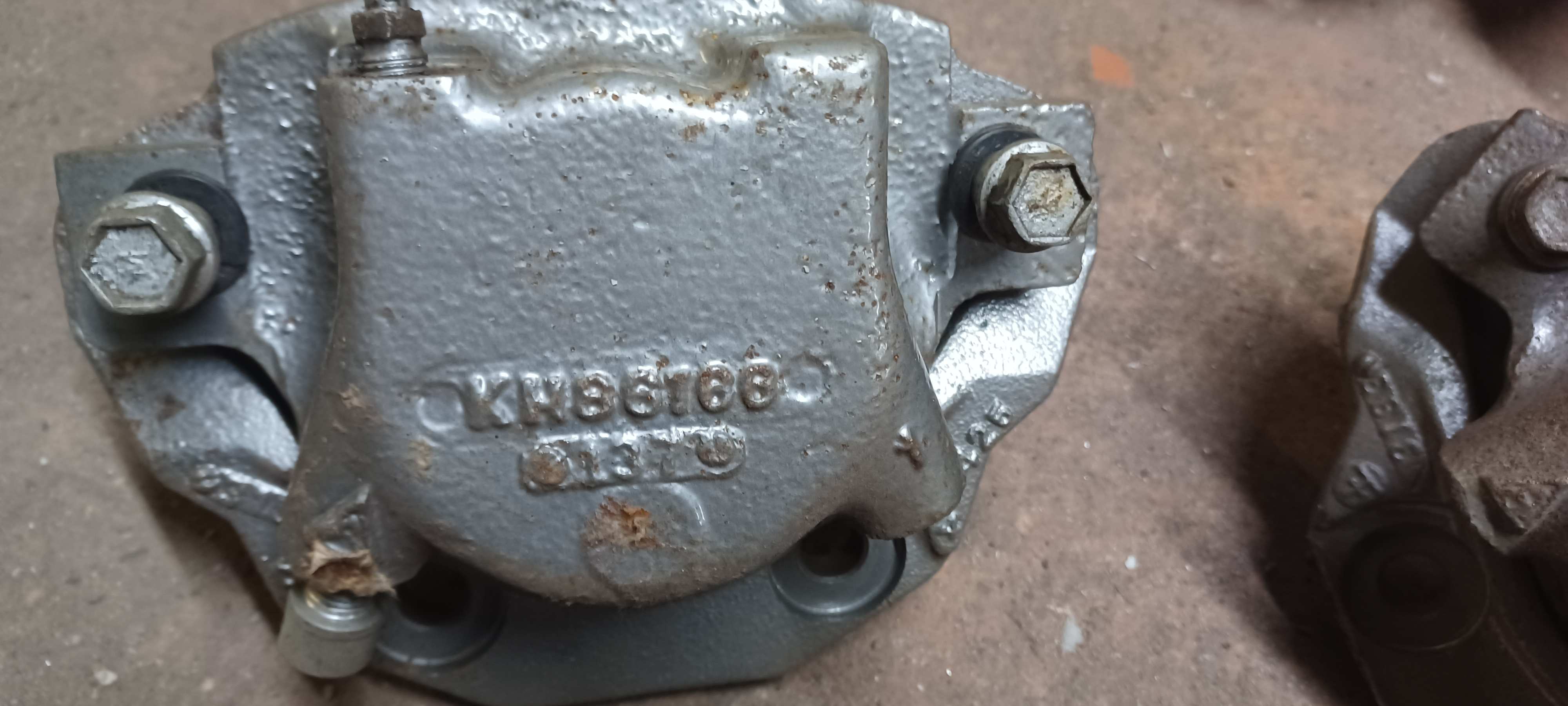

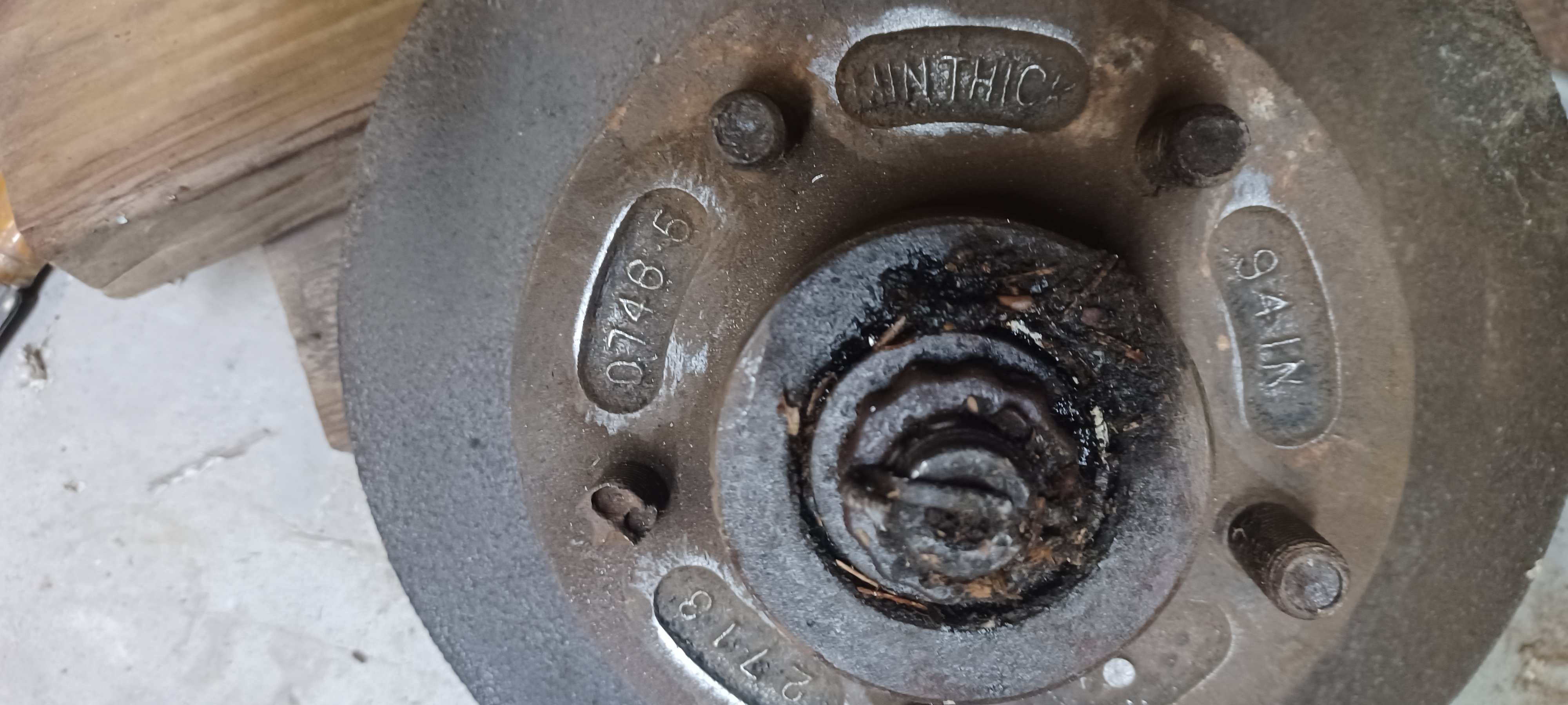

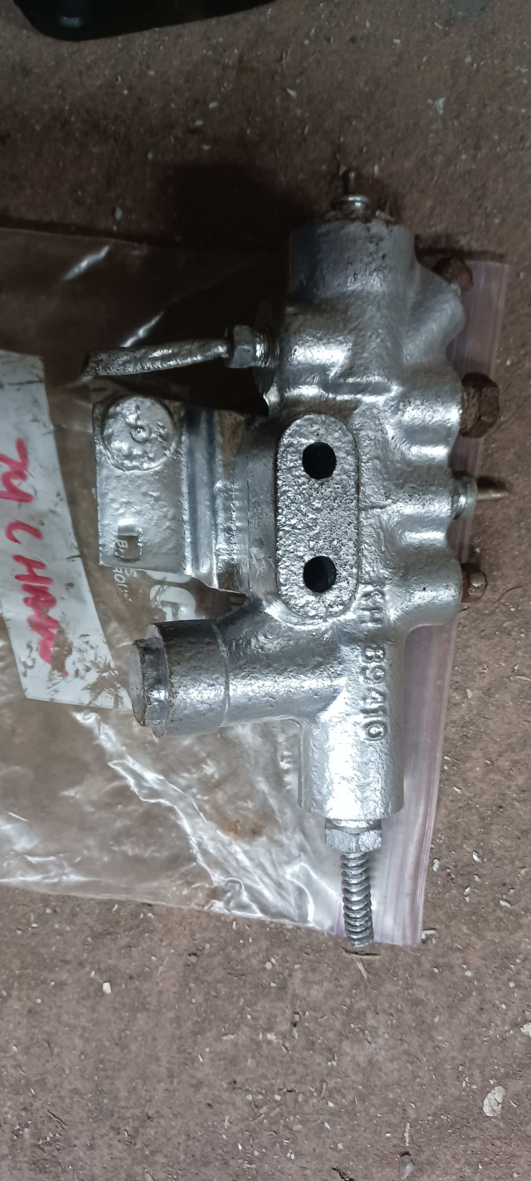

There should be no reason why not. Use all the brake components and correct valving. The only difference is the rotos from 72 and up have a larger inner bearing and spindle. Just watch what components from what year.https://www.forebodiesonly.com/forum/threads/70-71-collision-guide.30140/
