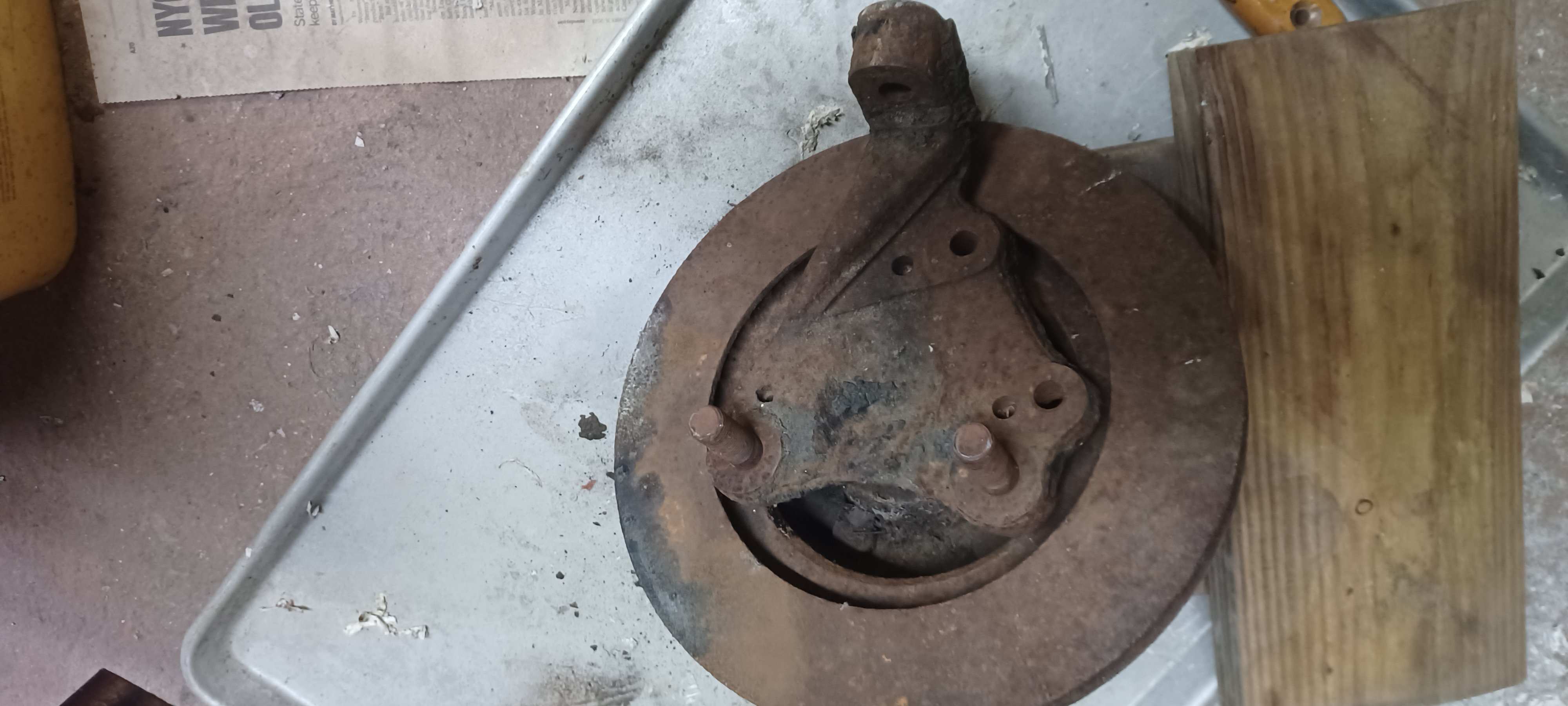

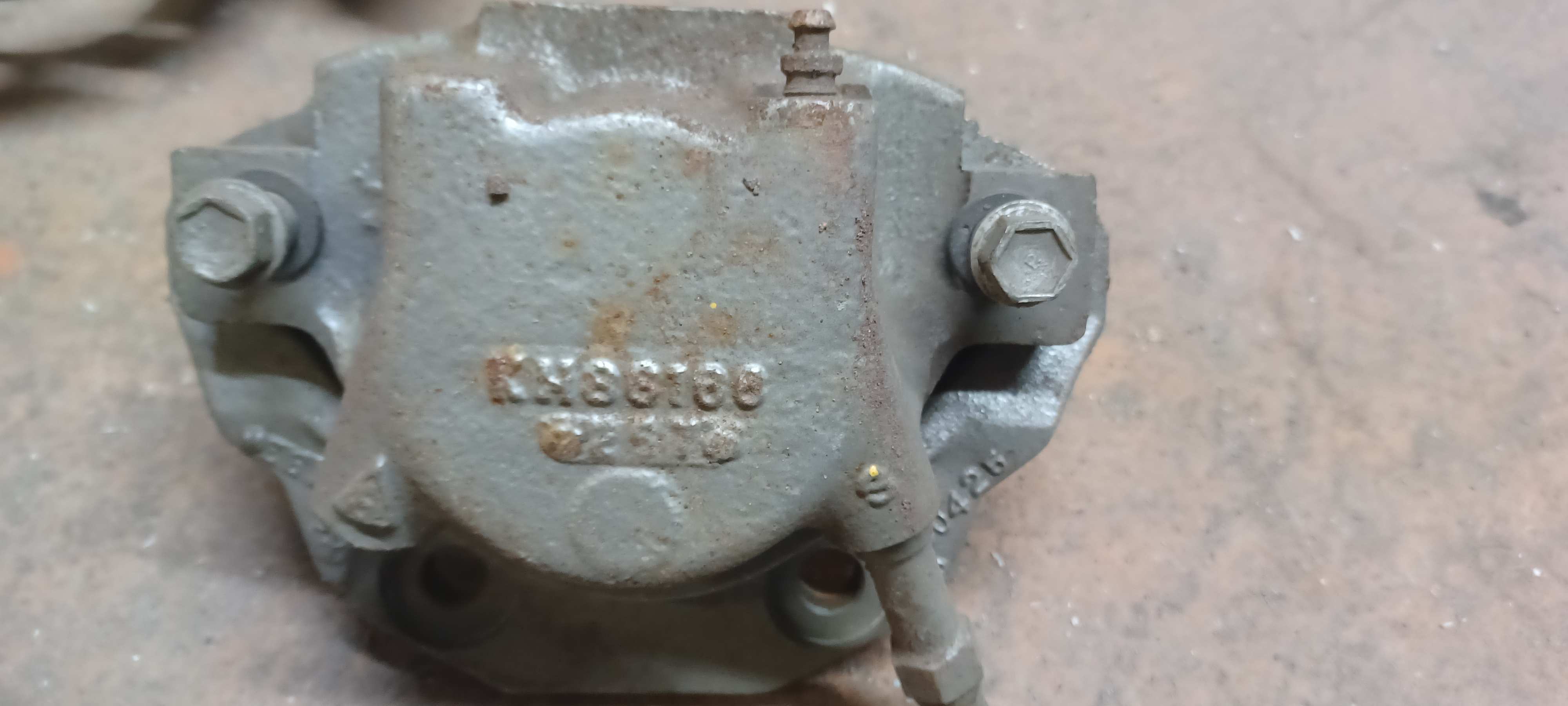

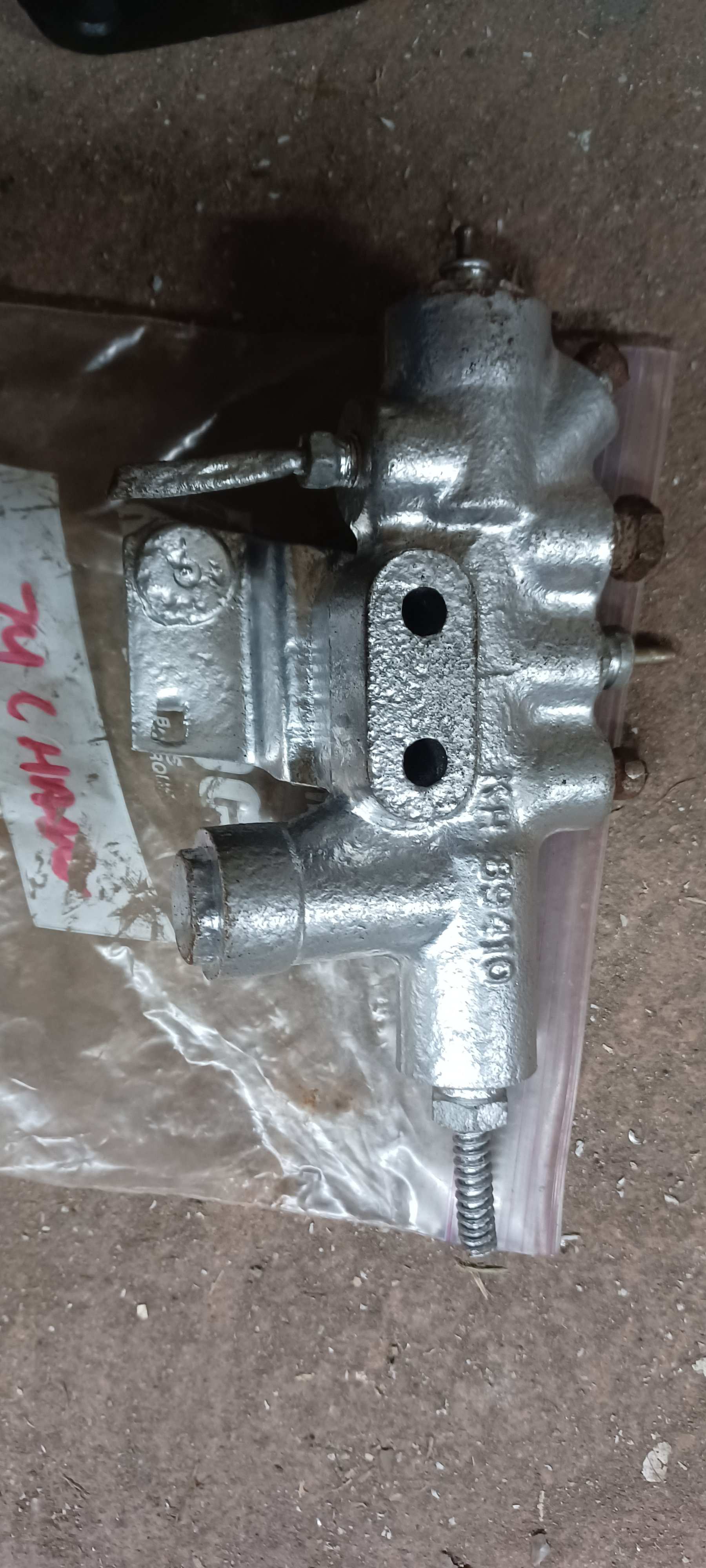

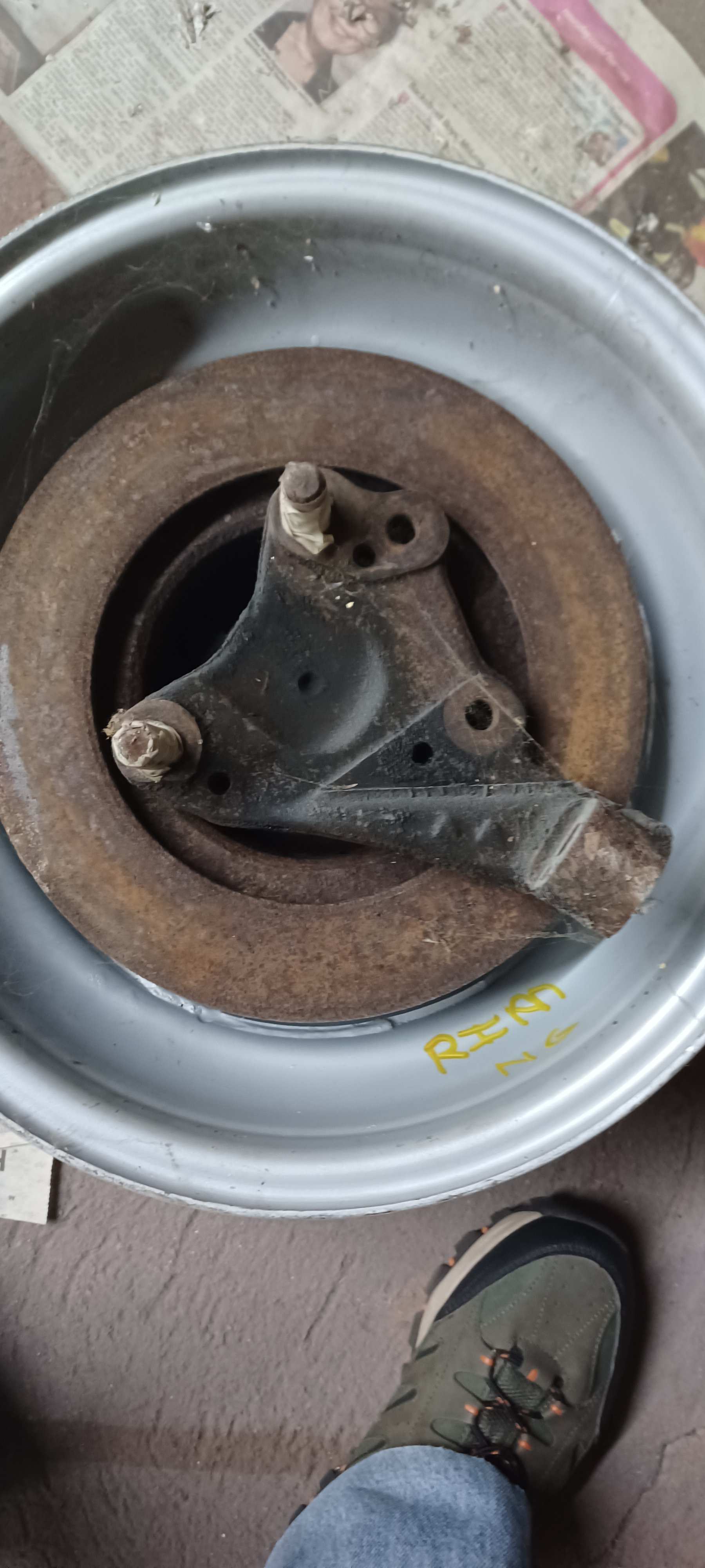

Disk brakes for 70 challenger w/ 14 in wheels
Challenger RTA
Oct 28, 2018
4,436
2,432
PA Flood city
There should be no reason why not. Use all the brake components and correct valving. The only difference is the rotos from 72 and up have a larger inner bearing and spindle. Just watch what components from what year.https://www.forebodiesonly.com/forum/threads/70-71-collision-guide.30140/
