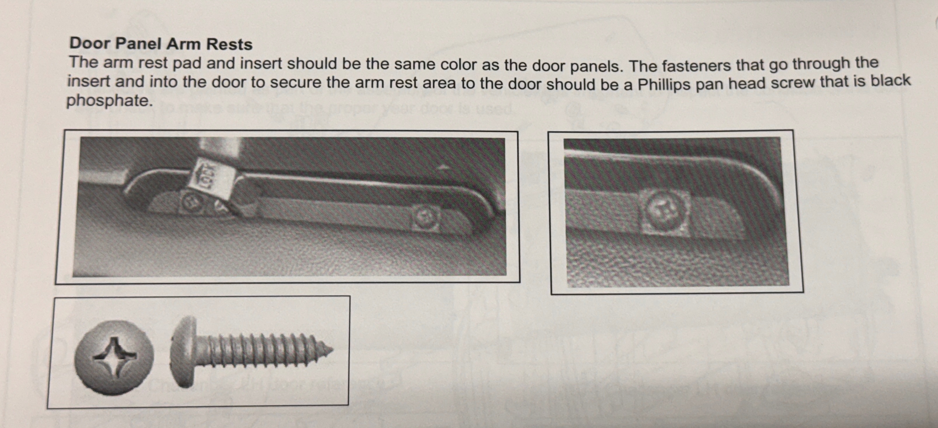

Monday at 8:19 PM #1 SFEbody Well-Known Member Joined Jan 31, 2016 Messages 1,210 Reaction score 507 Location Los Angeles CA. Anyone know the size of the 2 scews that go through the door pull to the interior door? They are a phillips head larger screw that screw into a U-nut on the interior of the door?
Tuesday at 9:16 AM #2 SFEbody Well-Known Member Joined Jan 31, 2016 Messages 1,210 Reaction score 507 Location Los Angeles CA. No one with any advice? That is a rarity... maybe everyone has Carlisle hangover! LOL
Tuesday at 12:24 PM #3 Xcudame Well-Known Member Joined May 27, 2023 Messages 3,144 Reaction score 2,444 Location Southeast Arizona If you're meaning the front armrest screws, they're #1/4-16x1.00" long Pan head Phillips. With a zinc finish.
Tuesday at 2:44 PM #4 Lunchbox Well-Known Member Joined Mar 28, 2023 Messages 191 Reaction score 75 Location USA For reference.
