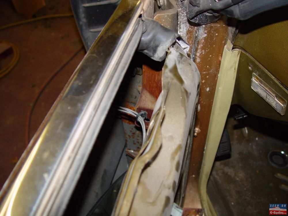

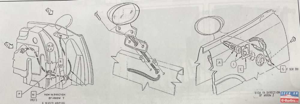

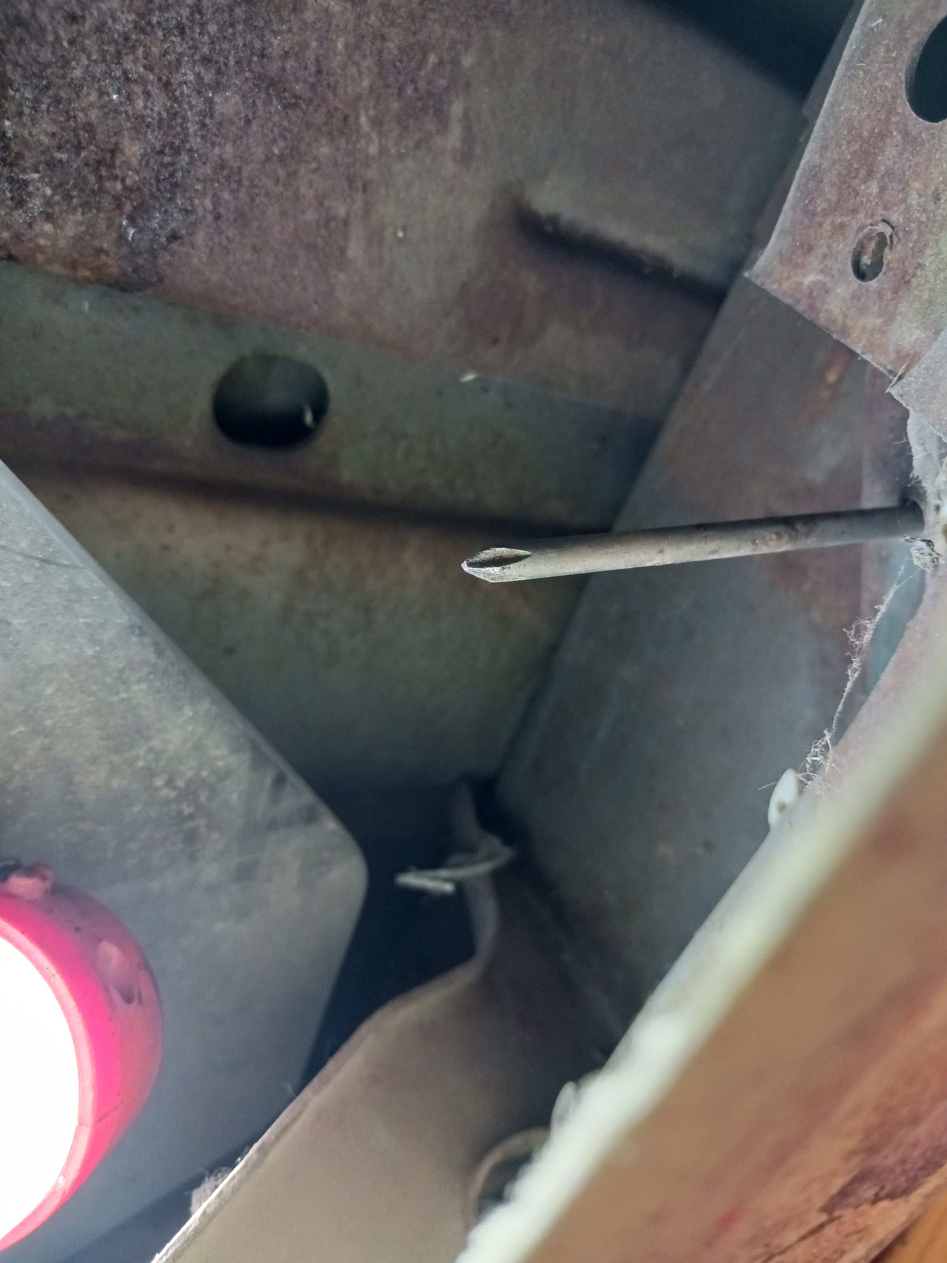

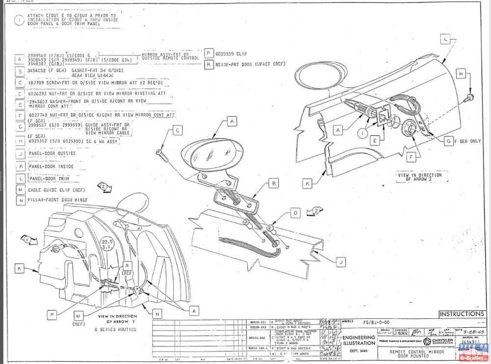

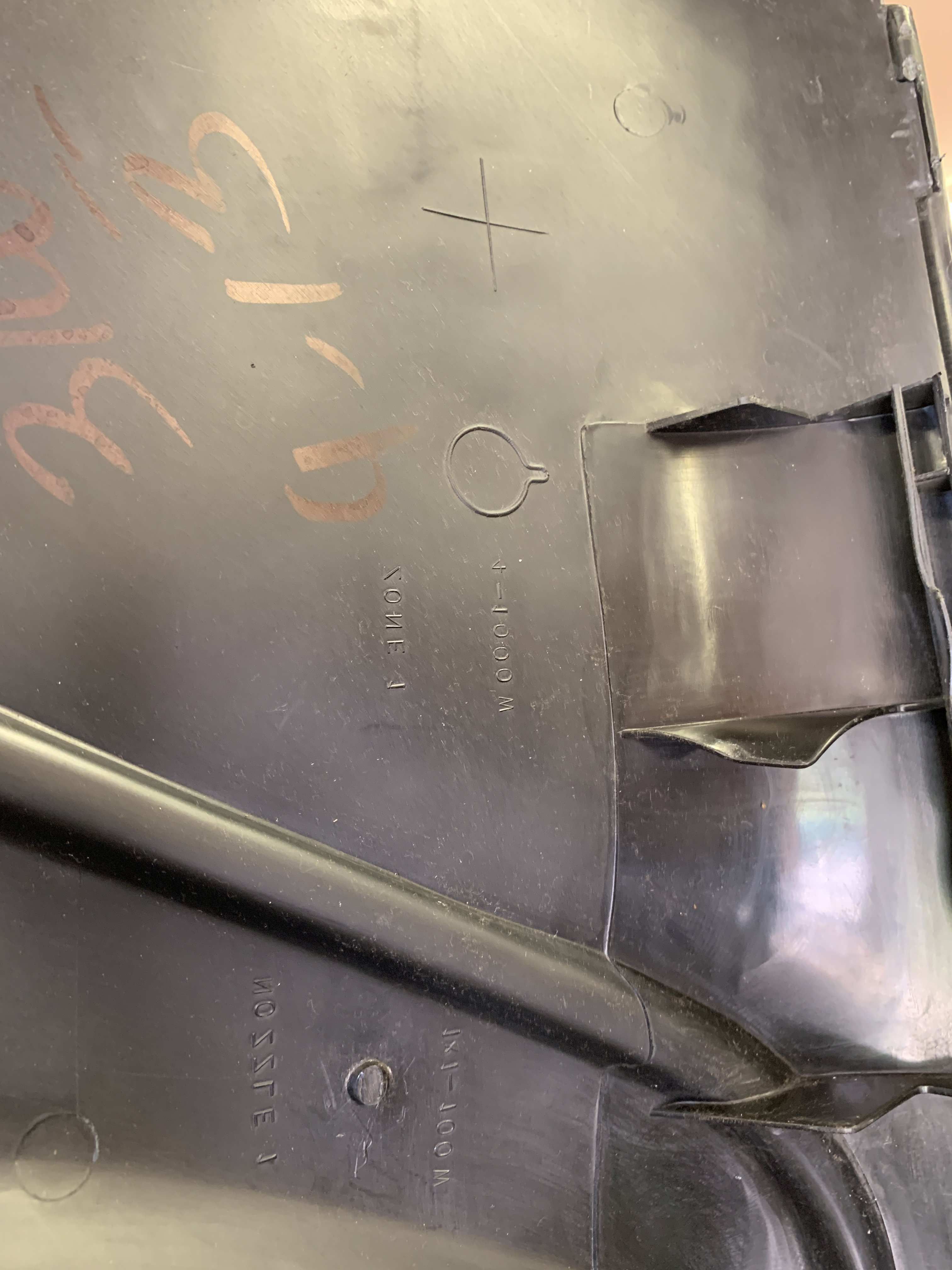

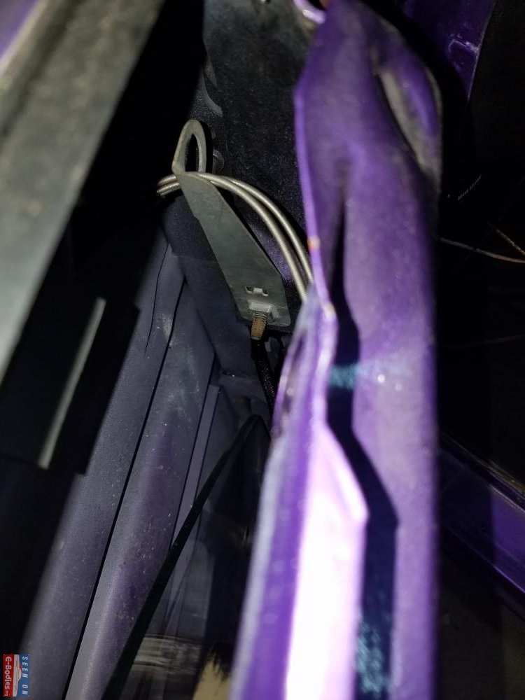

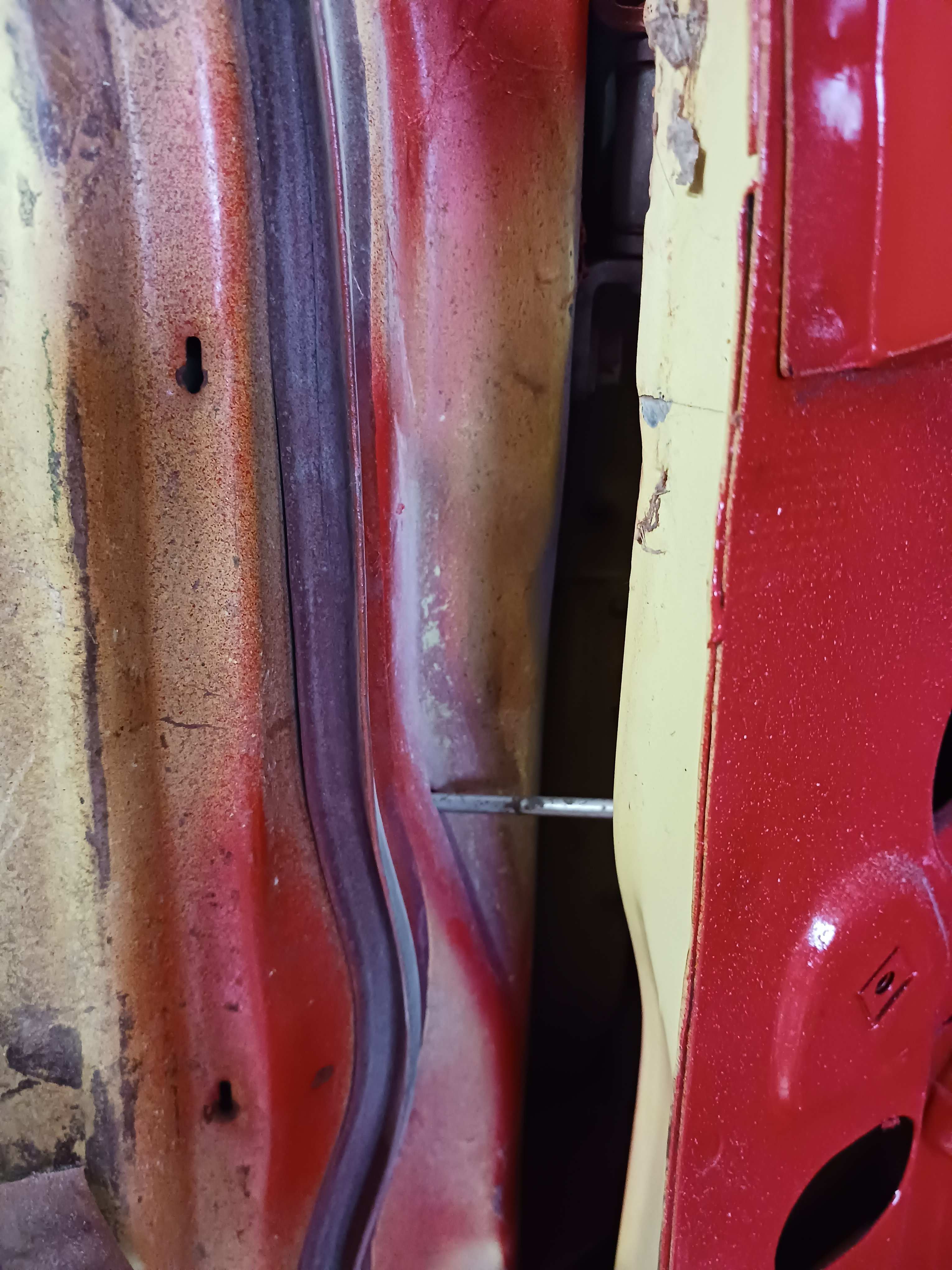

how is the cable routed. tried under window--nope---to the front side--nope. there is a small clip that goes somewhere to hold the cables in place--where??? Also need to have location for hole in door panel to mount the actuator
