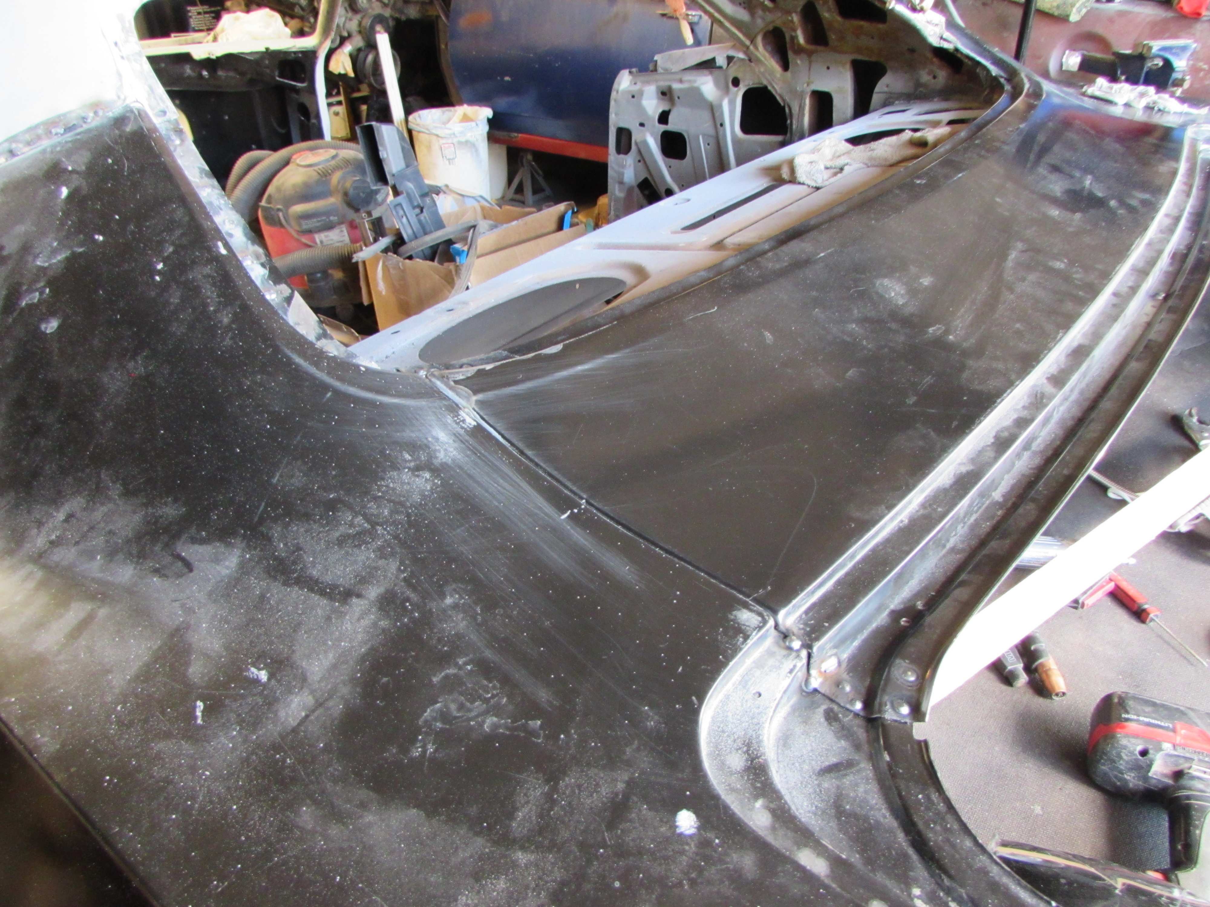

My dutchman panel set high relative to the quarter panel on the driver's side. I cut several slits in the flange on the dutchman panel. This allowed me to gently press down on the panel to make it flush and then welded it in. I welded the slits together as well. The pic is the final look.
