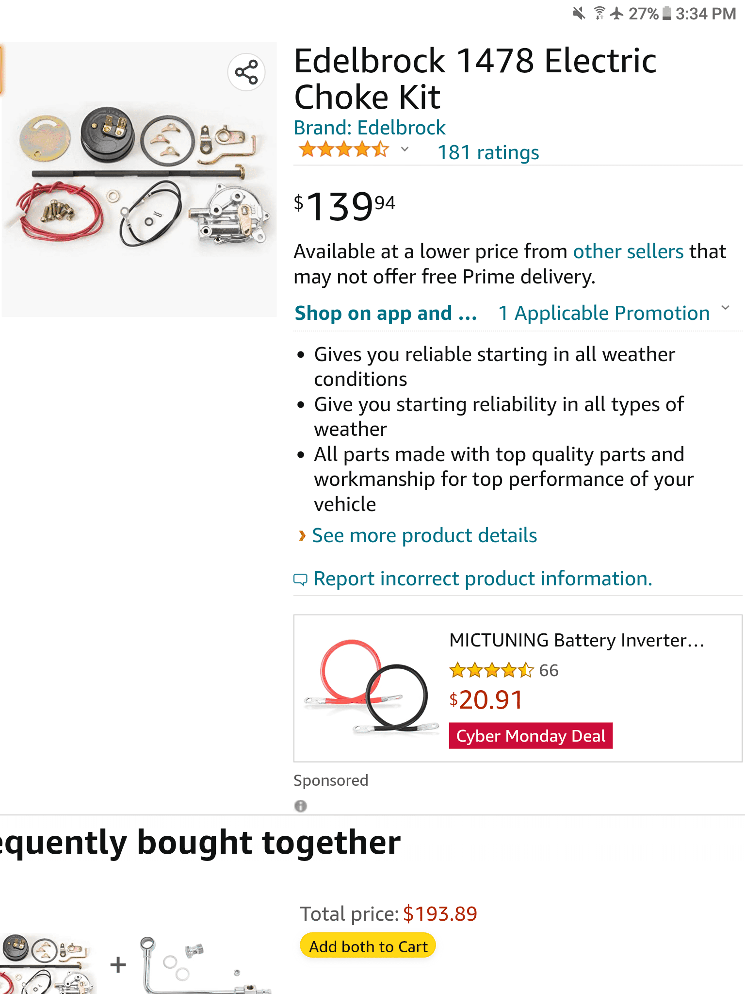

Will this Edelbrock 1478 choke kit fit my carb?

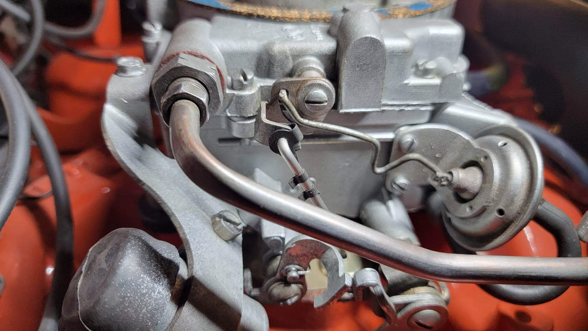

I have a Carter AVS 4933S carb on a 1970 'Cuda 340 with a divorced choke setup spring in the intake well that I'm not fond of. I want to convert it to an electric choke kit but can't find an exact reference kit for that carb. It looks like you remove the vacuum pull off and mount the metal choke housing using the screw holes where the vacuum device was mounted but I don't know if it would match up. Also, do you leave the electronic idle solenoid on or remove it as well?

No it will not fit your carb.
Easier to change the carb to one factory fitted with the electric choke.
