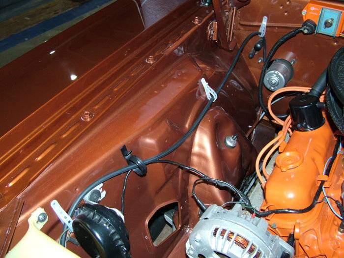

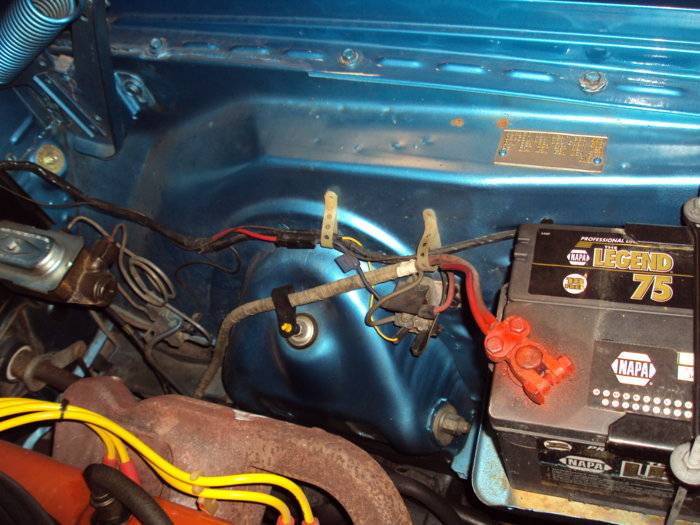

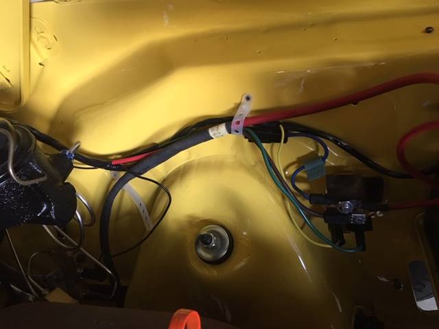

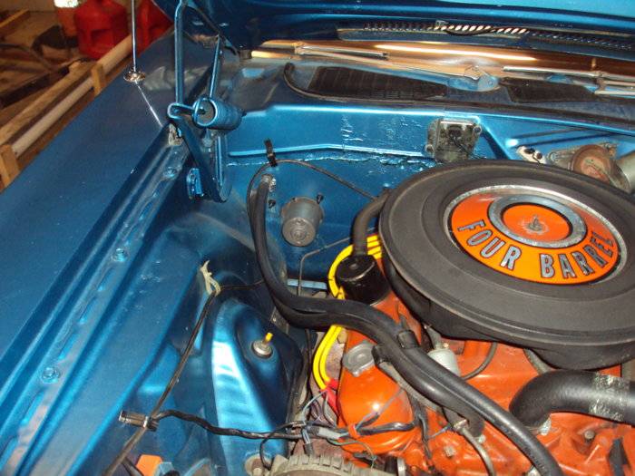

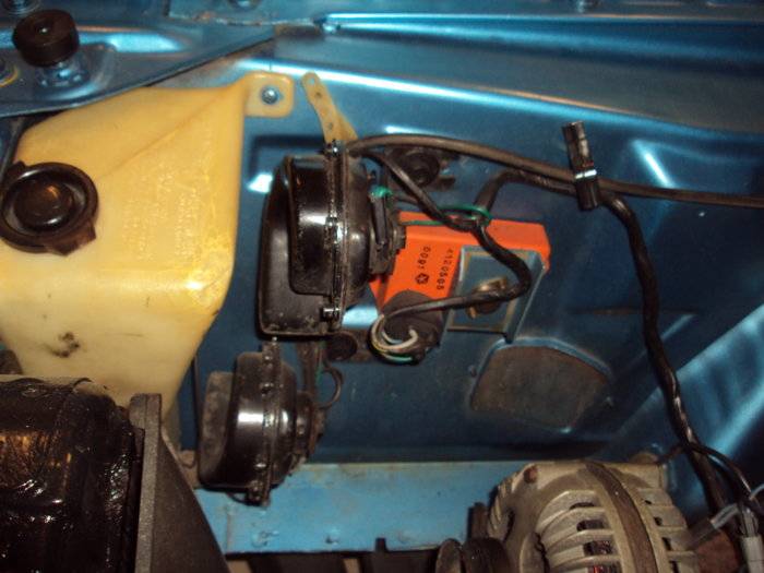

Jun 25, 2019 #1 doubleyellow Well-Known Member Joined Aug 3, 2015 Messages 363 Reaction score 97 Location Metro Detroit The 3 plastic staps that hold the wire harnesses on the left side......they the short or long straps? or different length's 's depending on location?
Jun 26, 2019 #3 M moparlee Well-Known Member Joined Jul 25, 2011 Messages 3,361 Reaction score 1,513 Location Mid Michigan The long ones, 9 hole x 5"lg. There is a special black one to fasten the positive battery cable to the shock stud.
