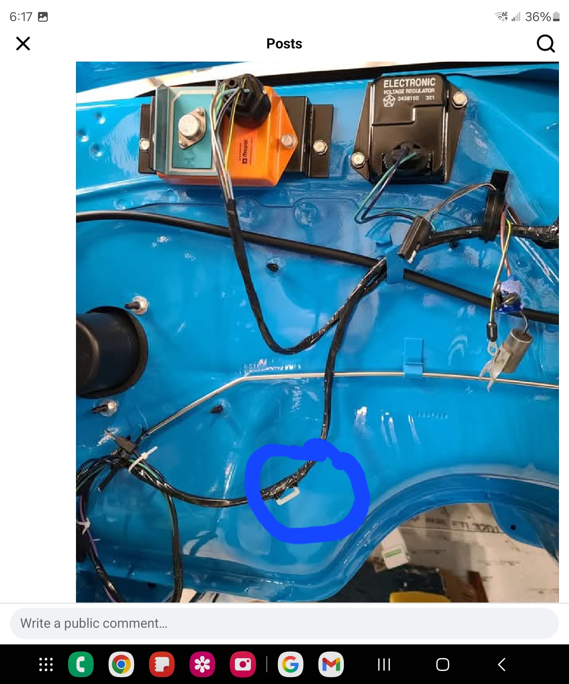

The question is for the part of the wiring harness for the engine that runs along the valve cover in this picture.Where does this white piece fasten too that I circle in the pic. that's attached to the wire that runs along the valve cover on the passenger side.

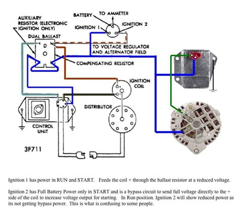

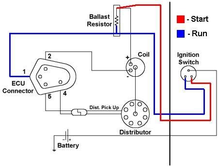

I went back and circled the part.I'm talking about sorry for their confusion.Thank you for the diagrams.
