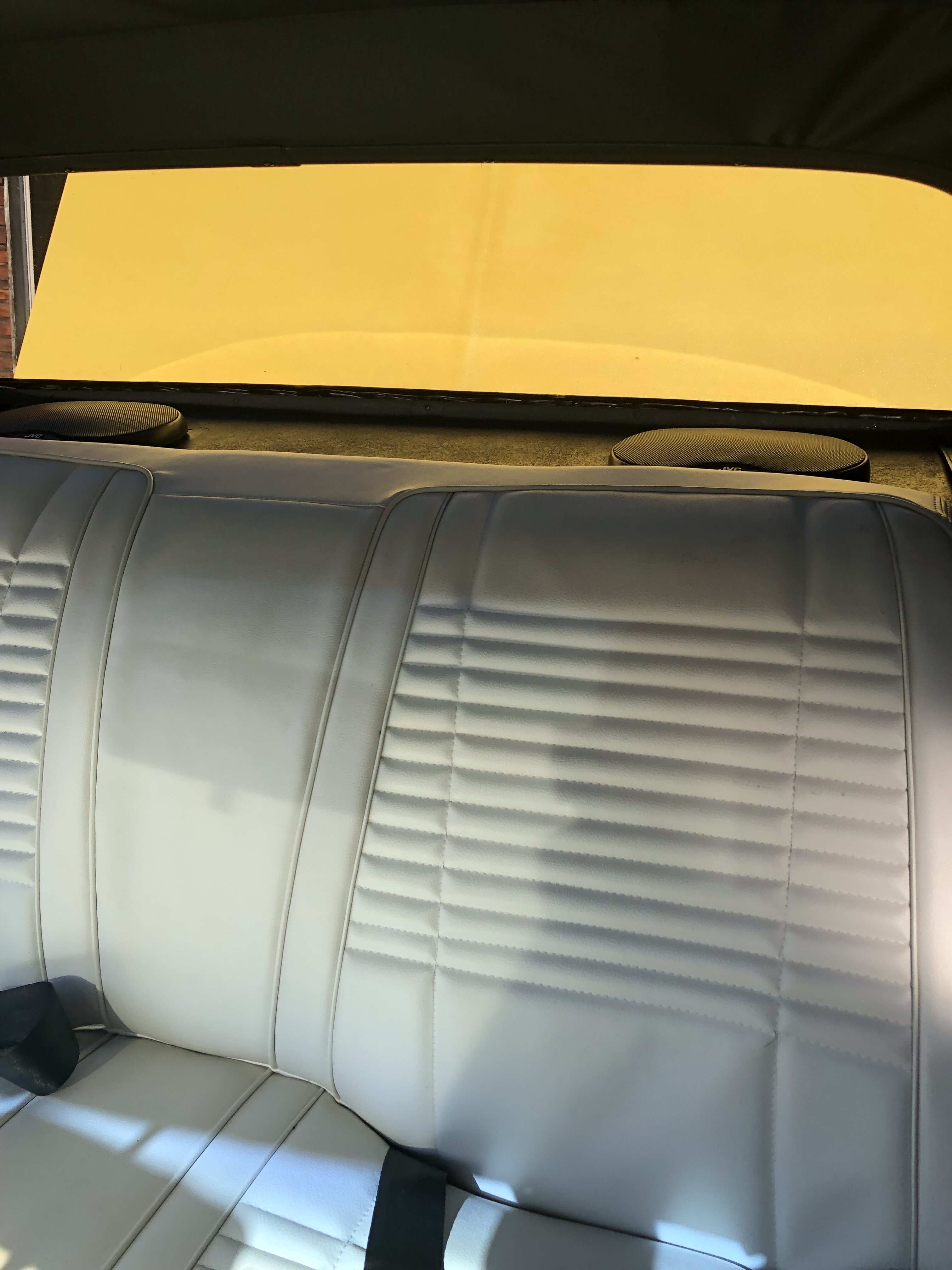

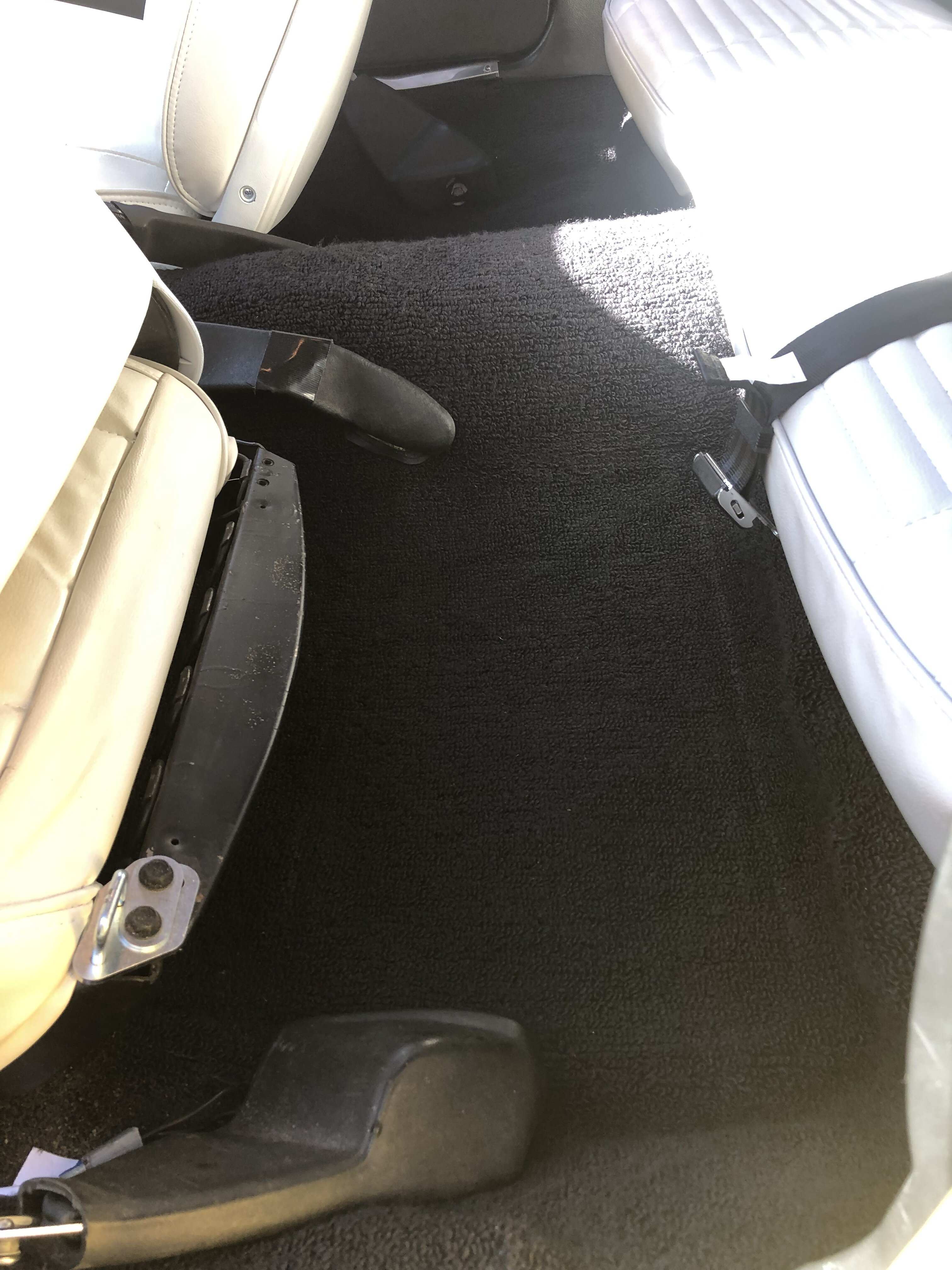

If I missed something let me know. Will be years of enjoyment now. Like a new car of the assembly line. Safe Cruising all
Thanks again

Not trying to criticize, but in your pic of the rear footwell behind the driver's seat I noticed that bottom seat cover was not installed correctly. It should cover that rear section of the seat frame where your latch hook is bolted. This is probably why your bottom seat covers appear a bit loose. You might want to try removing the hog rings and reinstalliing the bottom covers so that they go over that frame. However, not sure what effect it would have on the location of the holes you cut on the sides of the covers for bolting the seat back to the seat bottom frame.

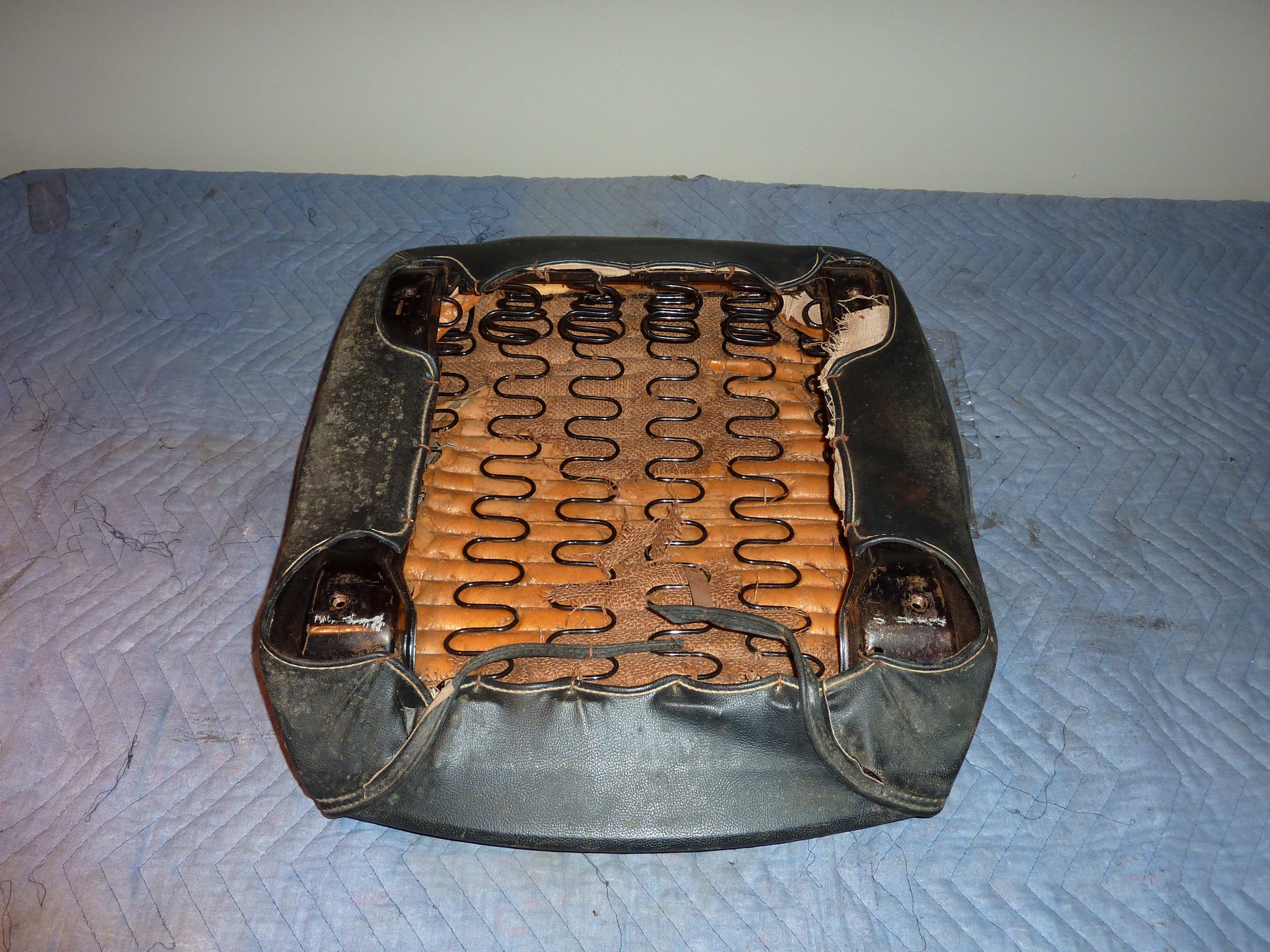

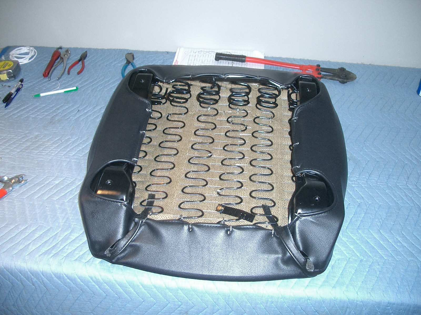

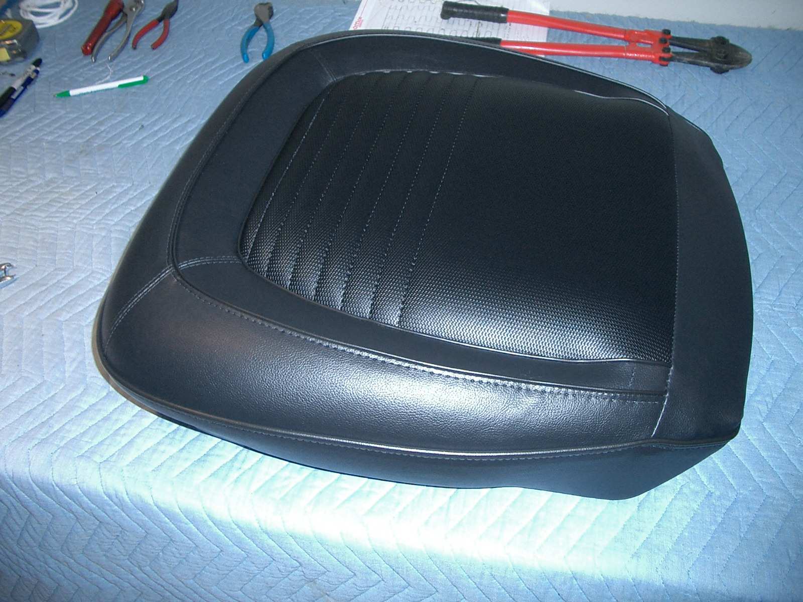

Here are a couple of pics showing how the bottom seat cover should be installed over the rear of the frame.

Had them professionally done 18 years ago. They have been wrapped in plastic all this time. I won't have know the difference if you won't have pointed that out. I will have to leave them like they are for now. Something to look at next year as I will be parking & covering up for the year soon. Thanks for pointing that out thou
