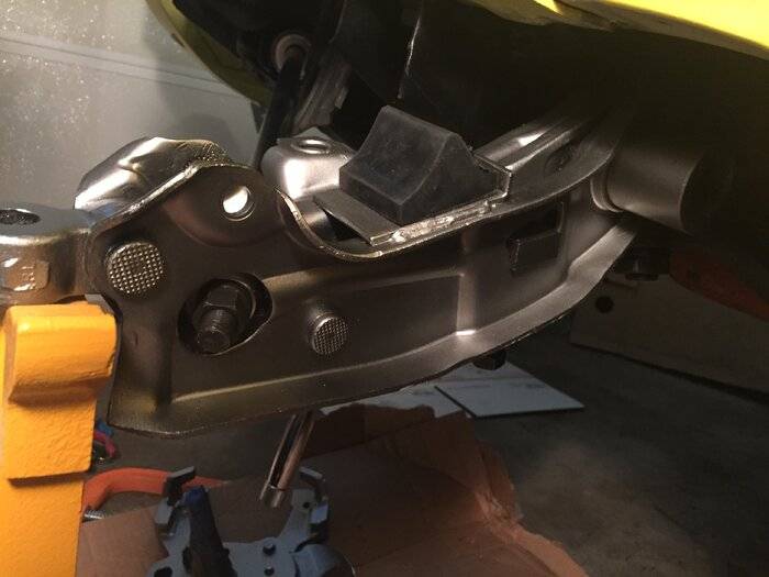

I cleaned up my original LCA's, epoxy primed them, and sprayed with high heat silver paint.
