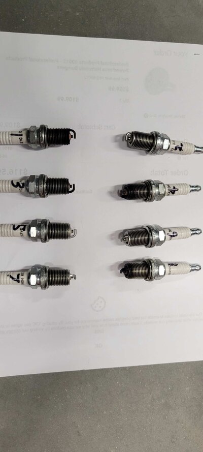

Pulled the plugs and noticed that 1,8,4,3 where tan-ish. Plugs 6,5,7,2 were clean as a whistle. Same goes for the exhaust ports and tops of pistons. Thought the carb primary on one side of the dual plane intake was set bad and caused this, but that's not how the ports are separated. Then I realized that this difference is on the 180 degree rotation of the firing order, not the other. Any ideas on what is causing this?
My thought was distributor or distributor cap. The odds of the plugs or plug wires being bad in coincidence with the firing order as noted is astronomical, IMO. The distributor is an original and not updated, yet. The cap, rotor, wires, and plugs were all brand new. New distributor from Summit is on it's way!

A picture of the plugs would show the condition better then your explanation. Might be the distributor is wore. just a guess. Was there white corrasion inside the cap? Do you have a tac, was it acting erratic.

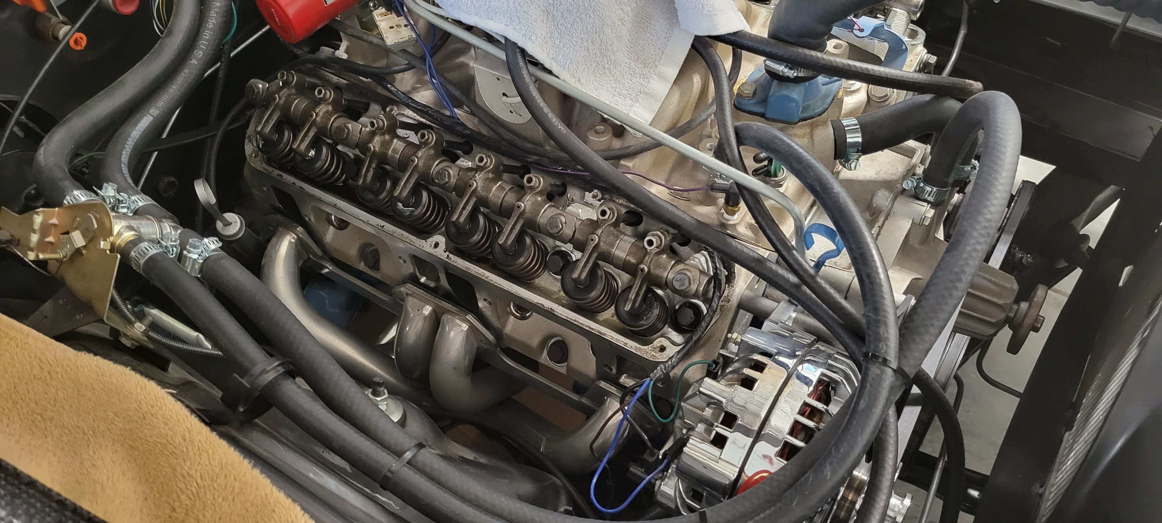

I agree with Challenger RTA, would be interesting to see pics of your plugs. How did you inspect the exhaust ports and tops of the pistons?

I dropped the headers, so I could look at the exhaust ports. Four were charcoal in color in the cylinders noted and the other four were clean as before start up. I could shine a flashlight into the spark plug hole so see the top of the pistons. Here are the plugs and exhaust ports. Plugs.jpgRockers.jpg
