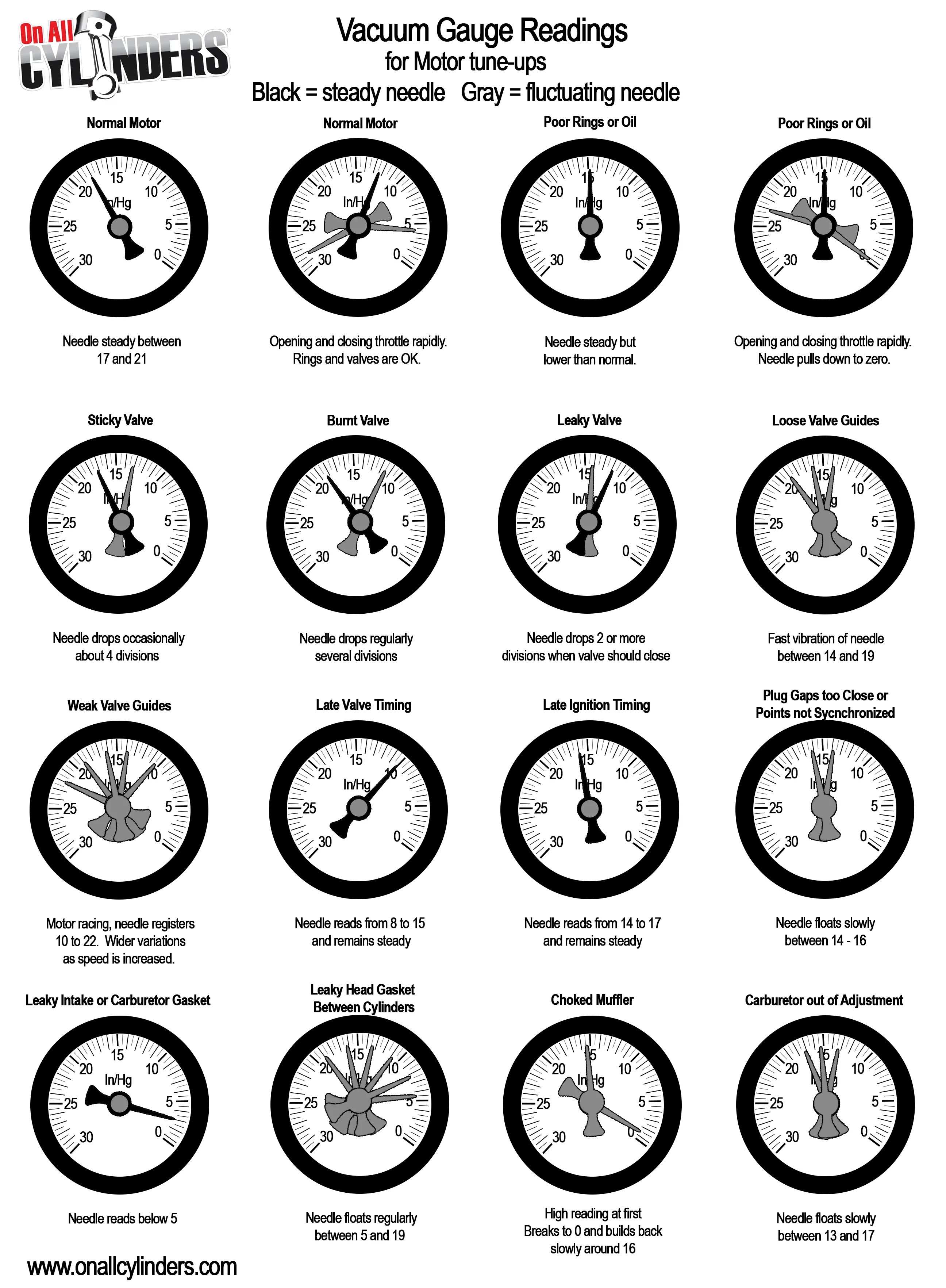

I was concerned about timing chain, vacuum reading is around 8 at idle. no matter where I set timing or adjust fuel mixture I can't get it over 8-9. I haven't done a leak down test... i have no idea how to do this.

Just going by what I heard, it sounds like it has been over cammed and your response of 8-9 inches of vacuum supports this. Leak down test and compression test will definitely help diagnose the problem. Depending on what camshaft is in there, the mechanical advance most likely needs adjusting. When people unplug the vacuum advance, it's usually because the distributor hasn't been modified to work with the high lift high duration camshaft. No vacuum advance helps the problem, but if it's driven a lot on the street (is that your intention?) you're wasting fuel mileage and causing pre-mature engine wear. If you wind up getting into the timing chain, I'd go ahead and remove the intake and carbs and try and determine the camshaft lobe lifts are.

Your vacuum at idle seems pretty low to me, but then, with longer duration cams, this is a common side effect. A smallish vacuum leak might effect the surging and stumble you're seeing when driving. There are several ways to test for vacuum leaks, and some methods are pretty easy.
