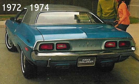

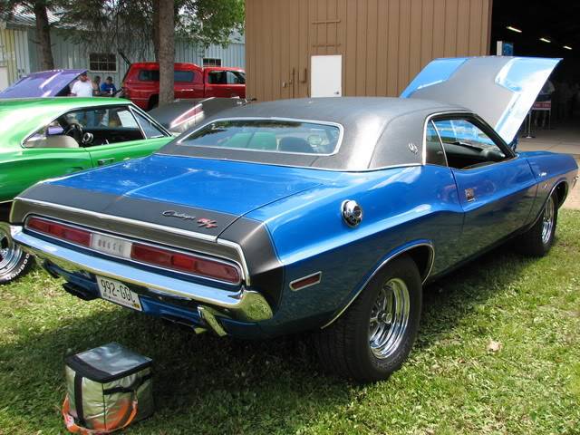

That's a '70 grill and I think those are '70 side marker lights. What do your tail lights look like? You just may have a '70 Challenger there.

the back end has the 4 individual lights. its weird cause the rear blinkers say 73 but the fronts are stamped 1970. i think this may have been modified. i wonder if i can put the 74 grill & fenders back on without alot of work or if i should leave it as a chop.

After looking at your pictures again, it looks like you've got a '70 front fenders and grill and the rest is a '74. Your front side marker is from a '70 and the rear side marker is a '72-'74. Personally, I prefer the '70 grill and would leave it that way, but it's your car.
