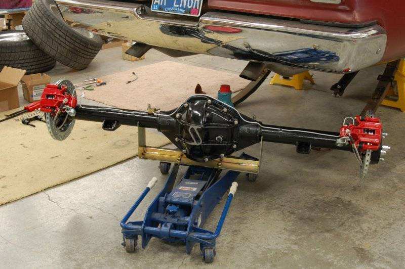

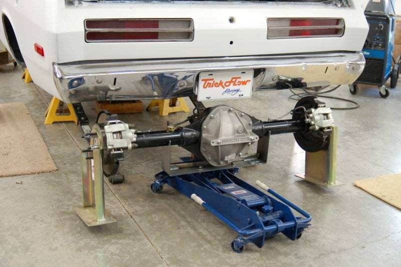

Another member on another forum made these.

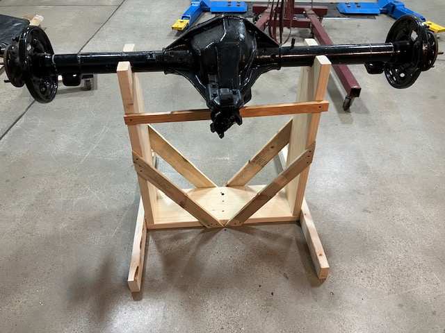

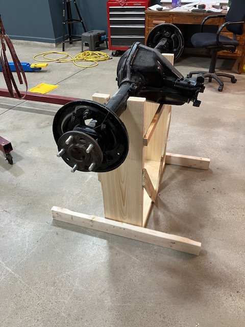

I did some tinkering in my shop and here is what I came up with. It's very stable and easy to work on. For installing on the car, I will put some cheap furniture moving skates under it to slide under the car and for final positioning. I will hang it from my engine hoist to paint though. Total cost wast $10, plus some stuff I had around the shop.
