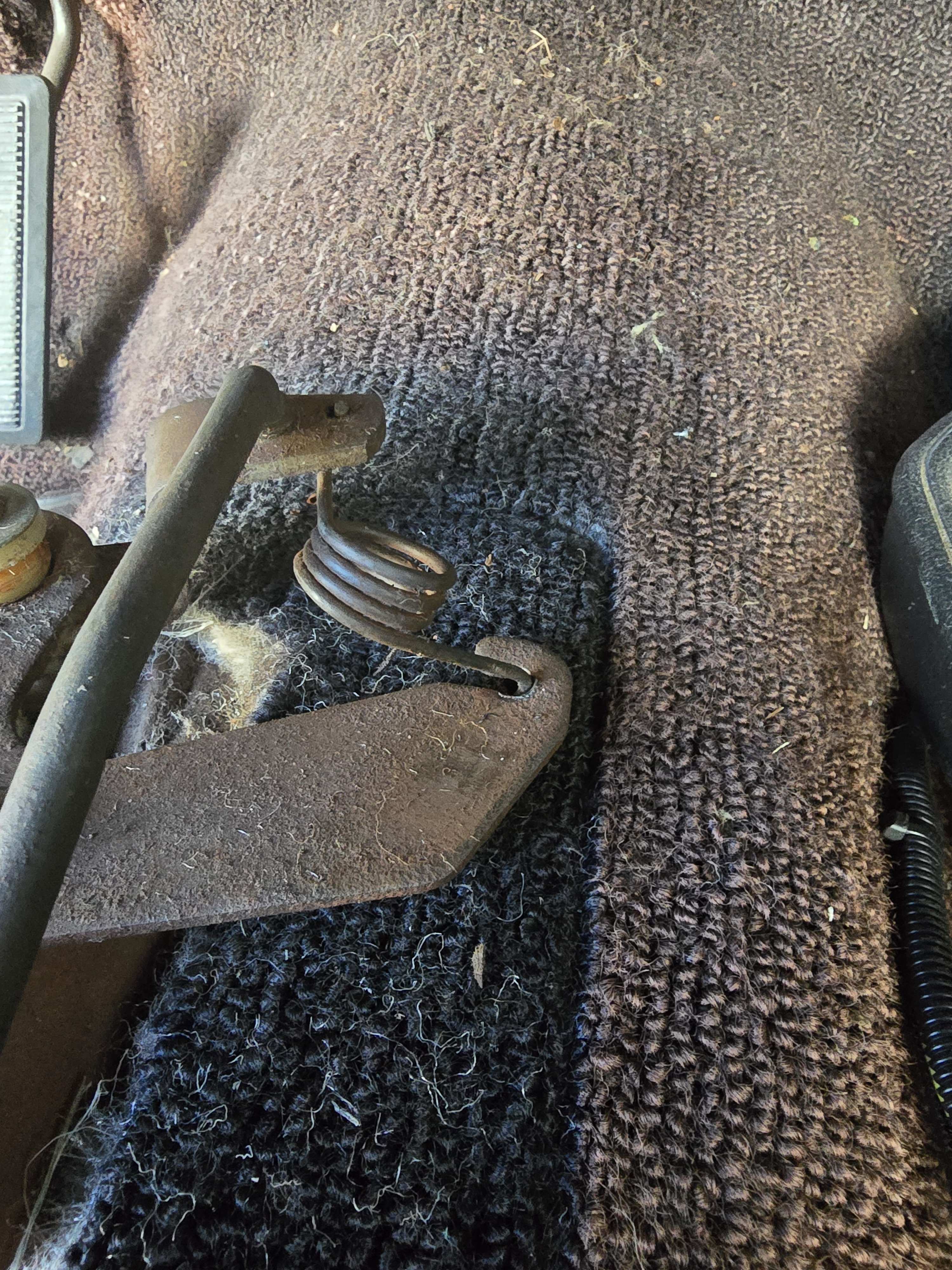

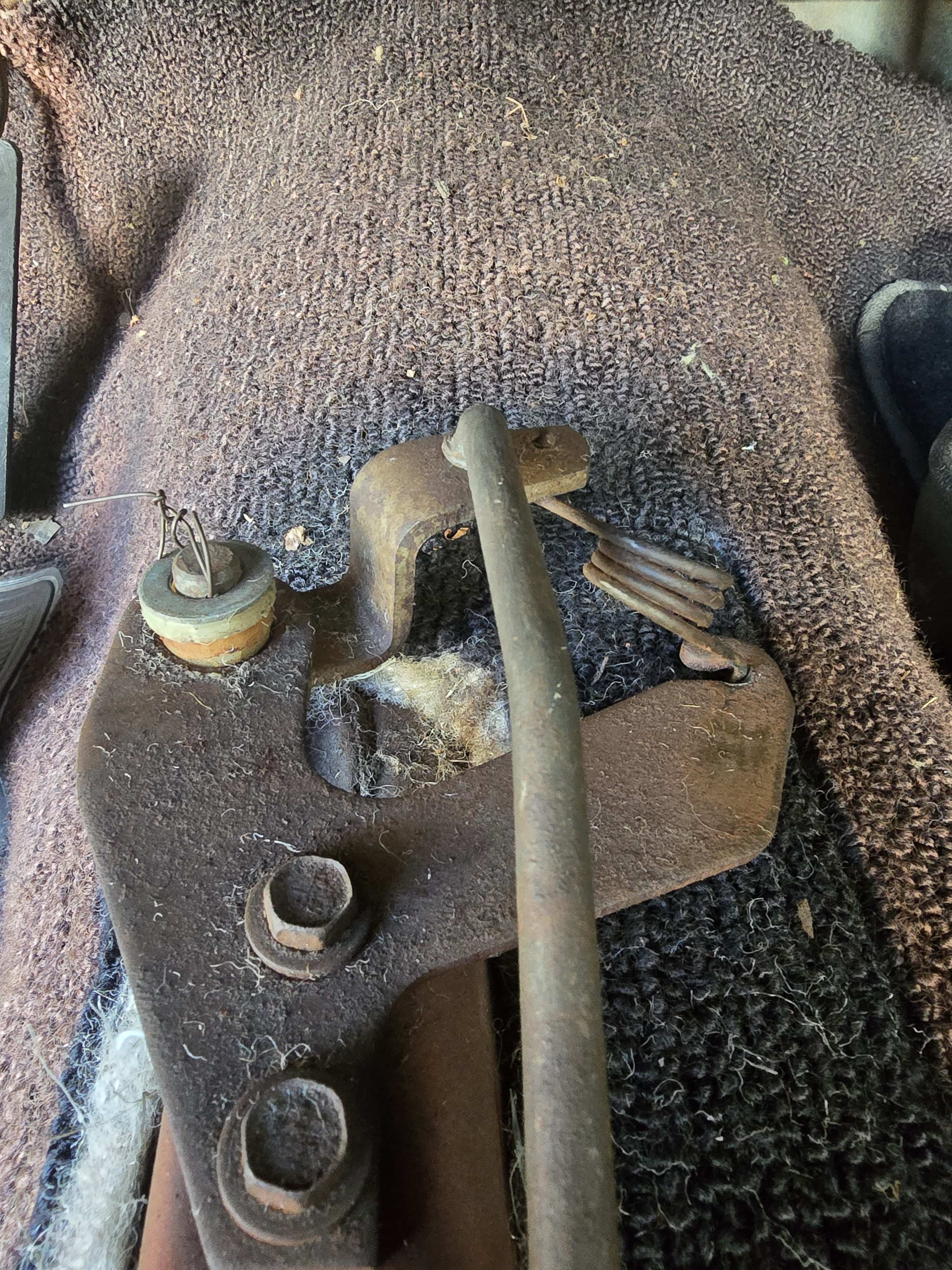

I just removed the carpet and I was looking at the spring on the shifter. Is this spring installed correctly? It looks a little odd. Also, does the plastic bushing look like its installed correctly. It's secured with a piece of wire. I looked at a couple of diagrams and I couldn't tell the orientation of the spring. The shifter seems a little loose. Thanks

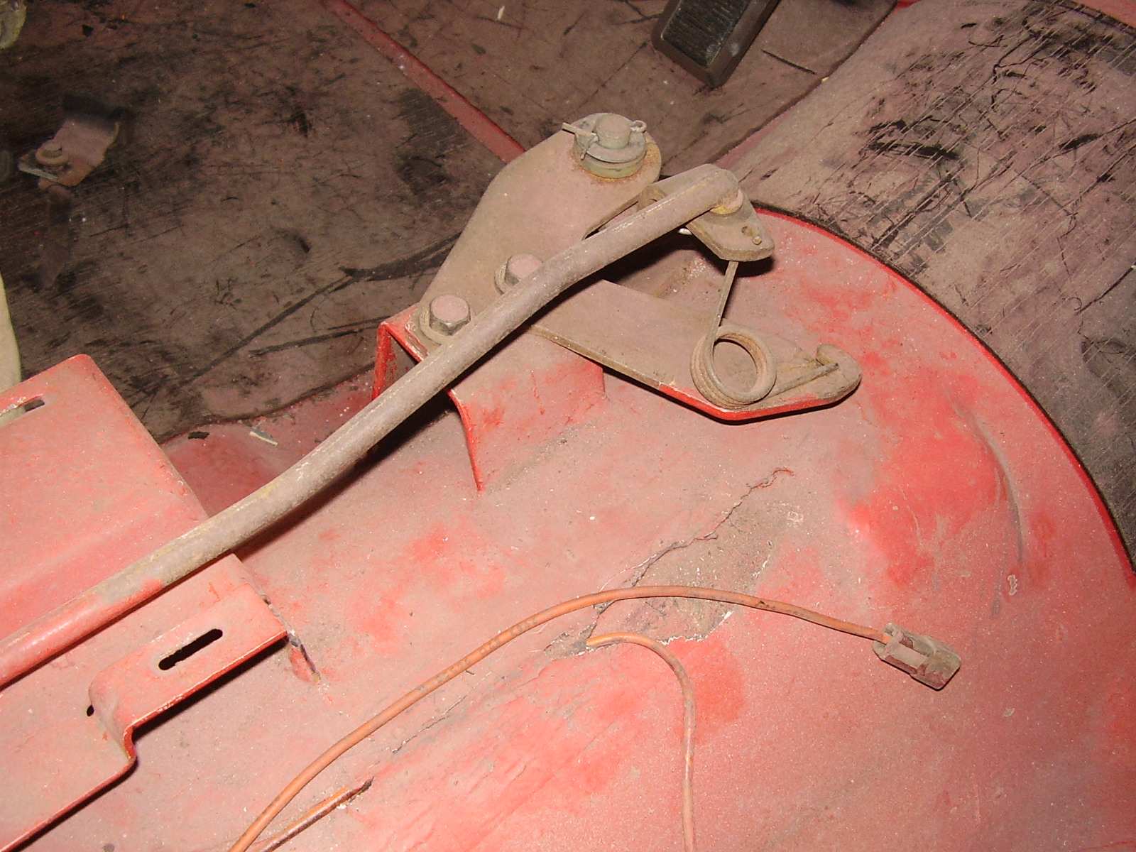

It should look more like this but it appears to be installed correctly.

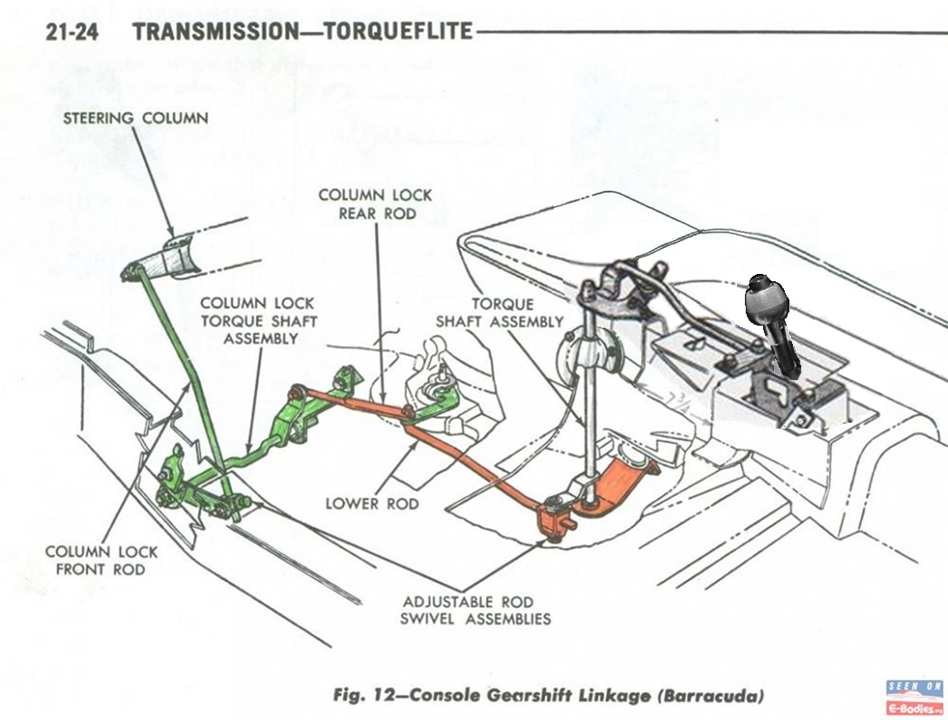

Does it work properly? Most issues are with the adjustment for each position's detent. That adjustment is at the transmission lever linkage and uses a rod swivel with a bolt.

Flat washer and cotter pin to seat the bushing, I Don't know about the spring...I lost mine.
