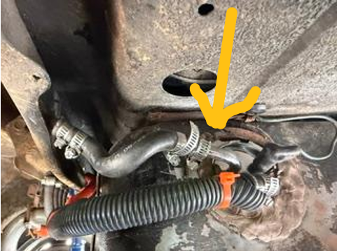

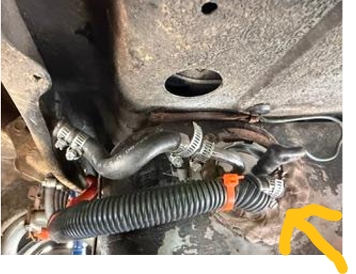

1. Vapor Hose at Charcoal Canister, and the Vapor Port at Tank Collector, below:

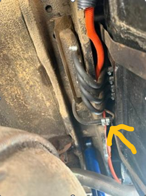

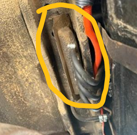

2. Fuel Return line from Filter to Sender:
3. Fuel Line from Pump to Tank Sender. Please note that the bent rubber hose was replaced with a straight 3/8" piece.
With my son's help, we confirmed that each of the three lines held pressure with no leaks.

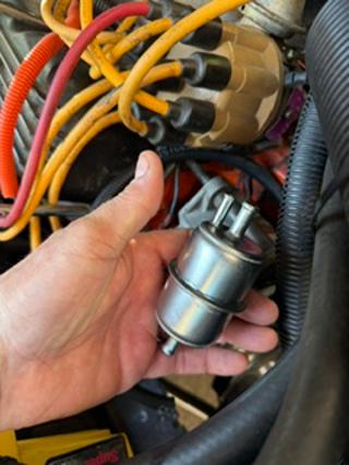

New Fuel pump and filter:My next
After all of this, the pump is unable to draw fuel from the tank. I tried priming the fuel hose between the 4160 and the new pump, but the engine only used that up.

This leaves the tank. The sending unit is stainless steel, and not that old. The tank does not leak, but I suspect there is a vacuum issue at play somewhere. It has a metal locking vented cap made by stant. I have removed this during my attempted tank flushing, and it did not help.
I suspect that the issue has something to do with the vapor collector, but I am not sure what that could be. I have discovered that these are surprisingly unobtainable, yet gas tanks are still made with four vapor ports to attach to them??

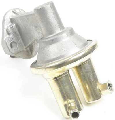

Did you check the length of the fuel pump pushrod?
Yes, thank you. The pushrod is 3.16 inches, within tolerance. Like the pump, I contemplated getting another, but have read aftermarket pieces have issues. I ran a test last night using an external electric pump, and it struggled mightily to get a tiny amount of the 8 gallons in the tank out. So I think there is something in the tank.

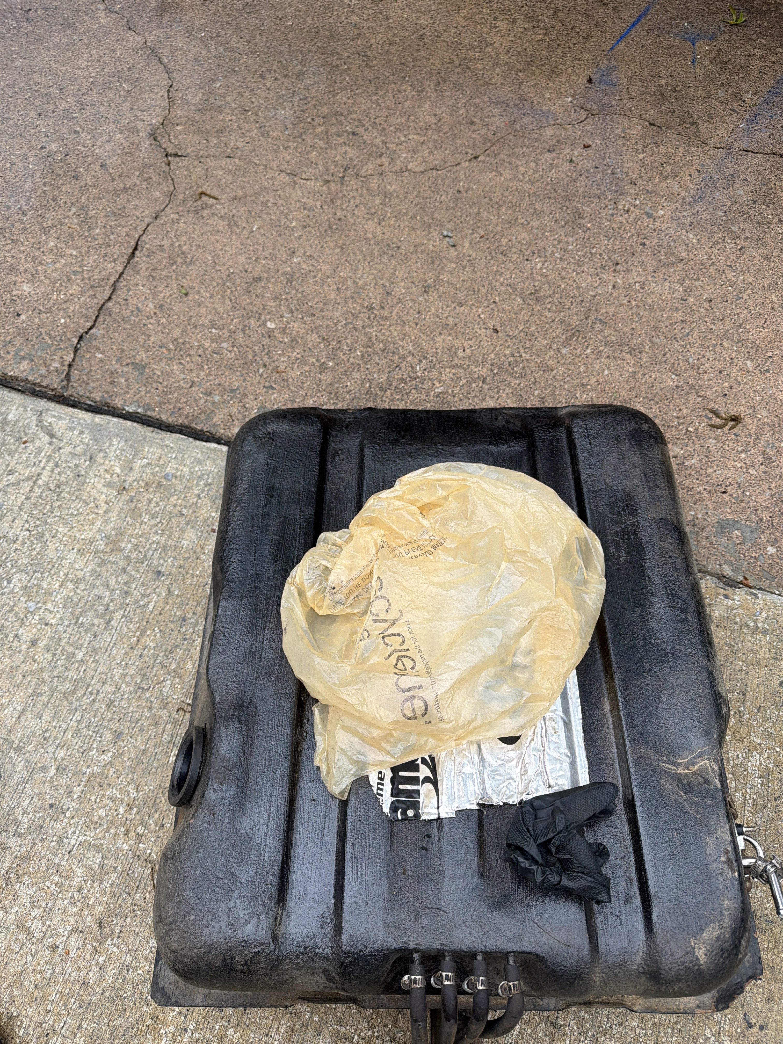

Yes, thank you. I ran a test last night, and it is really looking like a tank issue. Another post suggested that the lining may have degraded to block the sock, and that makes a lot of sense.
This tank has been a tremendous consumer of time and comprehensive source of aggravation(Edit: forgot to mention that I have also experienced the woosh of vapor lock)...I should have S-canned it years ago instead of having it relined...Oh well. Any thoughts or experiences with Spectra, Tanks, Inc. or Holley tanks?

It happens! I had a Harley gas tank years ago that had been coated inside and the liner started coming loose and clogging my fuel petcock. That kind of soured me on fuel tank coatings.
I didn't think about
That that is what happened here makes total sense...there is really nothing else to account for the type of blockage I am experiencing, unless the coating flaked off AND rusted underneath.
Hit the main fuel line coming out of the fuel tank with an air hose with about 120 psi! It will blow a clogged sock off and verify that's what's wrong. I've always been leary of any coating inside a fuel tank. You can buy new filter/socks.
