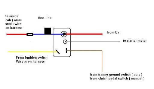

I have a 71 R/T with a 383 and I am reinstalling a fusible link to the starter solenoid which had been removed at some point in the cars history.
Can someone take a photo of the plug that is on the harness that the fusible link plugs into?
Thanks.

Starter relay.

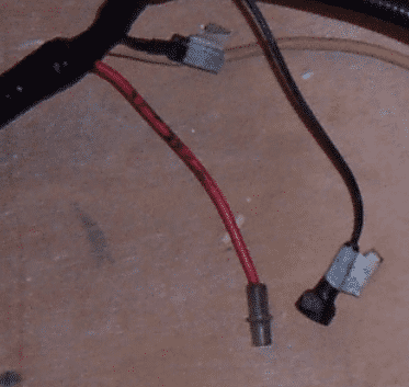

Thanks.
I believe the plug on the harness you are looking for is the one on the red wire at the bottom of this snip.
Mine are packed away for installation down the road ('74 Cuda) - this is from a pic I took in reconditioning them last summer. That wire comes from the bulk head connector - from the ammeter.
