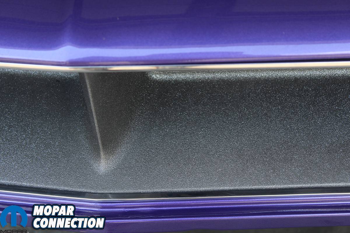

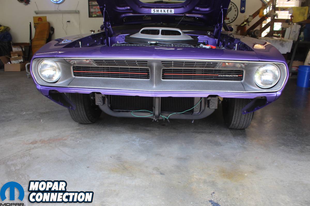

The correct 1970 grille color for non-AARs/Gran Coupes is Dark Argent. There is quite a variance in different lighting on just how dark it is but it is always darker than the Rallye wheel center caps, the Shaker scoop, and the Cuda "shark's gill" rocker panel mouldings. More info here: Mopar Connection's "Comeback `Cuda"
Correct Grille Dark Argent on Comeback Cuda as per Gibson and Badalson 3.jpg
Correct Grille Dark Argent on Comeback Cuda as per Gibson and Badalson 2.jpg
And this perfect rendition in good lighting:
