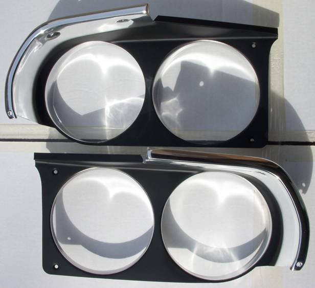

FYI The RT bezels are in black, and non RT cars had textured argent. This is a pic of reproduction pieces. If you can't find them here, Used ones are also available off of ebay in all different conditions and prices.

Ok so I’m switching my 73 to a 70 I have the grill the filler and am looking for the headlight Basel’s what else do I need ??
The 72-74 Challengers did not have the headlight bucket panel welded to that part of the fender and used the fiberglass grill with the buckets built in.
70-71 Challengers had a metal bucket panel welded to the fender to accommodate the installation of headlights. Some people who make this modification use a 70-71 fender (side lite makers are also different but fit the car.
Other option is to weld in a bucket into the 73 fender. Off course you would need a 70 grill, the bezels, hood latch, hood moldings, and other mounting parts that are different on a 70.
Keep in mind that many other parts are different; front bumpers and brackets- bumper protrudes further out on your car.
You can purchase reproduction buckets for a 70-71 from BEA Parts
to convert your fenders.
Someone here may be able to explain this better then me. It is a lot of work to make this switch. This is just the work on the front end of the car.
