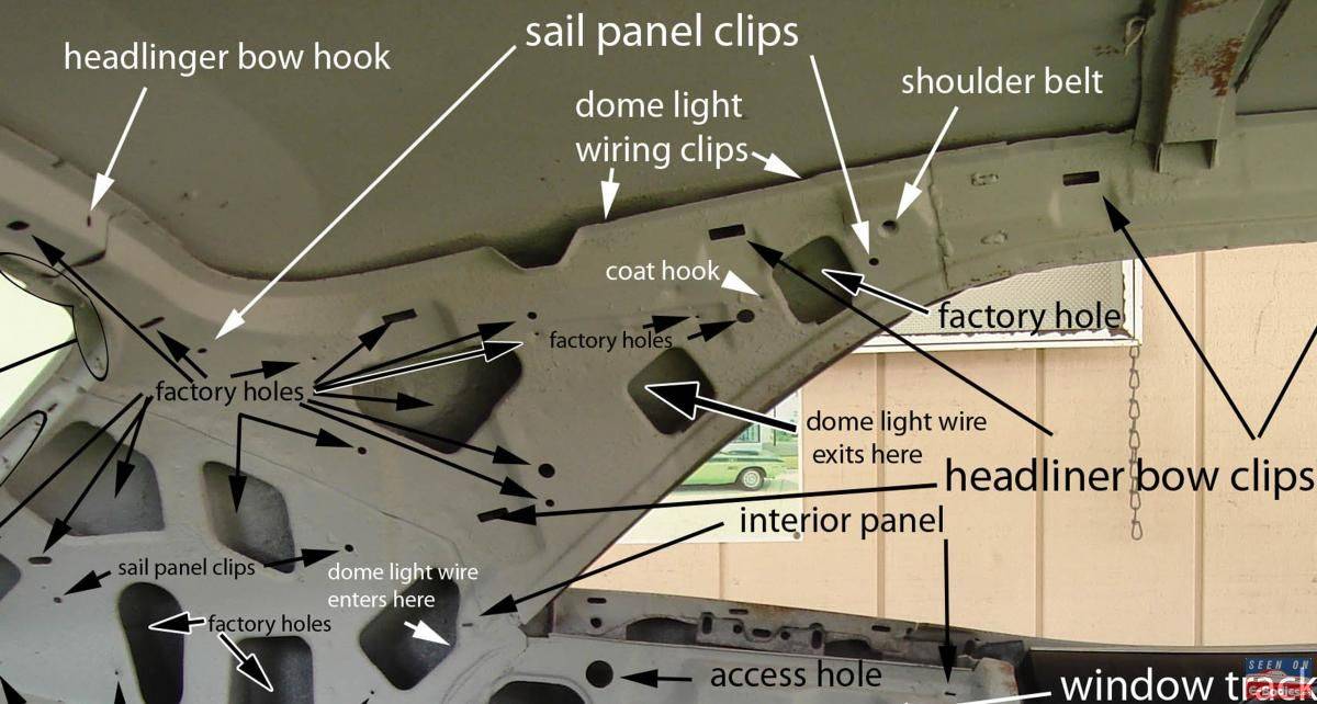

Working on installation of the headliner in my car and I cannot get any links to the hole locator diagram mentioned in several threads here to work - it times out without loading. Has it's location been moved or has that file been removed for some reason? I am looking for the holes where the coat hooks mount.
Someone else posted this a while back. Prop's to them!
Assuming your headliner is installed, with the aid of the picture posted by @Juan Veldez use a tiny threading needle to locate the coat hook hole to the rear of that big squarish factory hole.
