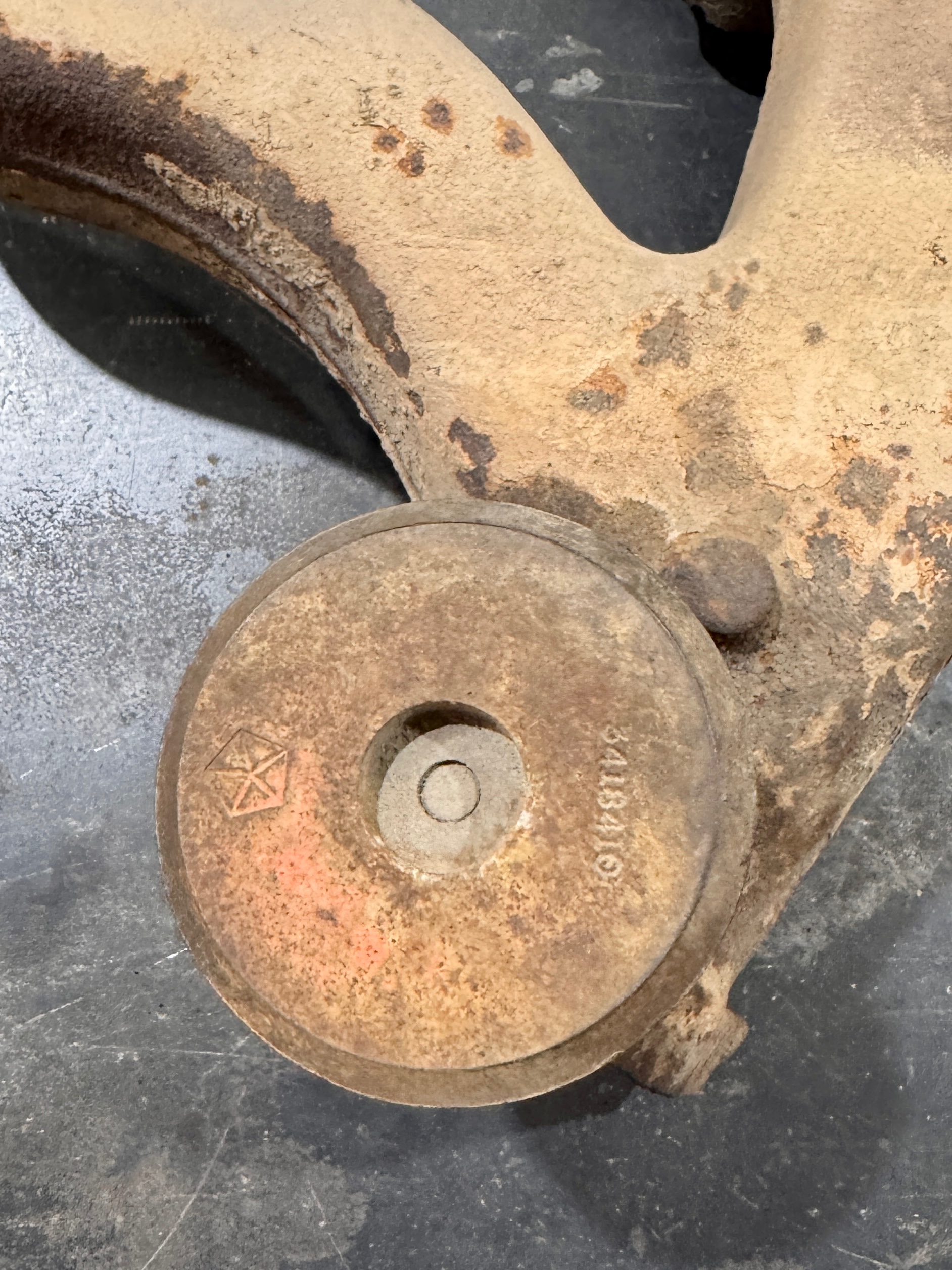

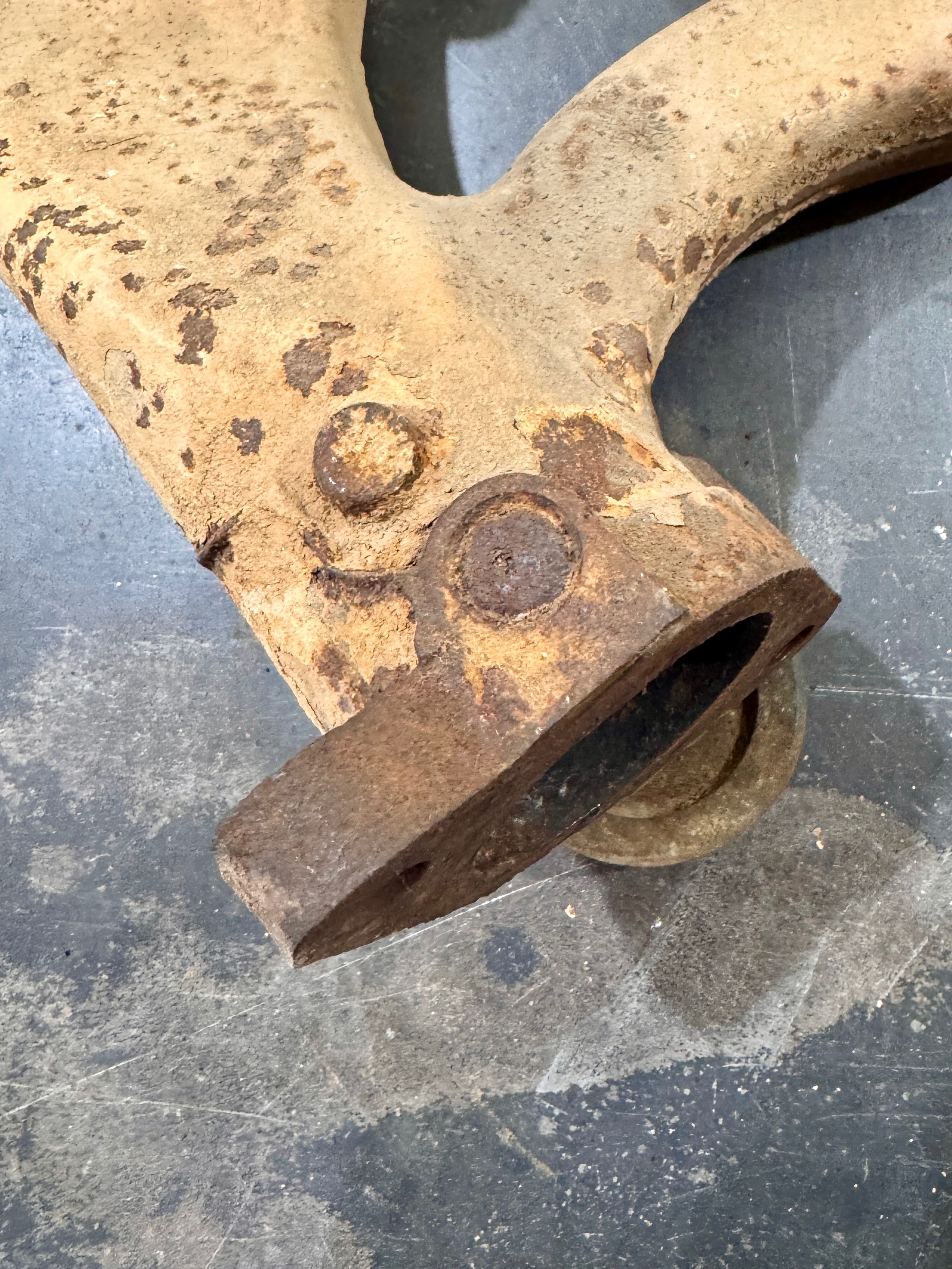

What’s the best way to remove the heat riser from an 340 exhaust manifold? Currently it is seized closed can wiggle it slightly.
Soak with PB Blaster and heat cycle it with a torch.
I cut mine out and tapped it for a bolts.

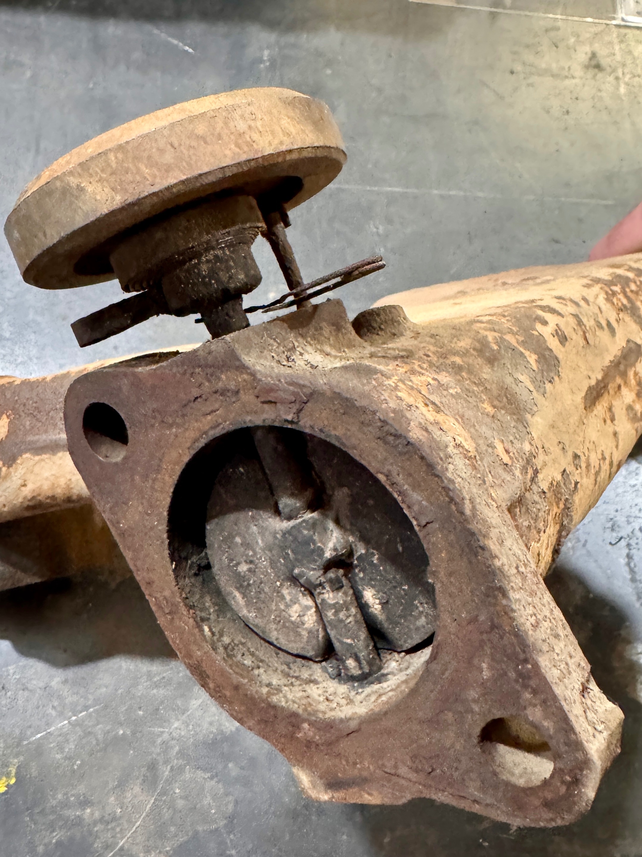

Worked like a charm! Had a hose clamp I put around the large diameter counterweight, allowed me to get a larger channel lock on it without messing it up. PB, heat, work it, repeat. Moves freely now.
Looking at the butterfly it appears to be welded to the shaft on the inside of the manifold. Thus the reason to cut it to remove it.

With a little patience, you should be able to cut away the butterfly and leave the shaft intact.

20+ years ago I cut mine off with a wheel and put a brass bolt and nut through it to stop the exhaust leak. Worked great, but not correct for an original setup obviously.
