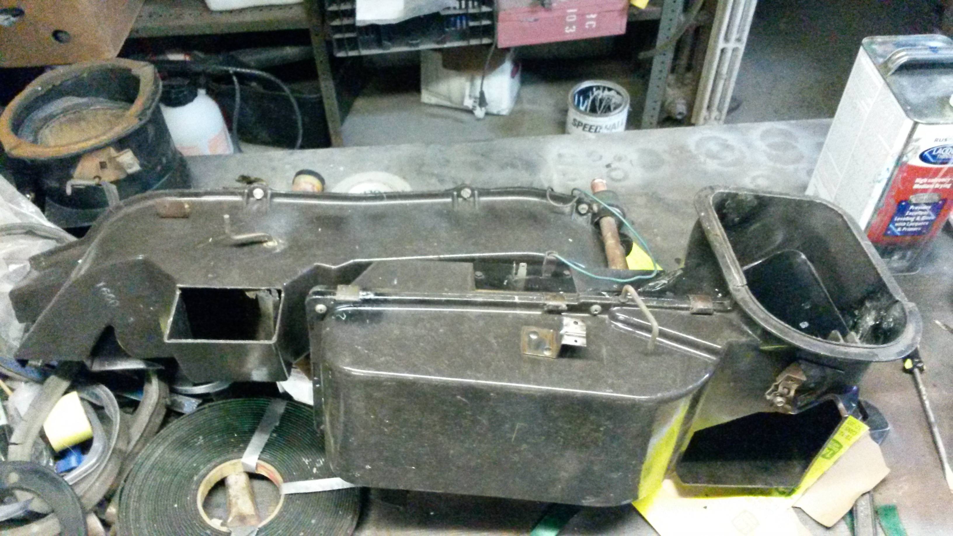

The ground wire goes from the motor to the metal plate on the backside, as shown in the photo So there needs to be a good connection there but after that, you’d need a good connection from the three mounting holes on the firewall to the firewall itself (chassis ground).
If the motor worked outside the car but not in, then you’re right to assume ground. Obviously, the battery gets grounded to the engine in the front but don’t forget the smaller chassis ground at the radiator support.
Another spot to consider is the small rectangular resistor on the box (shown in the photo) where the green wire is. Power gets sent from the fan switch to one of those two legs and resistance on the inside determines current flow which sets fan speed. A break of the coils inside could be the problem.
