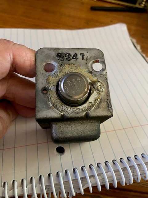

Help... What is this mystery part?
MR72Chall
Nov 6, 2024
2
2
Cameron Park, Ca
It is mounted on the upper passenger side firewall next to the Electronic Ignition. 1972 Challenger 340
I've tried looking up images but no luck so far.

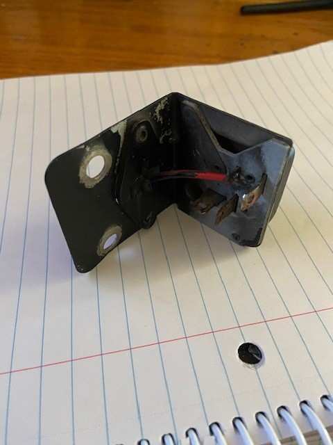

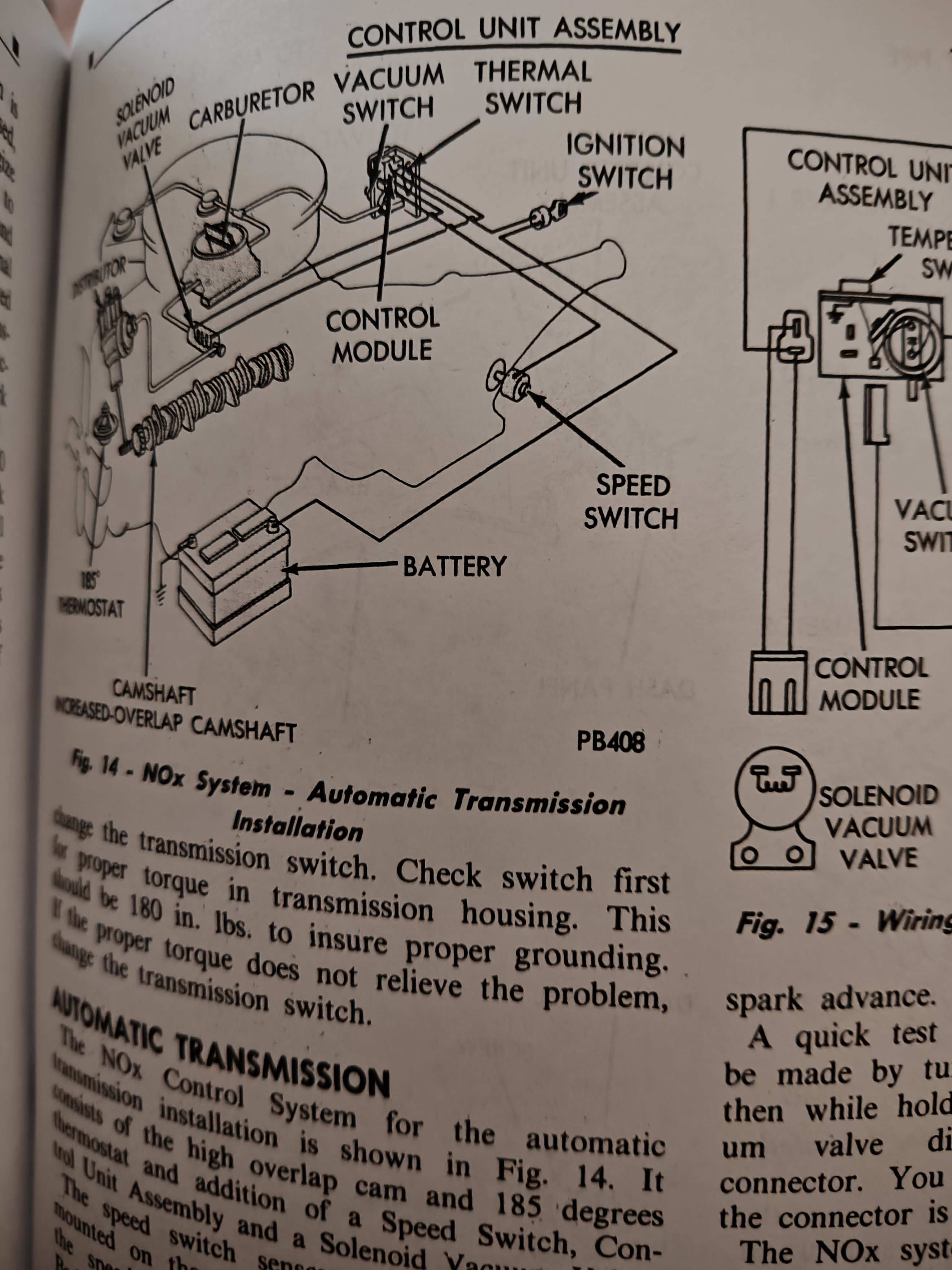

It's part of the Smog stuff (NOx system) started in 1971. See diagram form 71 Cuda shop manual. Personally, I would chuck it. Or at least make it for "looks" only.
MR72Chall
Nov 6, 2024
2
2
Cameron Park, Ca
Thank you for looking this up! Been scratching my head for days. I agree. I'll paint it black and put it back to fill the hole in the firewall where that big capacitor sticks through.
