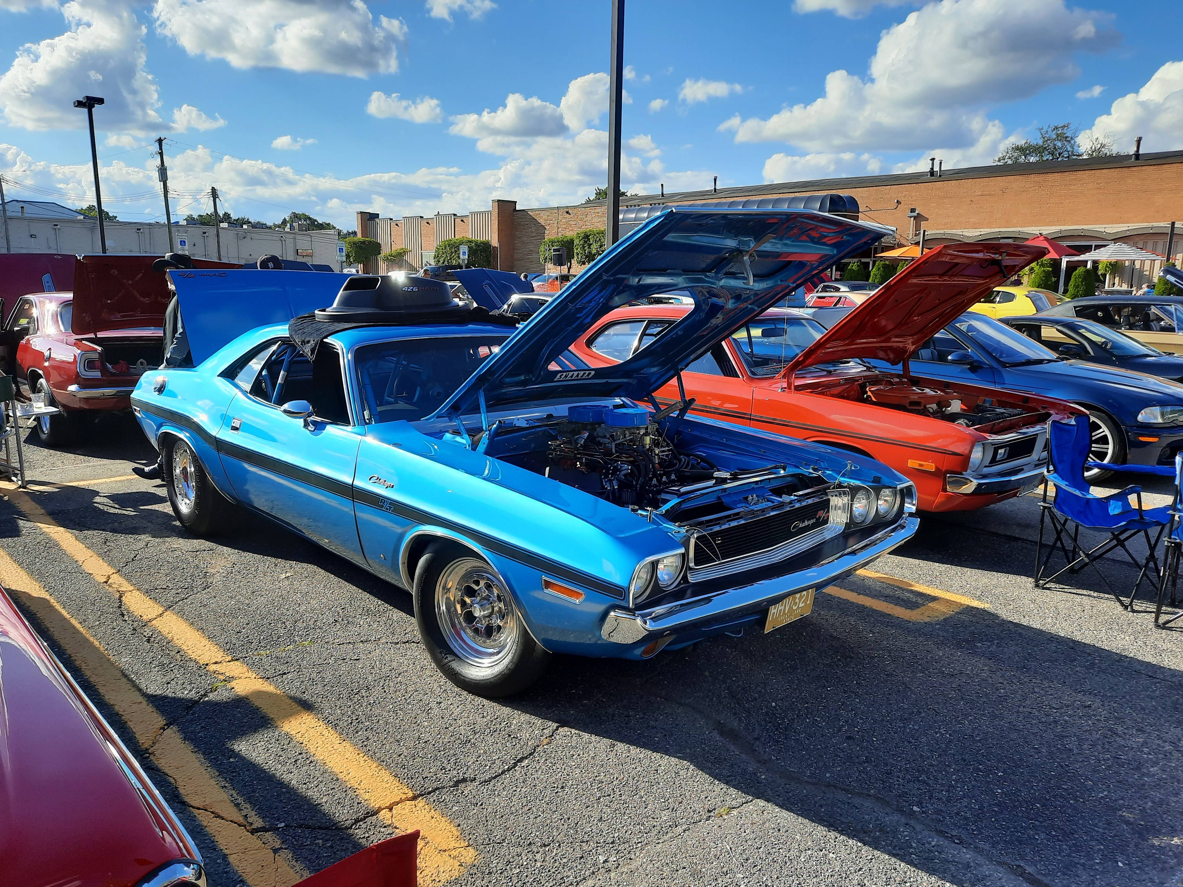

EFI is my next upgrade with two 4500 Dominator throttle bodies for my tunnel ram on my 528" HEMI. I still run a custom Super Shaker hood and bubble and want to retain it all with the EFI.
