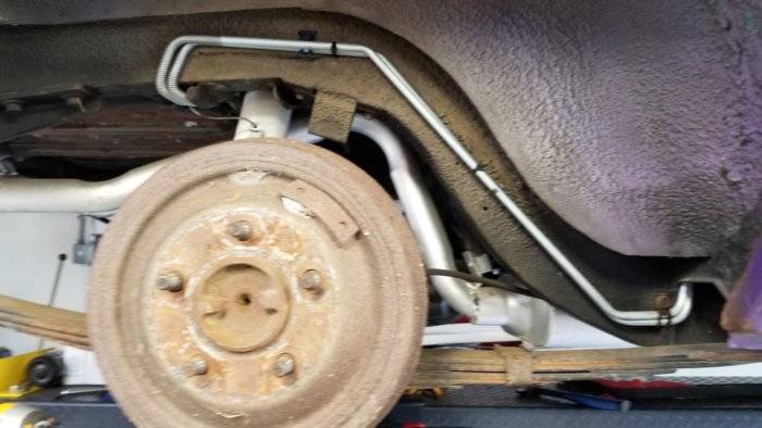

A few months ago I installed a Sniper system with EFI tank also. I ordered two new 3/8" steel pre-bent lines from Inline Tube. I was concerned 3/8" lines might not fit together but it worked. It was tight but fit. I added additional spring wrap in areas where contact was made. Happy with my results. '73 Cuda

I didn't take any pics but I can. Basically I came out of the tank using AN fittings to flexible hose, then thru a fuel filter mounted just above the tank on my frame. From there still using flex hose to another AN fitting connected to the hard 3/8" fuel line. Same thing on the return side, AN fitting from fuel line to flex hose back to the tank. That way there's some "give" to any vibrations.
Up front by the throttle body I just used flex hose from the TB to AN fittings on the supply and return lines.
I didn't flare any ends, just used AN to 3/8" line connectors (ferrule type). Hope this helps...
