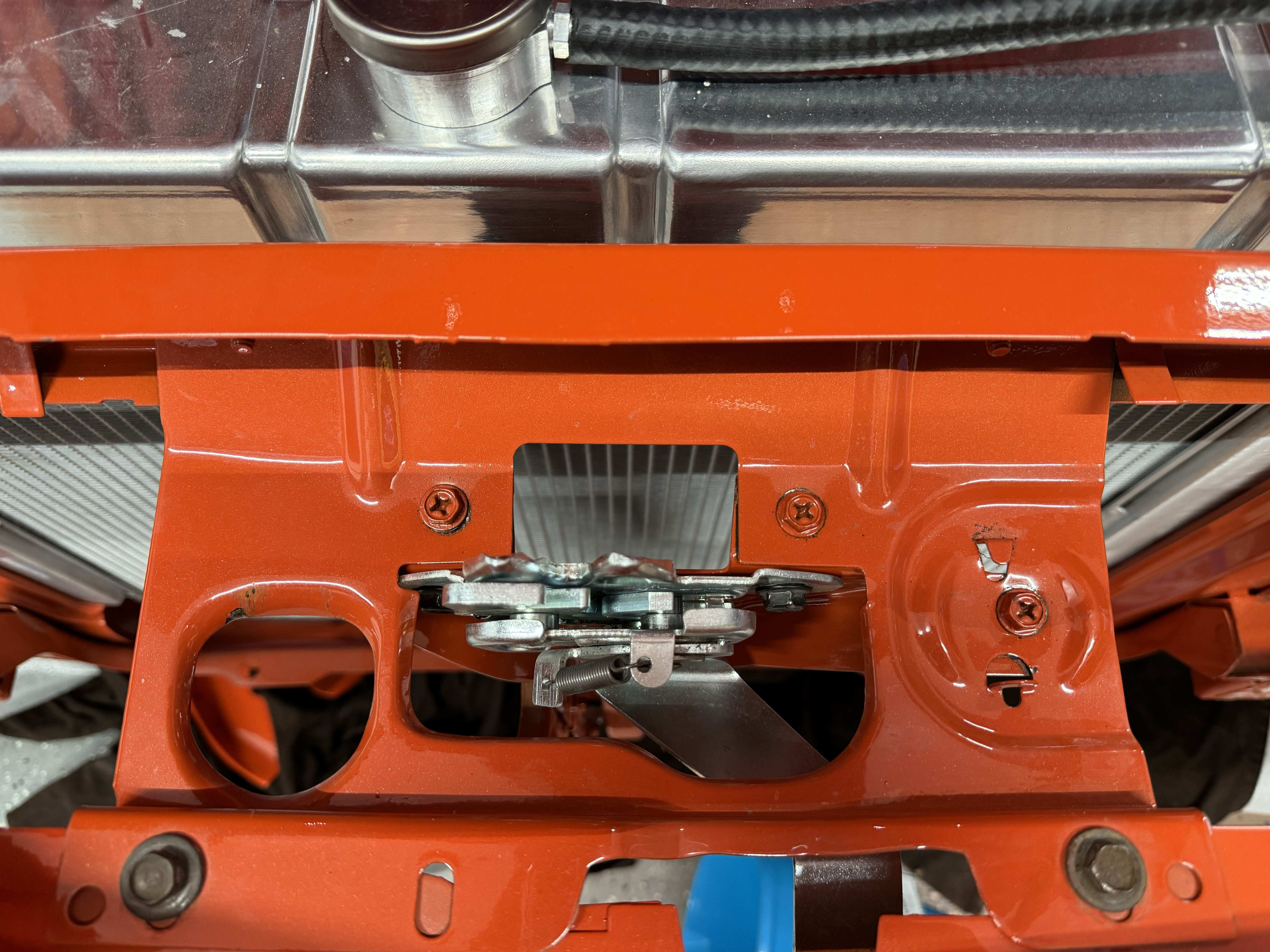

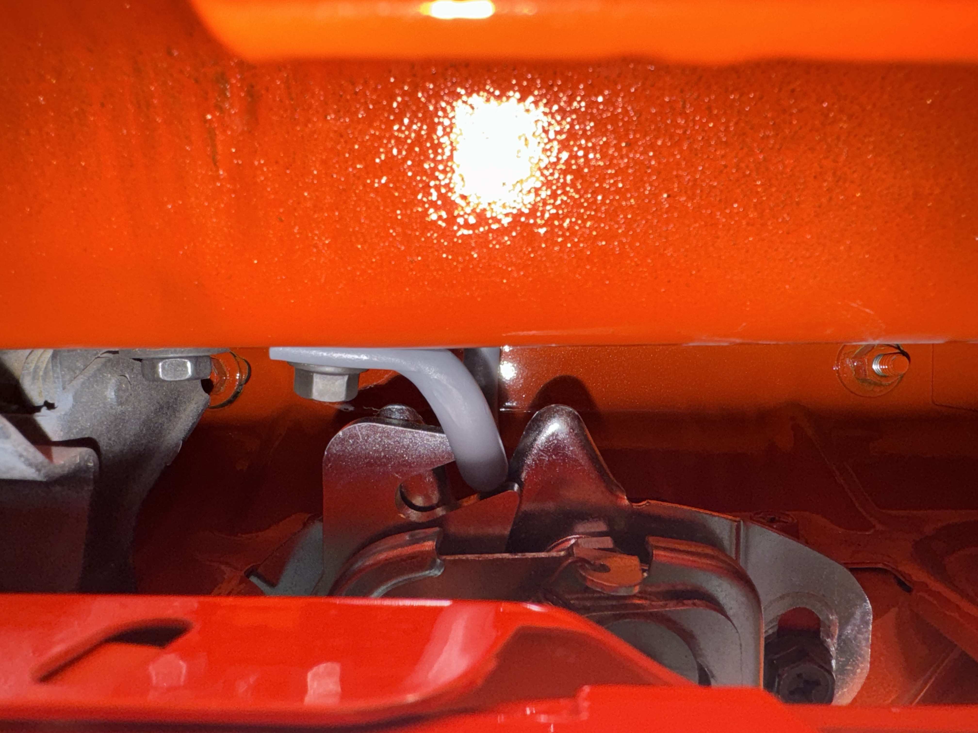

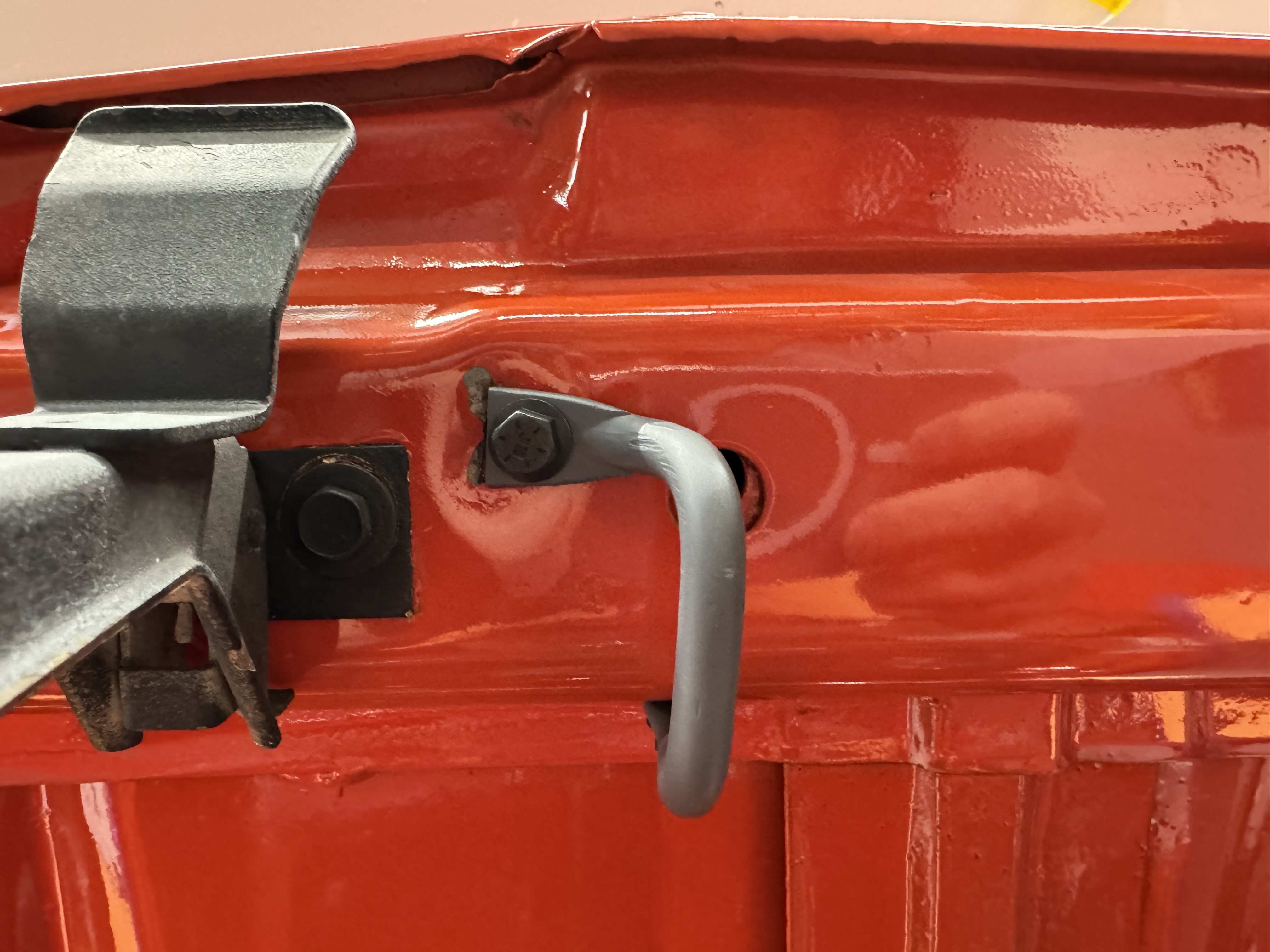

So I’m working on finishing up my 72 restomod and I’ve run into an issue that I’m continuing to struggle with. The hood is aligned great, closes about 98% of the way, but the striker will not fit into the latch. The latch is moved as close to the rad support as possible and the latch only fits one way. I have replaced the latch as I thought it was bent but it is not. The striker is not forward enough so the front bend is hitting where the latch closes over the striker instead of the flat part of the striker so it refuses to snap over and close.
Has anyone experienced this before? I would post pictures but it’s almost impossible to get one with the hood down.

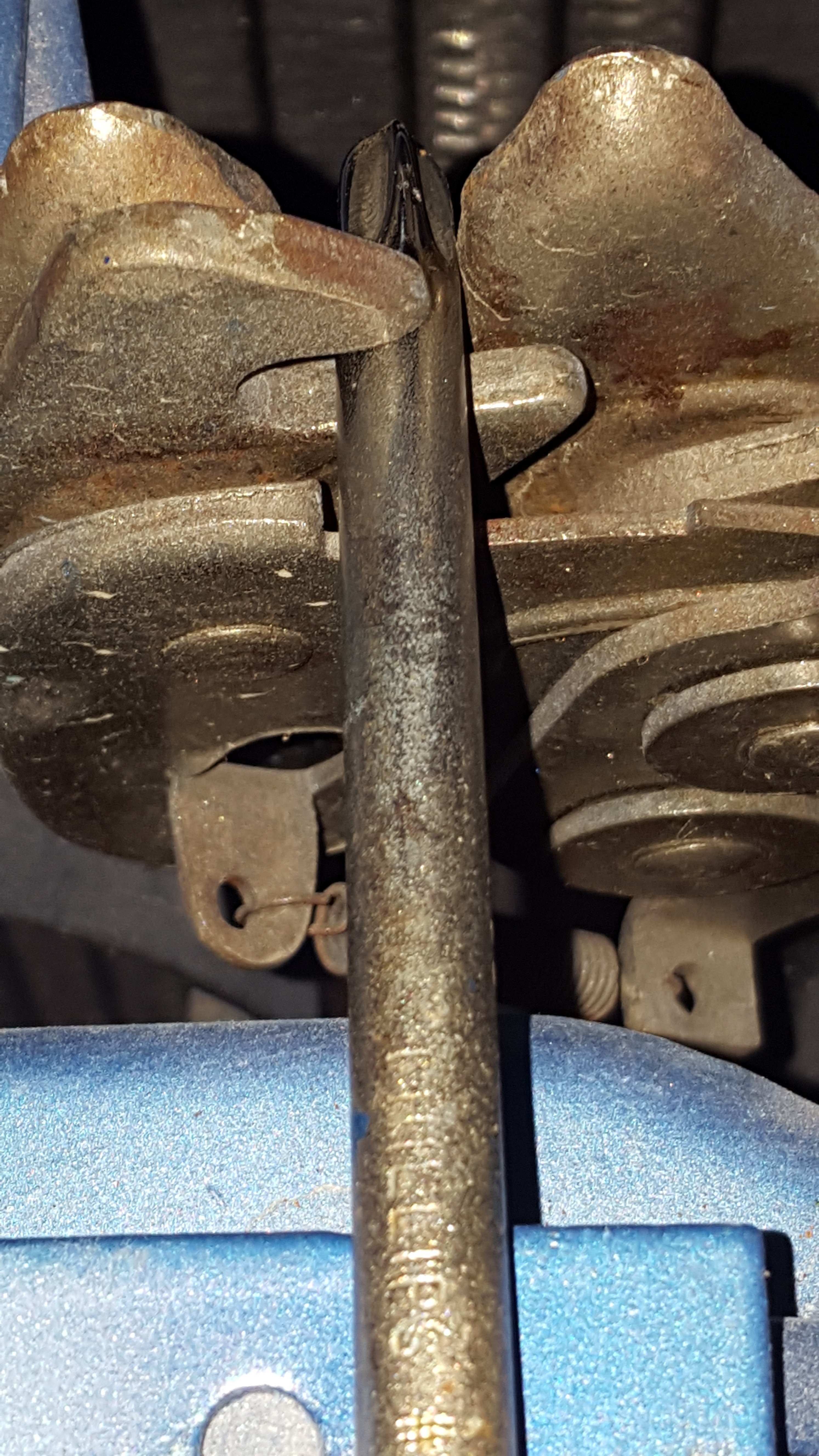

Use a large Phillips screw driver from the front and push down. I might be hanging up if it doesn't latch. If it latches move to step two.

Use a large Phillips screw driver from the front and push down. I might be hanging up if it doesn't latch. If it latches move to step two.View attachment 119505

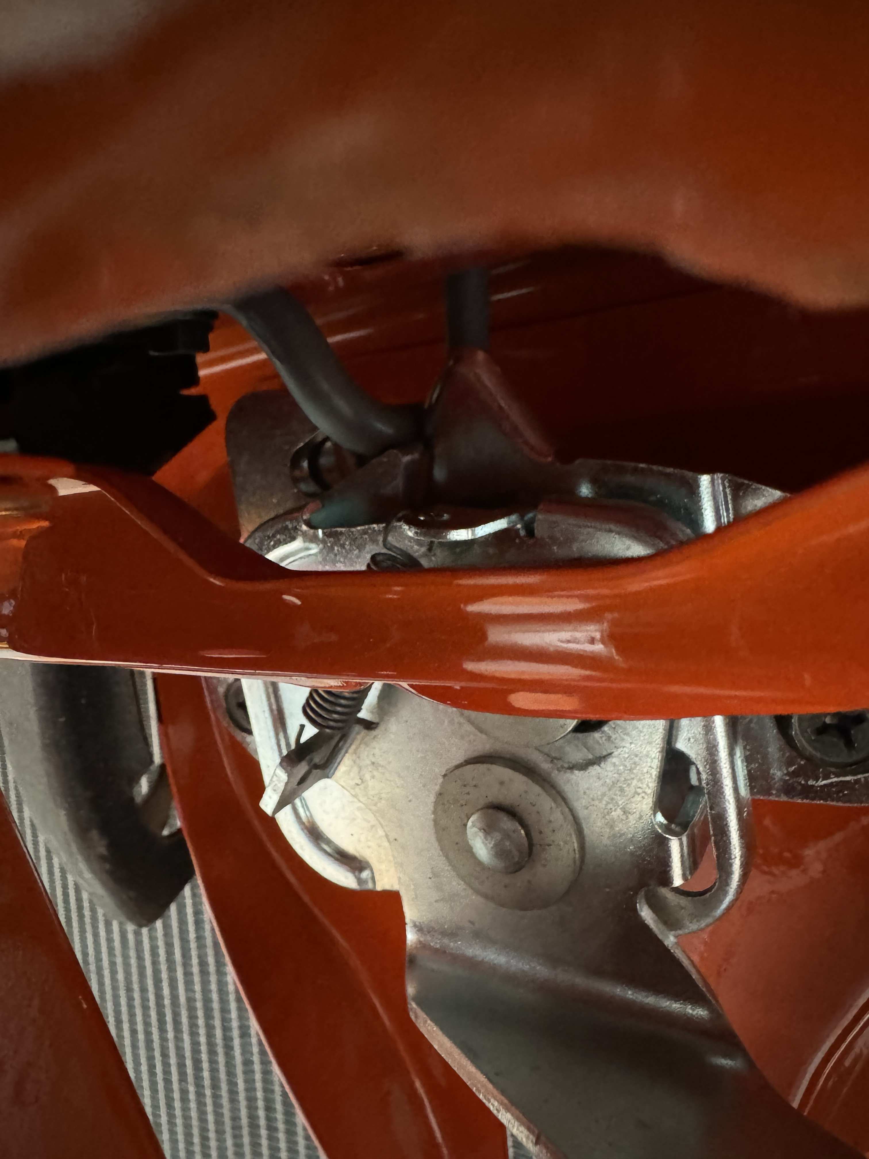

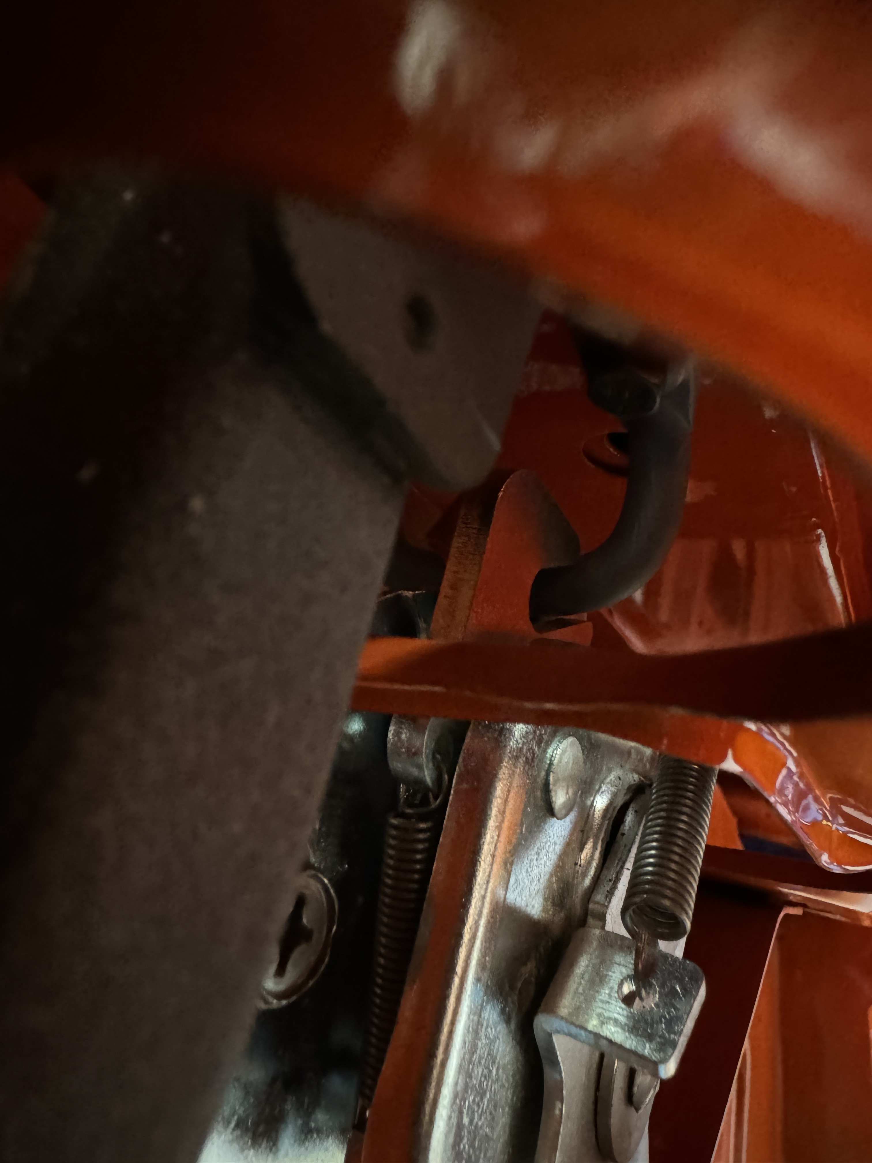

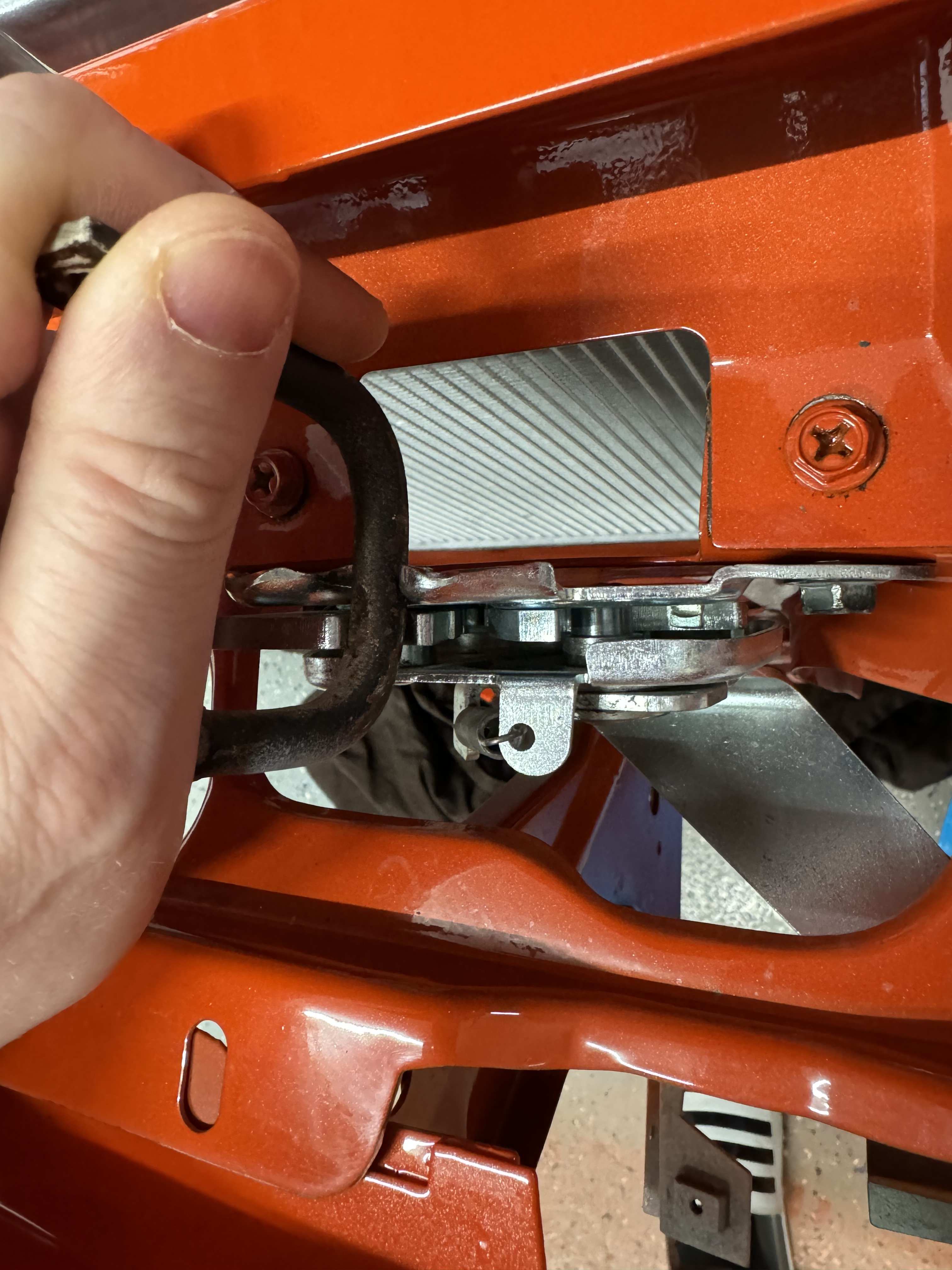

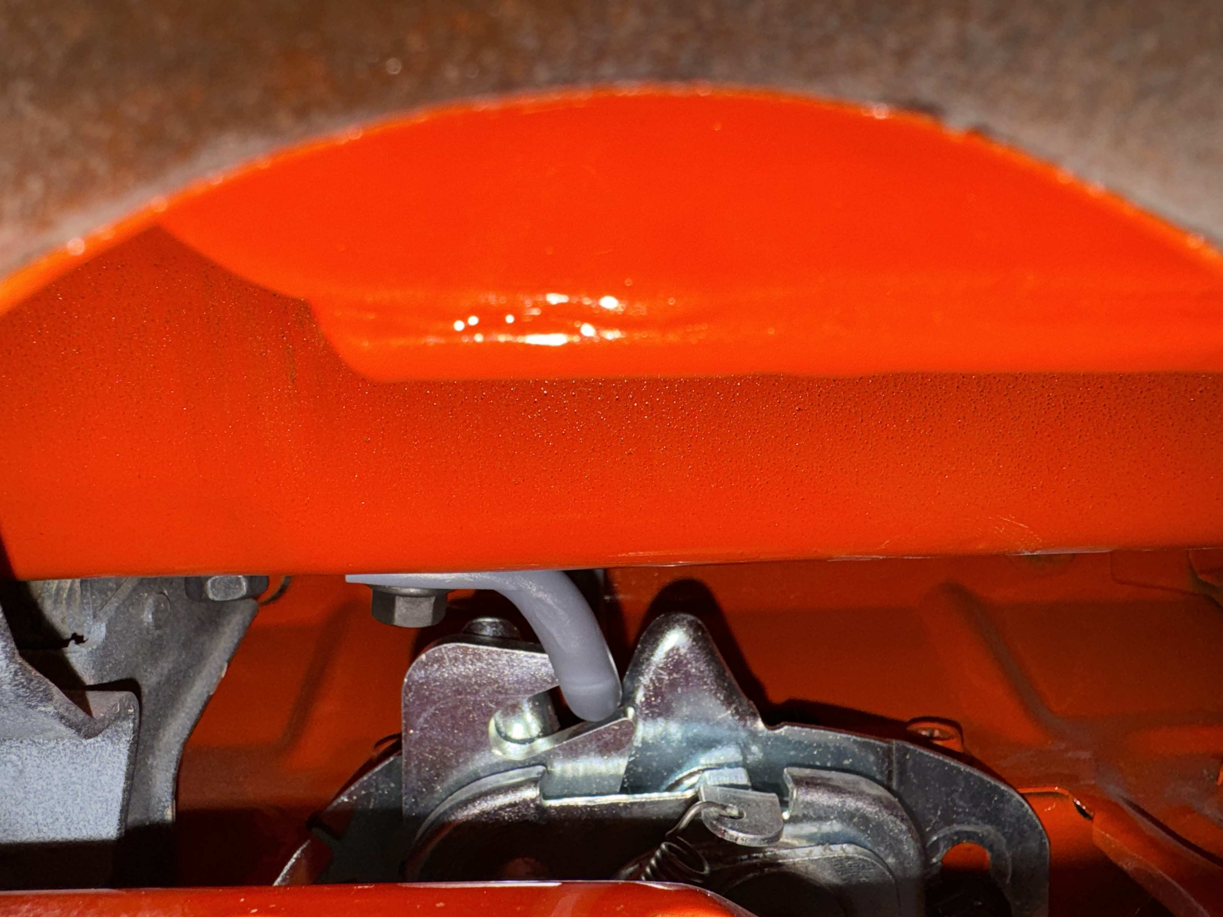

I used the spare striker. It latches fine when the striker is inserted with the flat part. If i slide it towards the engine though, like it is in my photos, the latch will not snap over top of the bar because it’s hitting the rounded portion of the striker.
Either the striker needs to come forward, which I don’t think I can do, or the latch needs to move towards the engine. I may end up having to pull the latch support and grind out the mounting holes so I can slide it backwards I suppose…?

Move panel and latch mount adjustment. hood strike is fixed unless the hood is moved. Where the panel mounts to the center of radiator support might need need worked. Tweaked!

Kind of figured that was the only trick in the book. I’m going to have to modify it then, I can’t move it back any further. Quite an oversight by the guy who did my body work but that’s a whole other story…..

Get some clay or silly putty and put on the bracket and close hood you'll be able to see where you're coming down on.

Maybe it's just me, and there's still just a little adjustment like you guys are suggesting, but the stricker looks kinda "fat" to me and the radii look bigger than stock.

That's kinda of what I was thinking. but he is saying it need to move and it will latch. Maybe grind it down if adjustments don't work.

One thing for certain, after opening and closing the hood about two thousand times or so, everything will "key" together. My 70 Challenger (54 years and 250k+ miles) is certainly not tight at the latch anymore! Might just need to take a rattail file and slot a couple holes slightly and it'll fit fine.

Looks like the striker is bent/not straight...
I thought that too so I replaced it and both are identical. If anything, the one mounting hole is slightly indented but that would only affect the left to right, not the forward and back which is my issue.

Hmm you considered shutting that hood a gazillion times? Letting it wear in?

No but I may try to wear it in a little with a dremel lol. I’ll take a look at the old latch and compare. The original striker was obviously worn so I might try to take a little material off the new latch to try to get it to snap shut.
