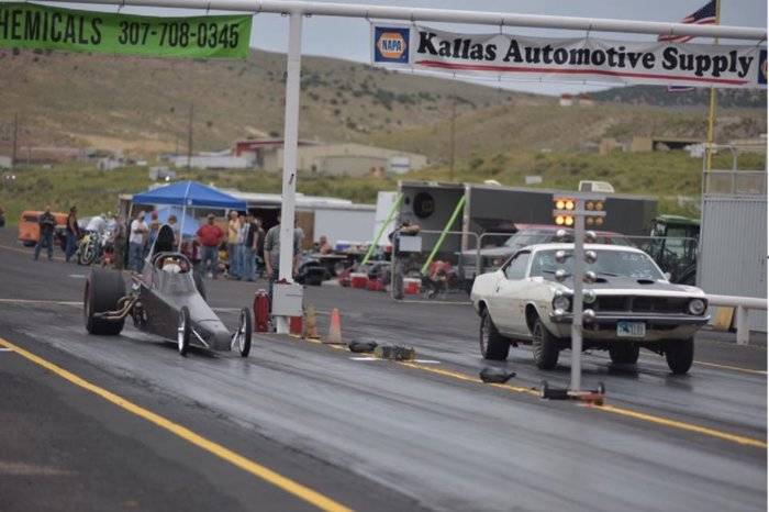

This is what it looks like when it Hooks
This is what it look like at rest

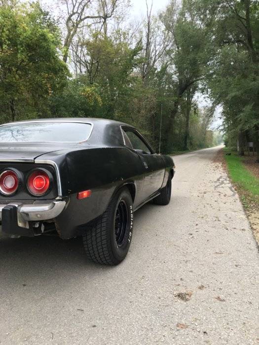

Ok so i have bought some 3800 pound SS Spring, Spring relocation kit with new perches, and while I'm at it. It' a good time for a back brace for that 8-3/4

I think you are going to have pinion angle issues if you mount the spring perches there...
Cudafever
Dec 23, 2010
146
11
:lol:I knew i was going to catch greaf when i placed them there. But gravity just wasn't helping much.
There, that look better.

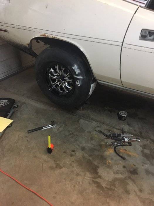

still need to weld my purches to the housing, but there it is.
that's at ride height and if they don't sag to much they clear.
If they do i will have to step back a tire size or pay to have it mini tubbed.

Looks like it sits high. You should have plenty of clearance. Here is how mine looks mini tubbed with -1" springs.

there SS Spring and yes there high.
That look way good.
someday i will have it tub and a roll cage. Not fast enough to force me into it yet.
