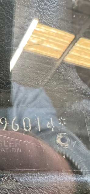

Does the partial vin number stamped on the radiator support and on the drivers side cowel area match the vin tag?
VIN matching is important. But if it didn't match, it will still be a tribute car. It's all them other rare and terrific options that make it a high dollar car. Unless their authenticity is confirmed, it's value is lower as a tribute car.

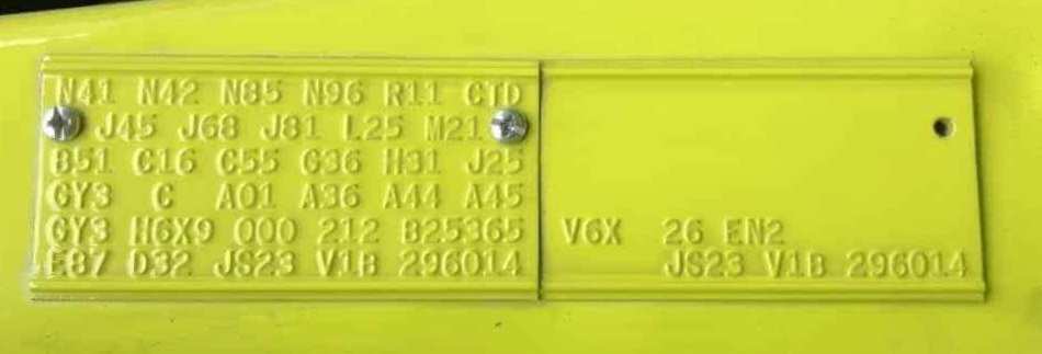

If you can post a picture of the fender tag, it should be easy to spot if it's a fake or original! The VIN is definitely a 440 Sixpack, and if the engine, transmission, radiator yoke and cowl have the same VIN, the price these guys are telling you are reasonable. There has to be a Mopar club near you who may know about this car. If they don't know, there should be someone with a lot of knowledge to go over the car to ensure it's authenticity! I'd want several people to help look it over before handing over $80 to $100k for a car like this!

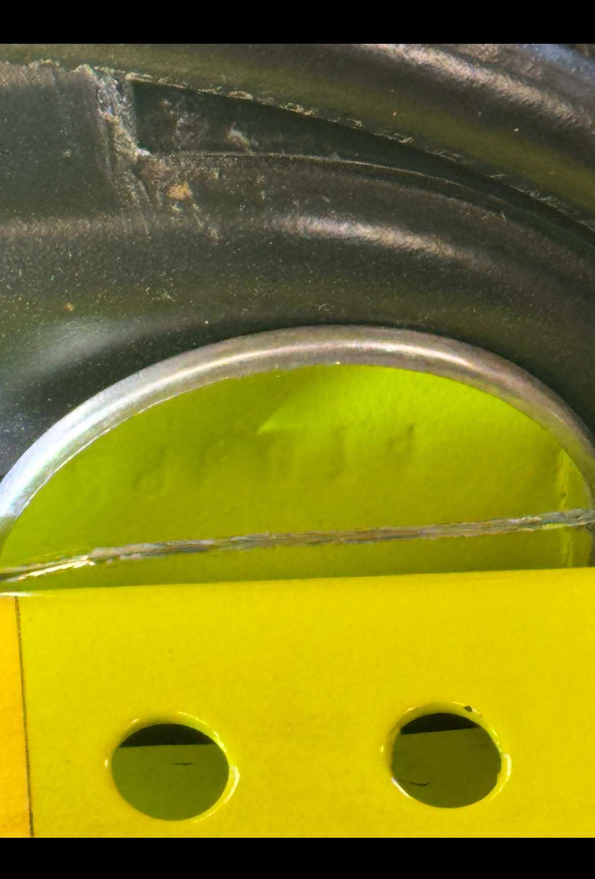

Radiator support would be my guess! And it appears to match! Basically that tells you the dash with the VIN and fender tag were moved over to a 318 car. I say 318 car because they were to most produced E-Bodies of all engine sizes. If the Challenger runs as good as it looks in the photos, and it appeals to you such that you'd be happy driving it anywhere you want to go, but it! It will only increase in value in the long run! 😀

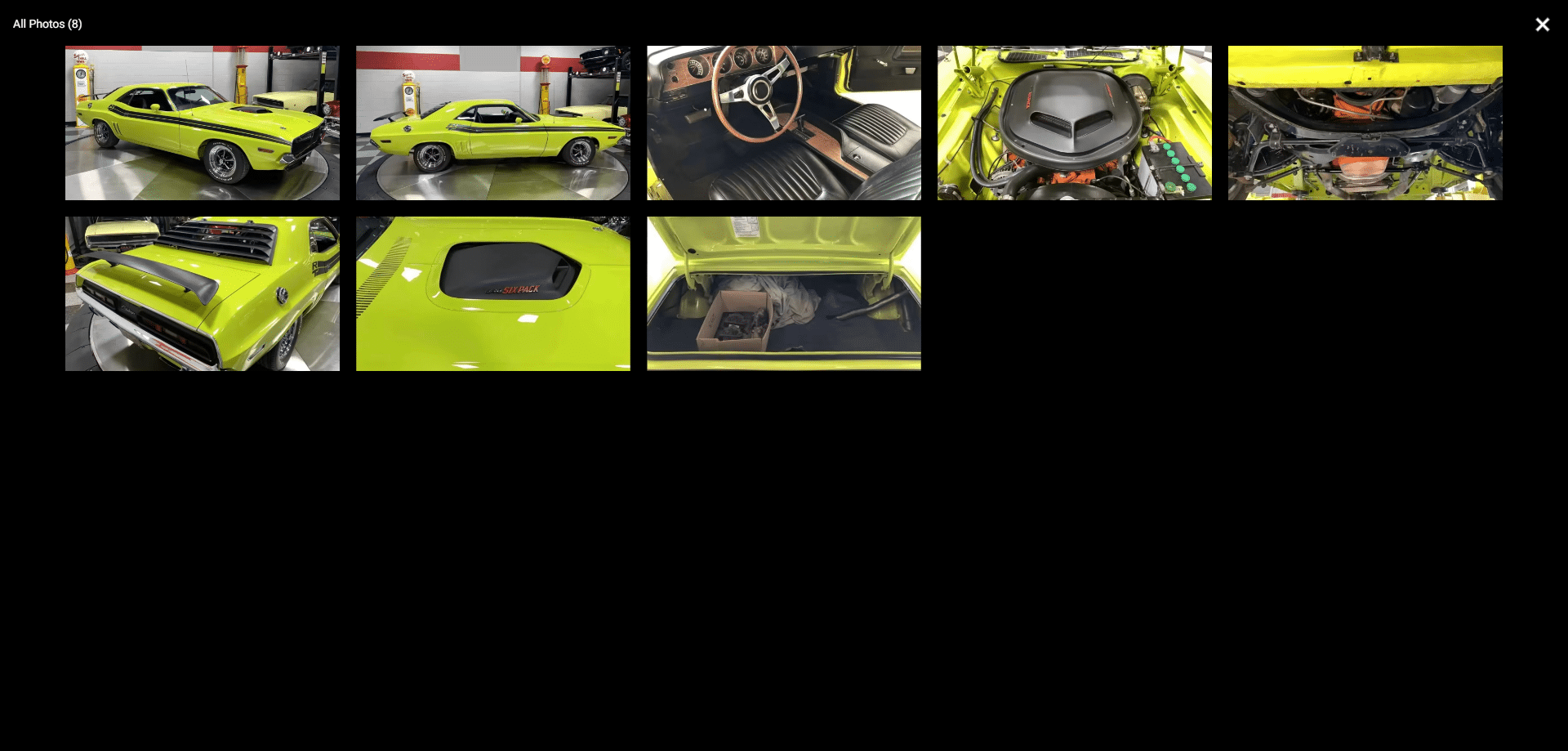

It does appear the car has sold a few times at the big auctions.
No picture of the fender tag?

radiator stamp match's the vin tag. Cowl stamp is an important one to see.
Thanks, So that was the radiator support number? I will post up the info on the the car when it arrives.

That thing has everything I would want on a car.
Why not just fill up a couple spaces on the second tag.
This even comes with a trunk compartment lamp.
SPD of 212
VON of 825365 Hmm.
Regardless of all that issue, this is a BEAUTIFUL car !! Recreation /clone/ whatever. It's awesome!
