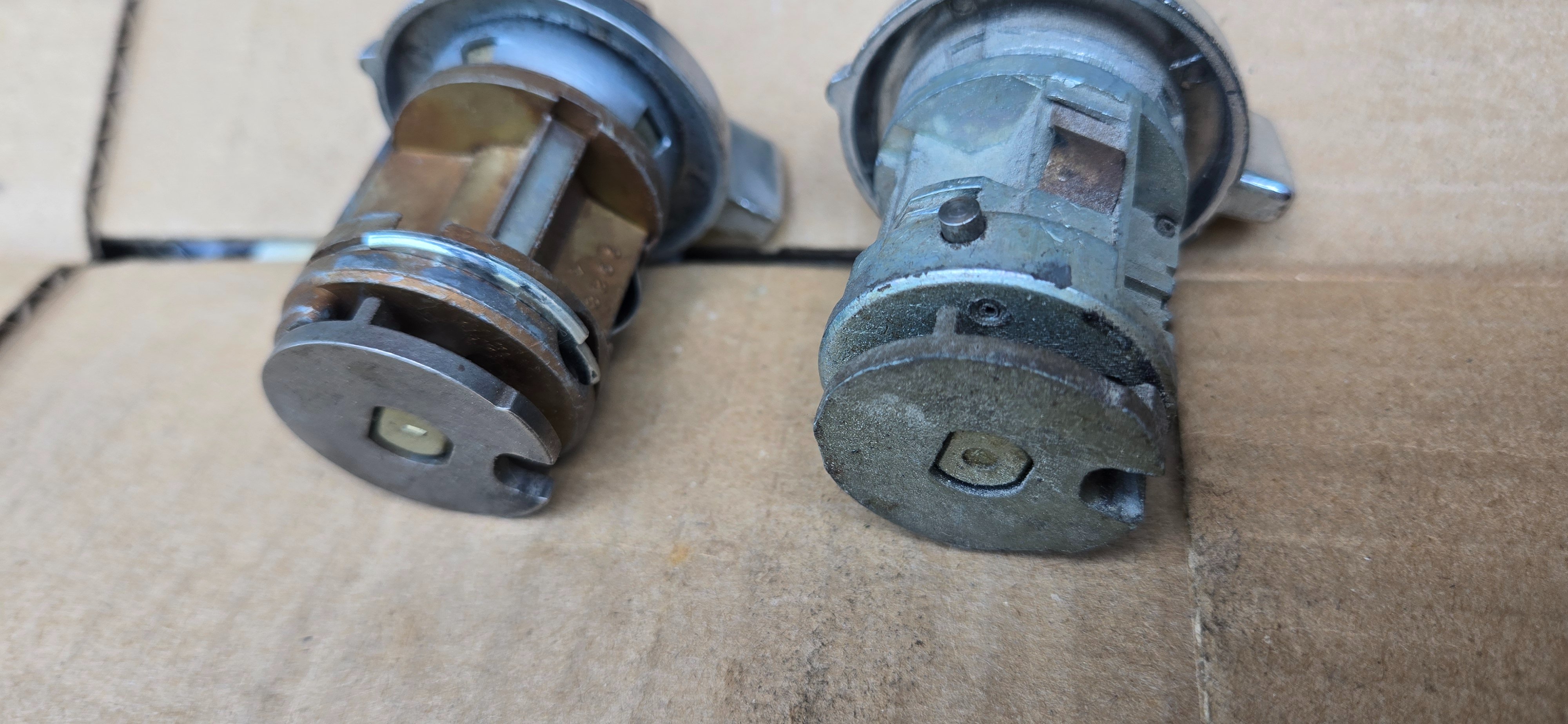

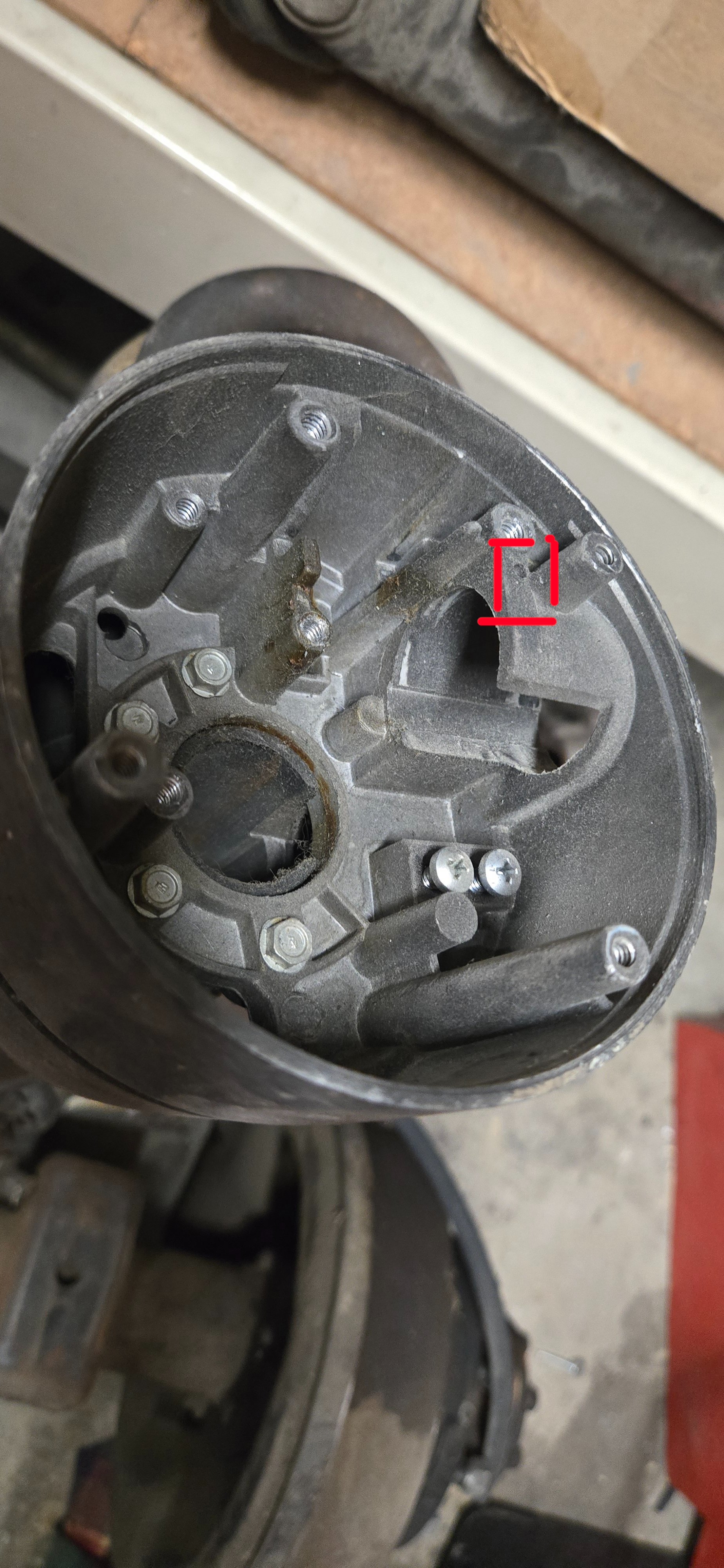

Yesterday at 4:03 PM #2 Mr Cuda Well-Known Member Joined Jan 26, 2022 Messages 433 Reaction score 250 Location North of Seattle Remove lock star wheel and get to here on column. (shaft in is fine). Depress the lock cylinder dedent (small rod or drill bit) and pull out. Blind hole to push in is marked. 70 (right) and 71 up lock cylinders shown
