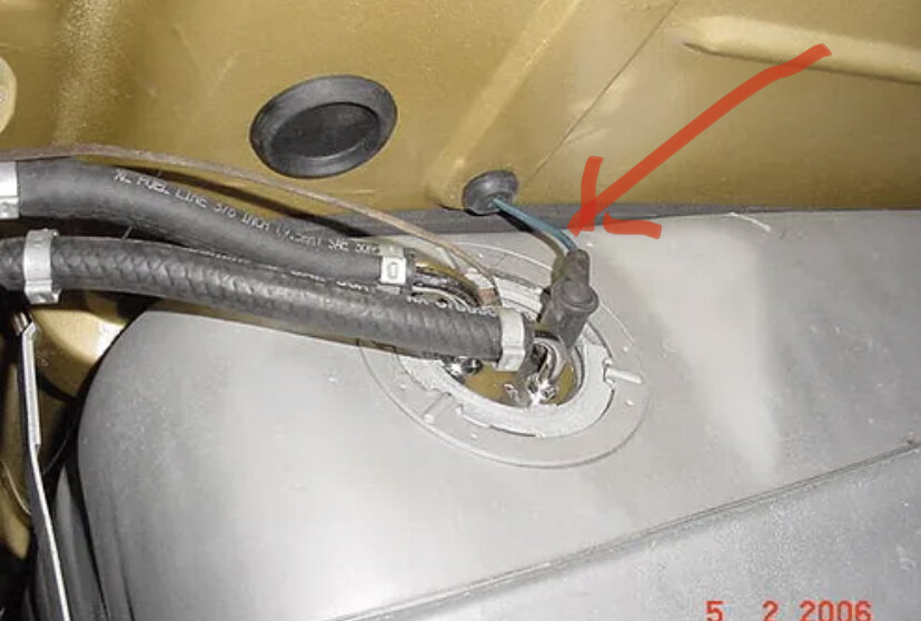

Ps: what is the little plug (in the pic attached) above the tank that seemingly goes up to the trunk? An insulated ground?

Thought about it but was hoping someone (store/business) might be doing it. Not hard to do, I might look into this. Thanks for the nudge.
It's for the fuel gauge indicator.
The thin rusty wire strap just above the the top hose is the ground.
