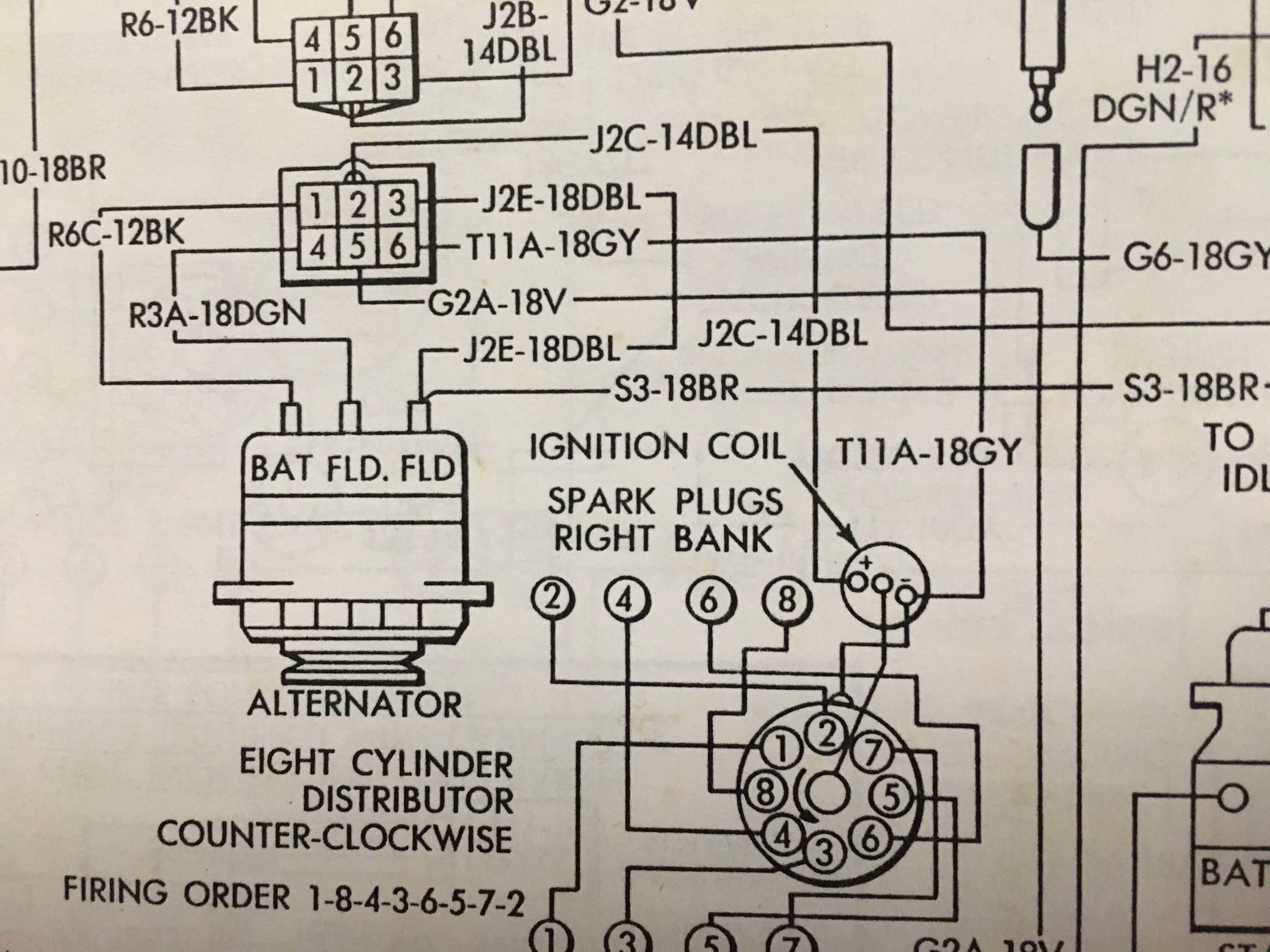

I'm new to the site, first post, but I'm old. I'm supposed to have a 1970 Hemi 'Cuda, but I can't find where in my engine compartment these two bulk-head like rectangles, [1,2,3,] and [4,5,6] are located. My bulkhead looks like one for a 440, from what I see. Is it a Hemi ? I don't seem to have a vin # on my block, but the casting date was a few weeks before my build date. The wiring colors look the same.
they plugged together on the pass valve cover on the earlier one's I've worked on. the top one came frome the firewall harness and they met in the middle of the valve cover.
Thank you, Silversedan. I never noticed it, and no one ever mentioned them to me. I'm cleaning male and female connections with Oxidry to try to get a volt or two to the + coil.
