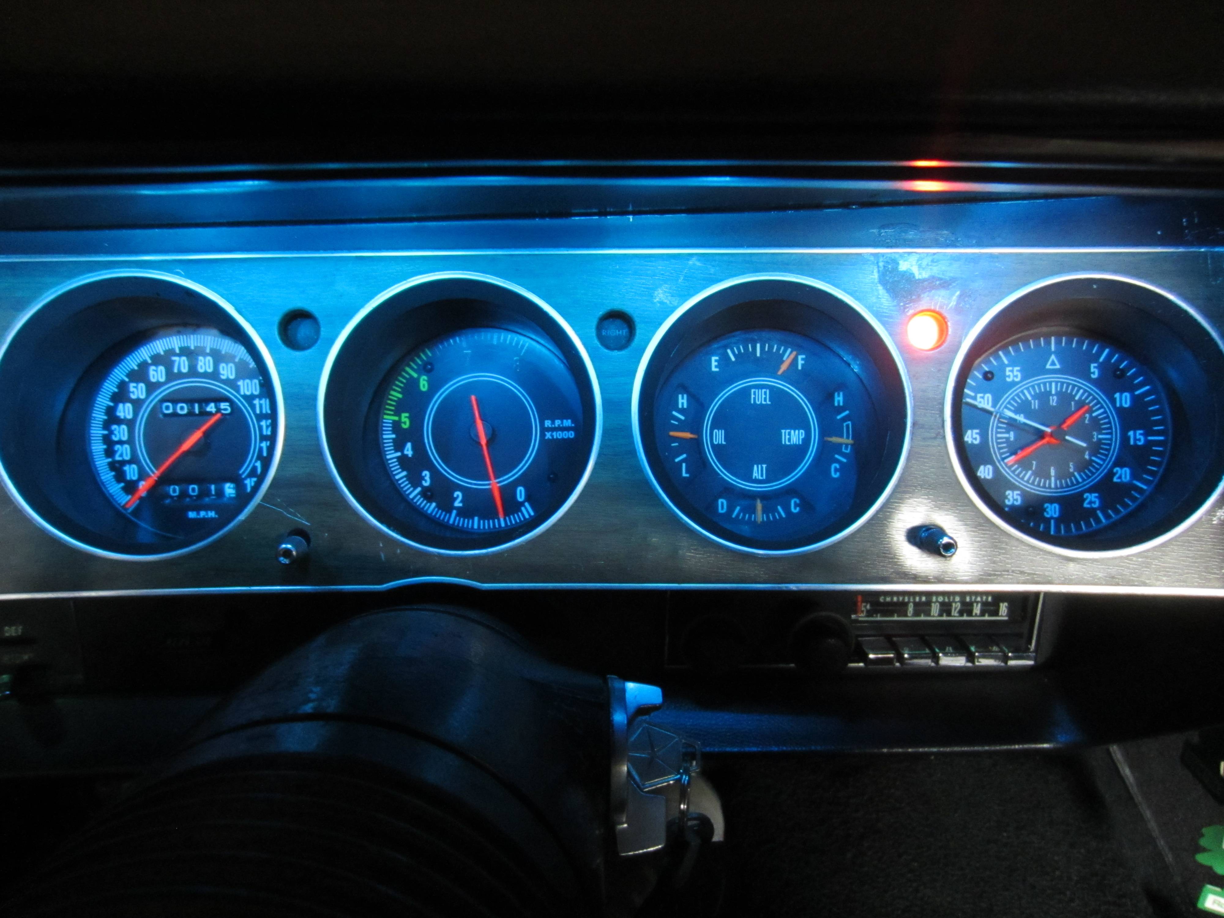

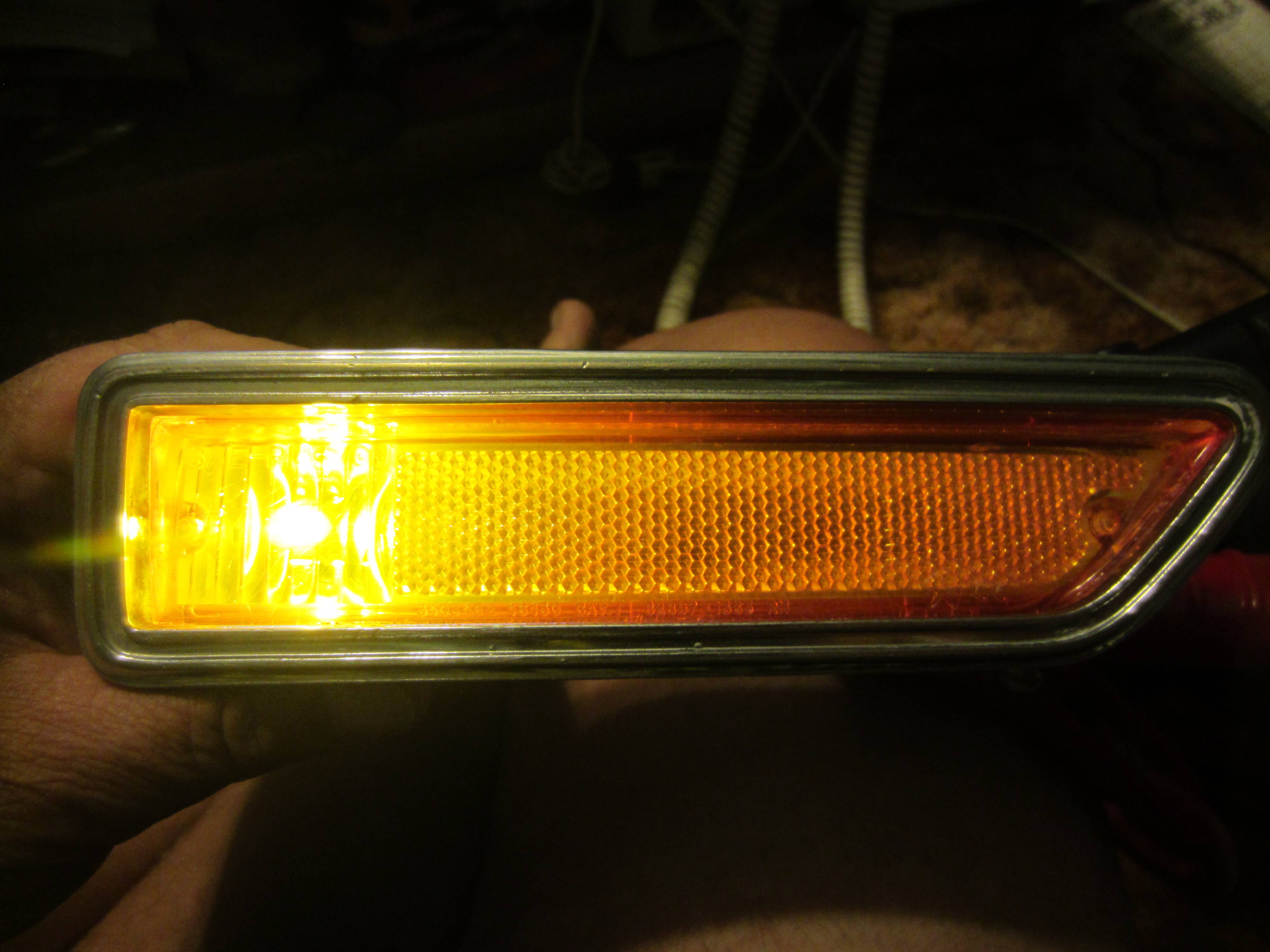

Got the side marker lamps (Amber/ Red), Instrument Cluster lamps, front parking/ turn and Tail/ Brake/ Turn lamps and they work great. Just remember to lightly lubricate the housings when you remove the old bulbs. :)

Maybe you said earlier, but what are the bulb numbers and where did you get them? Thanks.
