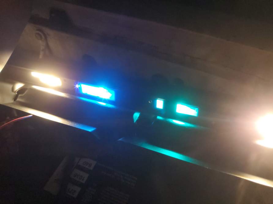

I put the Ba9s bulbs in the rallye bar I just fixed up for dads and they look really good... made some lenses to replace a bad one and this is what they look like lit up

Oh yeah, they're plenty bright enough. I have them in the light bar, turn signal indicators and warning lights and they are working really good.
