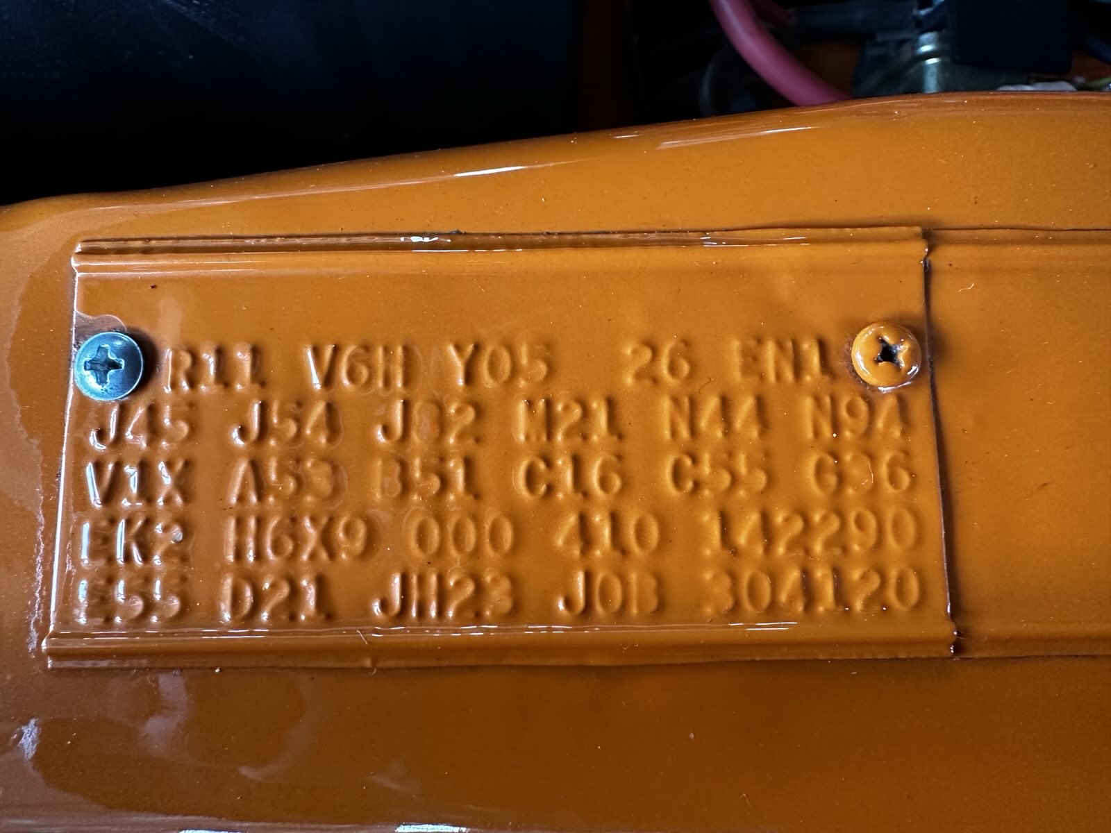

An EK2 Go Mango Challenger T/A (JH23J0B304120) sold at Mecum Kissimmee 2026 for $143,000 on Friday, January 16th, 2026.
This was a very nicely restored T/A with Standard Instruments, C16 Console, G36 Dual Racing Mirrors, and D21 4-Speed with the optional for T/A D57 3.91 rear axle.

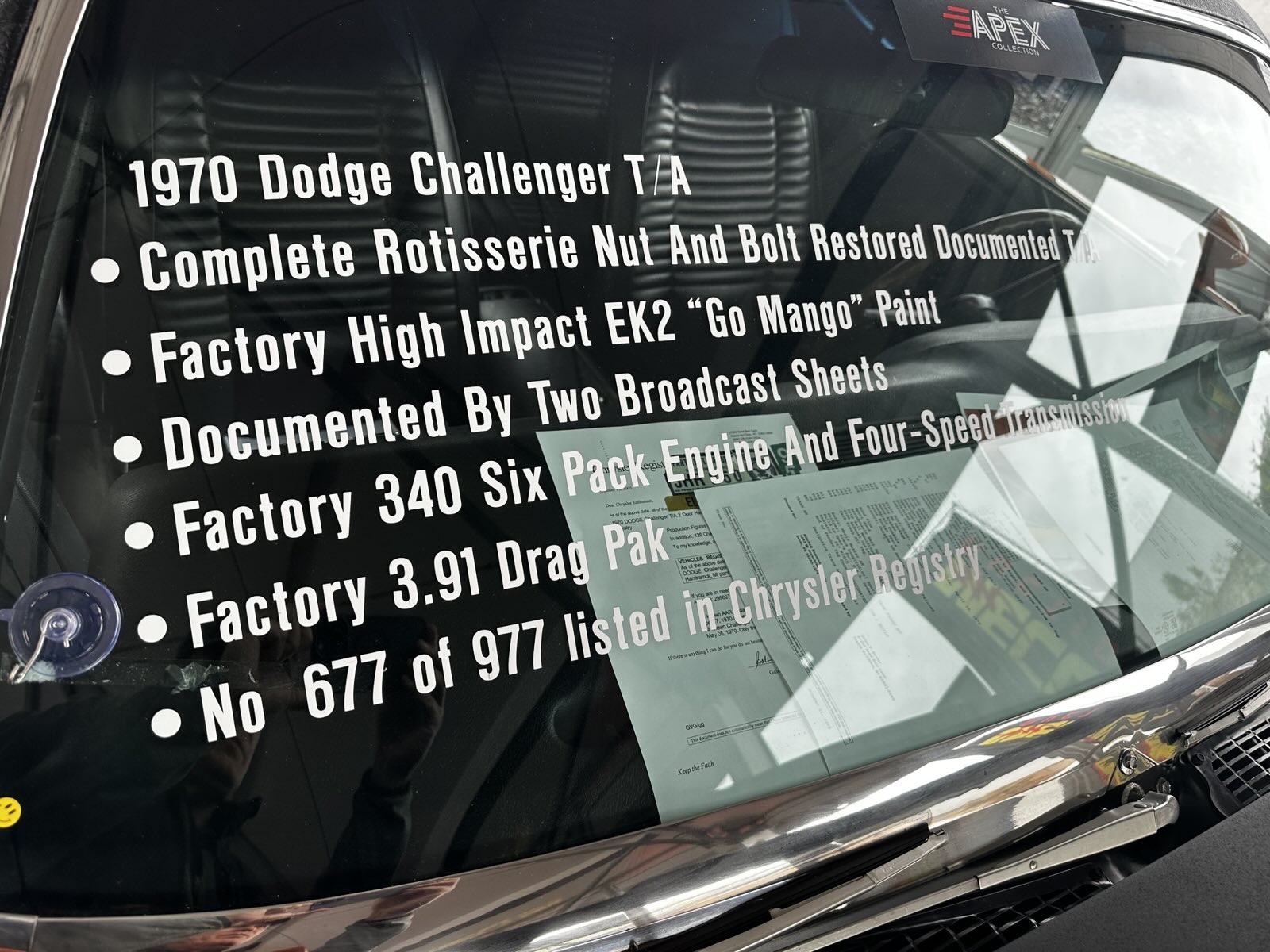

The windshield lettering called out "Factory 340 Six Pack Engine" but the car was missing its original engine.

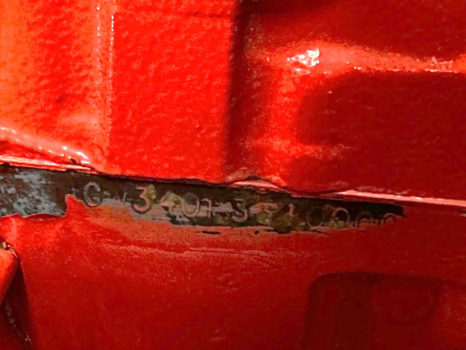

Unfortunately, it has a 1971 340 block (GW340 stamp on the block just below the passenger cylinder head). There was no indication that this T/A was missing its original engine.
