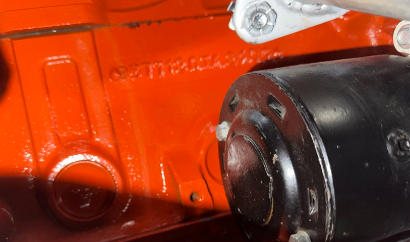

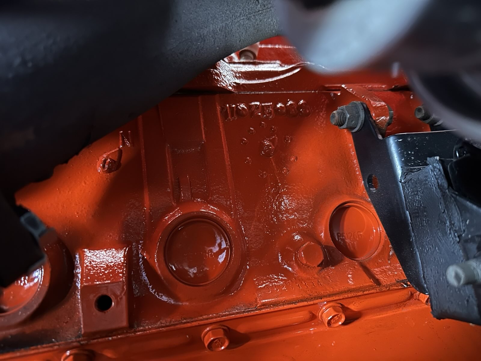

Unfortunately, it has a TA block out of a different T/A or AAR (Stamped 0B2????4). I hope the buyer was aware of the NOM as there was no indication it was not a matching-numbers engine.

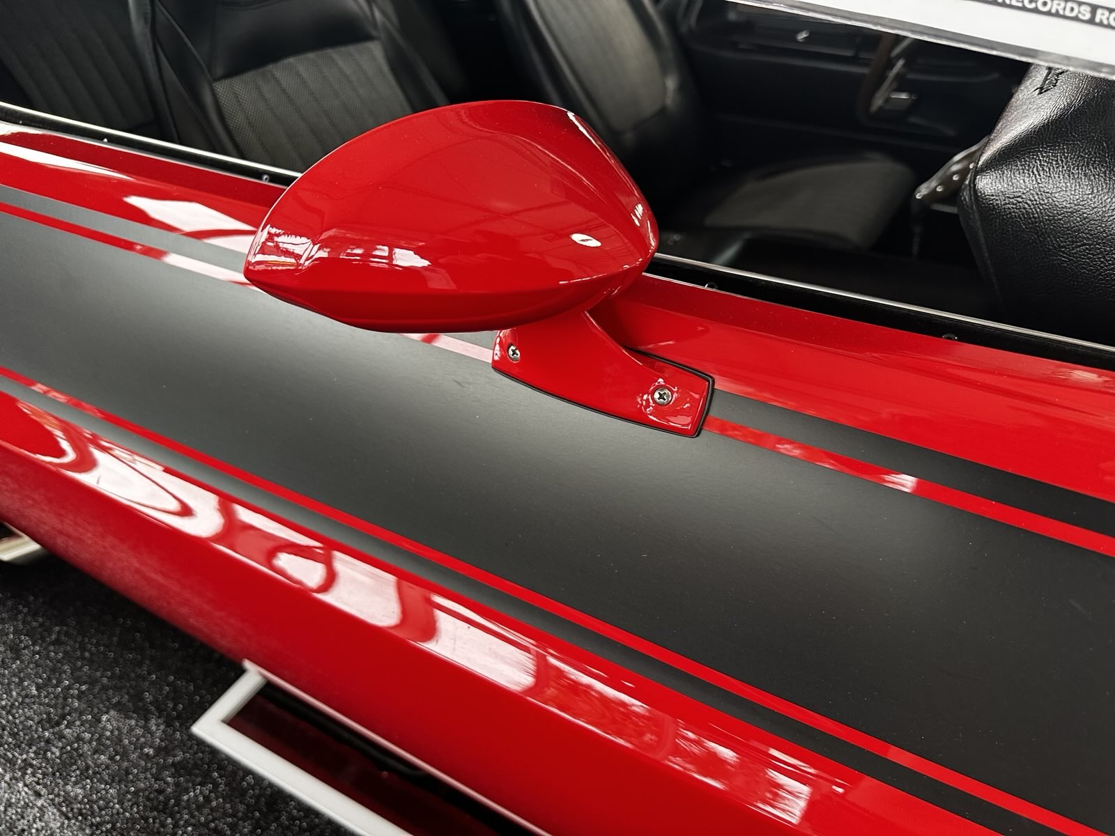

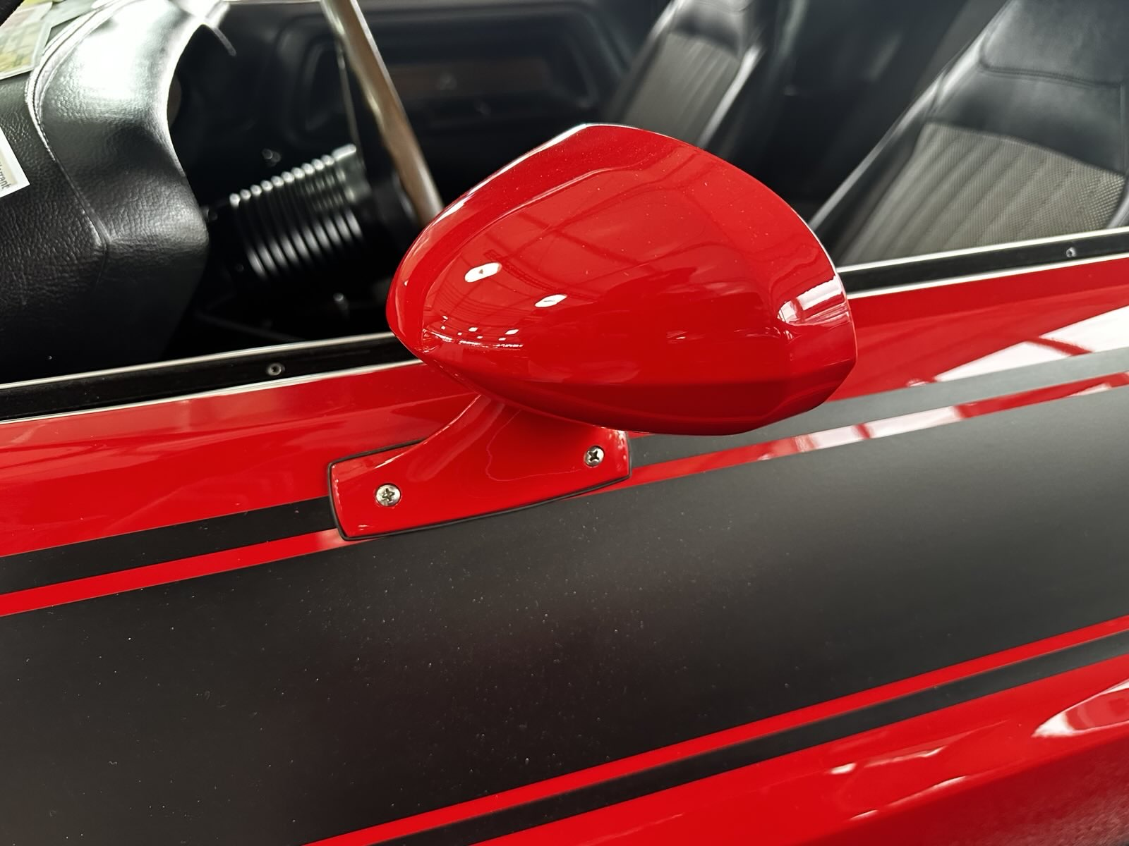

The car presented very well but had a stripe problem requiring replacing the stripes (no cutouts at all for the G36 Dual Racing Mirrors).
I have never seen the stripe issue before. That is a hard mistake to make but may be due to using stripes marked for mirror cutouts and failing to do so.
