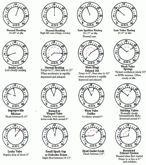

How long and what engine speed was the break in? Does it go back to good character? Rocker arms loose after heating up. I would put a vacuum gauge on it. Check the cap and rotor for corrosion. Been there done that new cap the summer before, go figure.
Not broken in yet still needs 400 miles before I get on it the cap looks great. Thanks for the vacuum chart will recheck timing and hook up my vacuum gauge and see what happens

All being said is food for thought and trust this isn’t the case. When I rebuilt the engine the original factory cam was used with the machine shop blessing after inspection with assembly lubricant and using high zinc Lucas 10w30 for classic cars. I did check the vacuum holding steady 14-15 “ at 850 rpm I also found the power brake vacuum gauge vacuum tap rubber cap with small holes and replaced after checking the vacuum hope to make a run and will let you know how it went and thanks for your suggestion's
