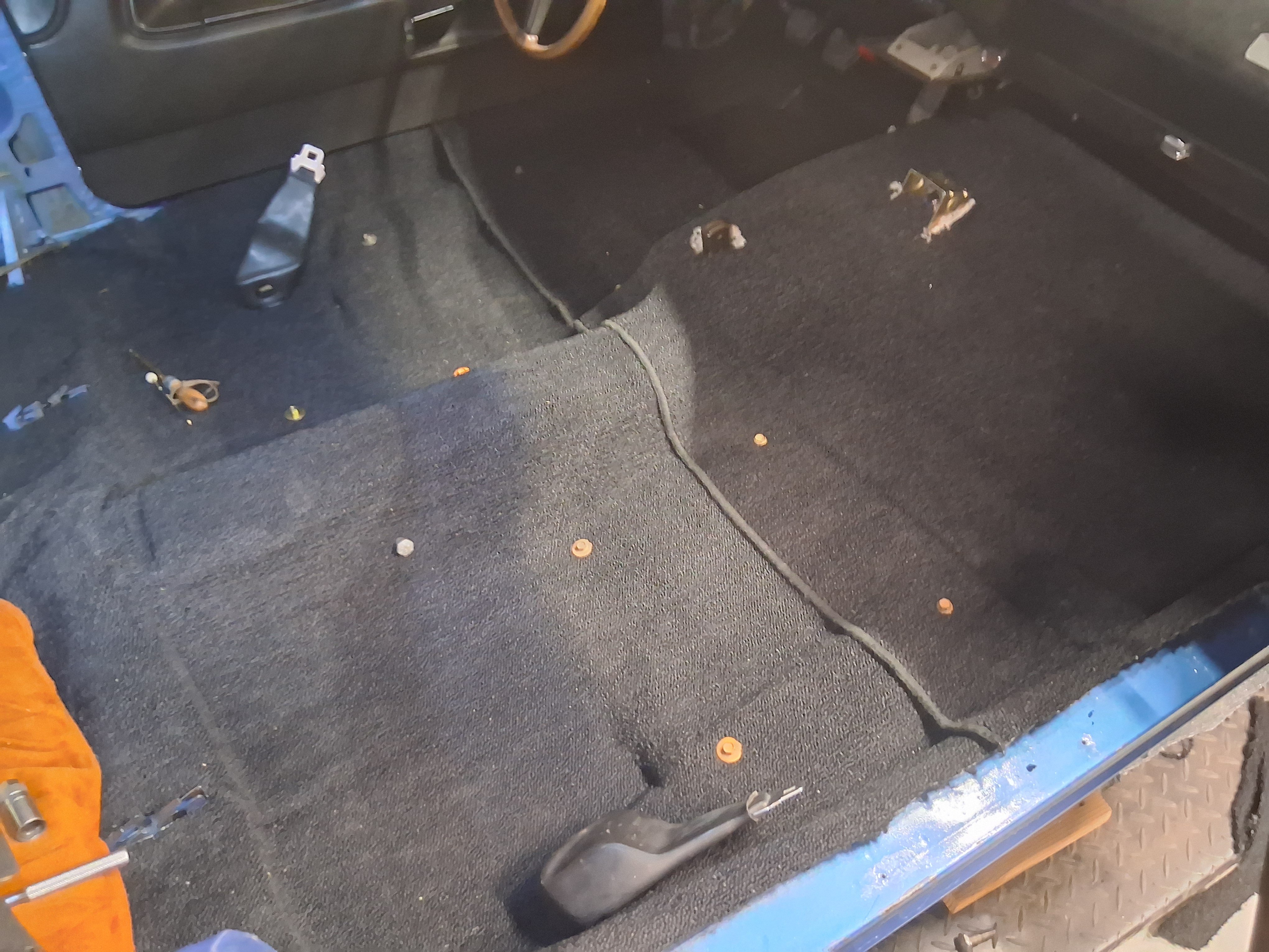

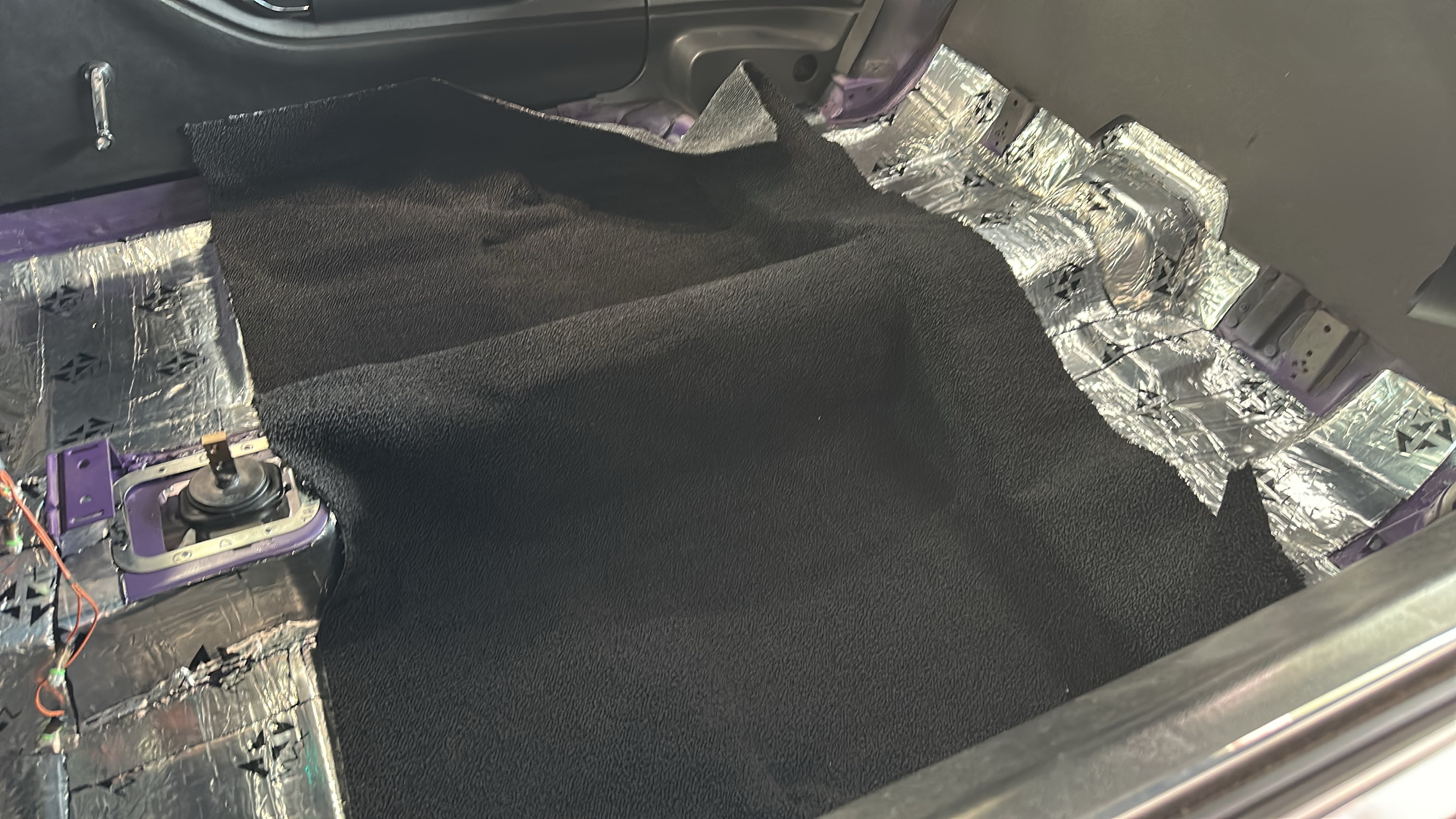

Hi, I am in process of shaping a new ACC front to the floor pan in my Challenger. This is the standard carpet, not the one with the mass backing. The rear carpet is in and sitting nicely. Per discussion on the forum, I used weights and double-sided tape to pin the carpet down, and a soldering iron to punch the holes for the seatbelt bolts.
I am doing the same process with the front section. I left the weights in place for weeks because it is winter now and the carpet is stiff from cold. However, it warmed up enough today for me to put the trim ring in place around the 4 speed shifter. I used thin strips of carpet tape to hold the carpet down around the shifter boot.
My question now is how to go about shaping the carpet directly below the shifter boot, where the right front corner of the seat will go. I have seen pictures showing the carpet was molded really tight here on the originals but this is a complex shape with sharp bends, not a gentle drop off. My thought is to use a heating pad or shop light to warm the carpet and make it flexible, but it looks like it will bunch up badly when pressing it down. It already has a sharp wrinkle forming at the trim ring at 7:o'clock. I have a heat gun but I am not enthusiastic about using it because I do not want to melt the carpet fibers.
I would welcome any thoughts from those of you who have tackled this before. I have carpet tape in place along the transmission hump on both sides, but it is still sealed on top - it is only sticking to the floor as yet.
Thanks!

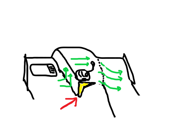

I do not have a photo at the moment, but I attached a sketch showing the area I am most concerned about - it is in yellow and a red arrow points it out too.
Green arrows are to show the contours where the floor meets the transmission hump - it is much steeper on the driver side than the passenger side.
I hope this helps!
The yellow area is where I see the most difficulty. I plan to attach the carpet to the floor along the hump on one side first (using carpet tape underneath along the joint), then stretch it across to the other side and weight it down before unsealing the tape.

i think that yellow area is hidden below the center console, so a slice in the carpet to allow the flat parts to lay flat might do the trick. there may not be enough carpet to traverse down the vertical backside of the shifter tunnel

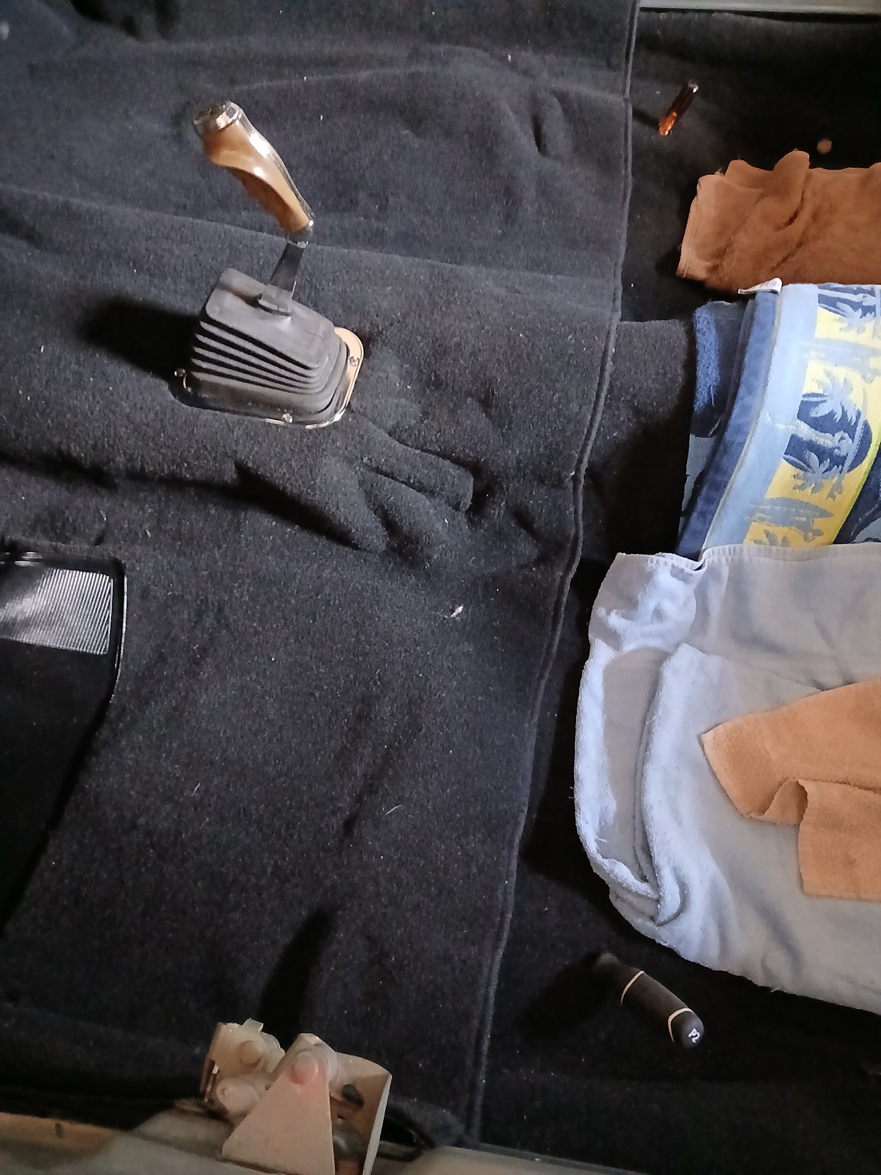

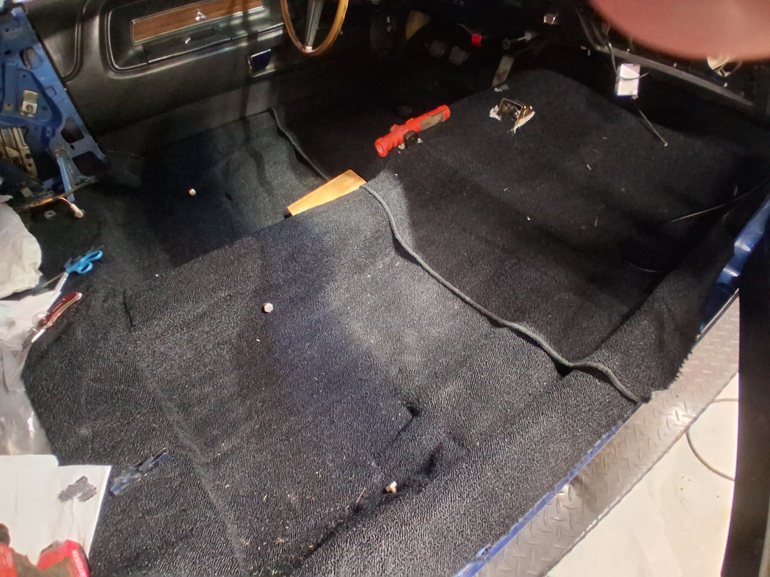

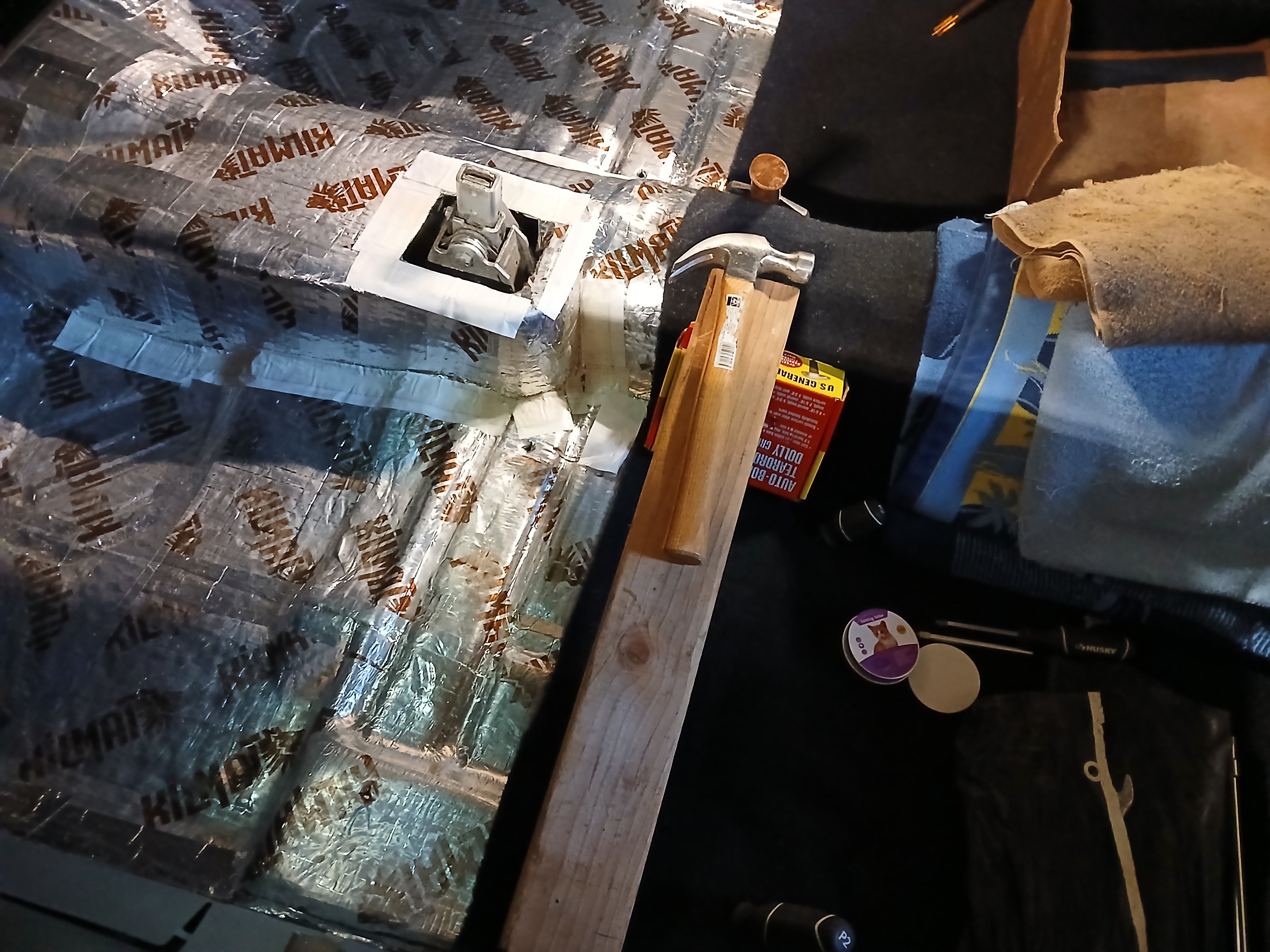

Pic below shows the actual spot I was asking about, at lower right corner of the shifter (from this angle) and to the left of the hammer. Front carpet was temporarily removed for this shot. It is back in place now. I will add an updated photo.
Thanks again!

Here is photo of the carpet in place, with trim ring and shifter installed. You can see marks where I had weights on the carpet to give it some shape. I had good luck with the back carpet using a heat gun under the carpet to heat up the backing, then molding it down onto carpet tape where the seat platform joins the footwells, etc. but that is harder to do up front. When we get one our mid-Atlantic thaws I will give it another try.

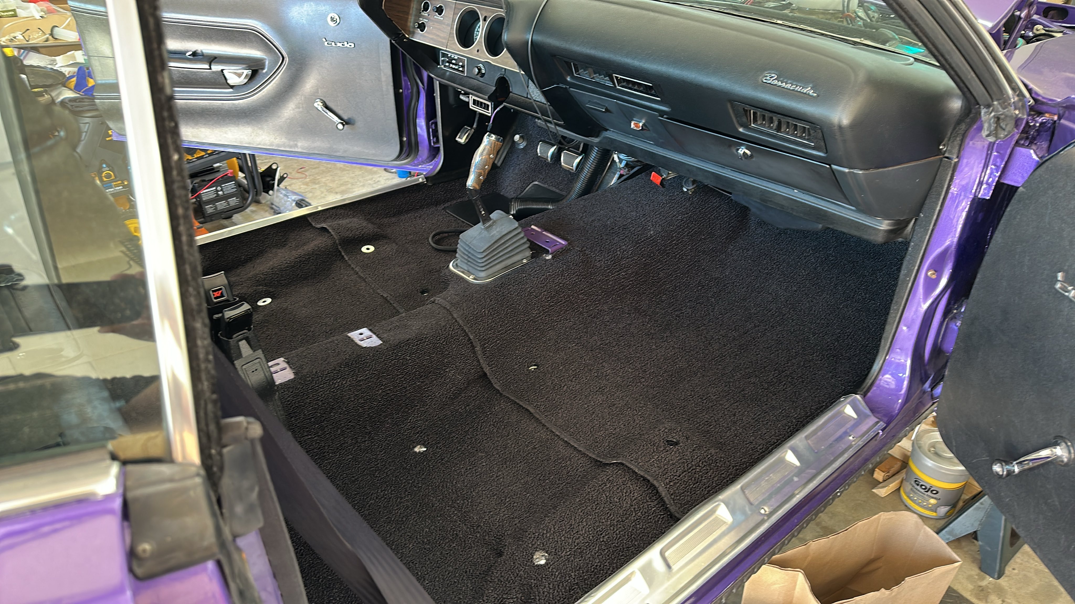

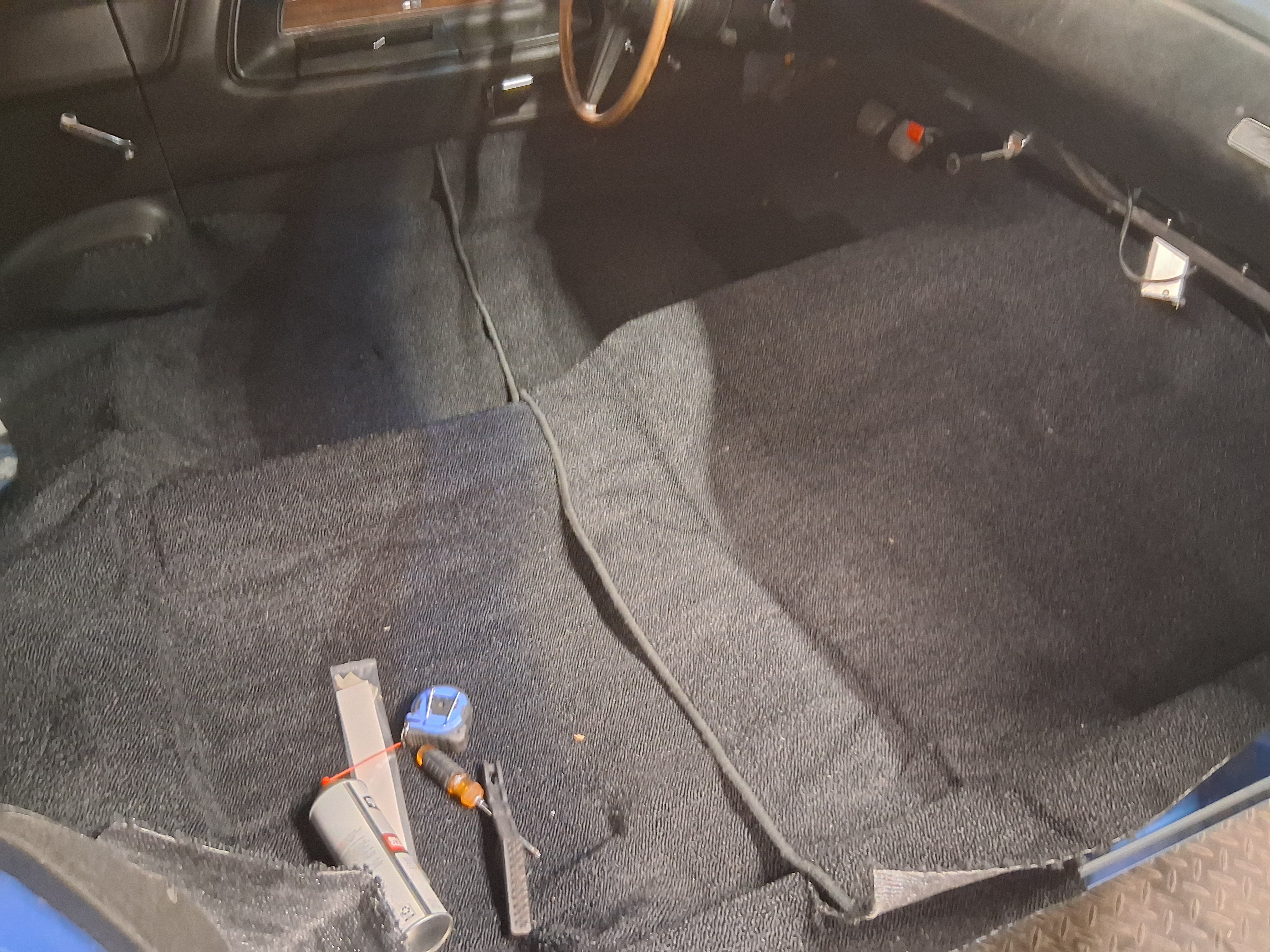

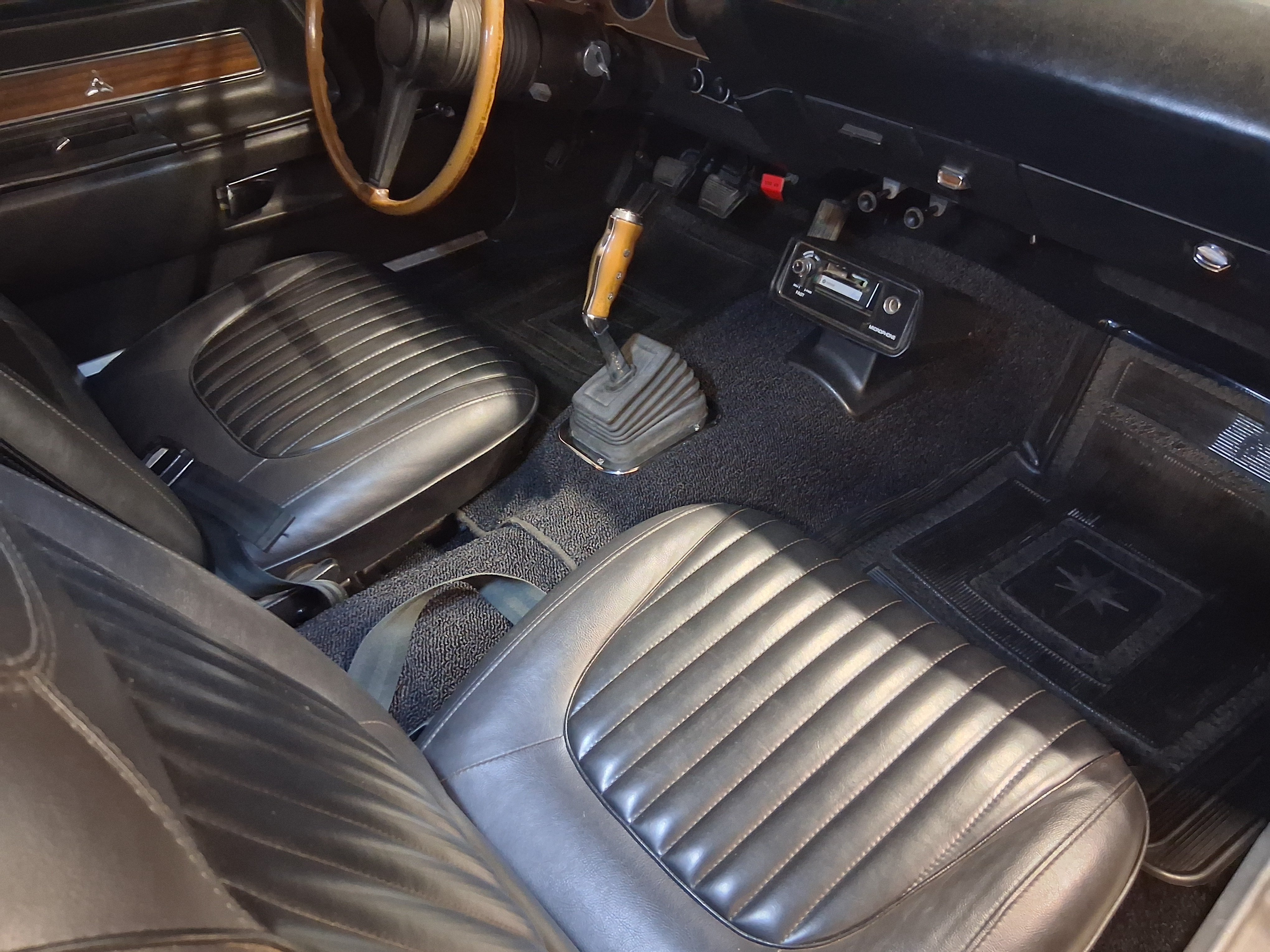

I just went through this in my 71 Challenger this summer. Letting the carpet lay out in the car helps. Here's 4 photos to show you what I did from laying it out to the finish. There's still a little bit up on the back corner of the tunnel hump you had circled. I plan on steaming it at having a heavy weight placed there soon. It looks pretty good considering the carpet only got to set out for a short time before install. Photo 1 is initial layout. Here's the link to my install:

this little burble is hard to avoid. see how the 2x4 is trying to hold it down in other photos of post #12? you may have to live with some of it.
