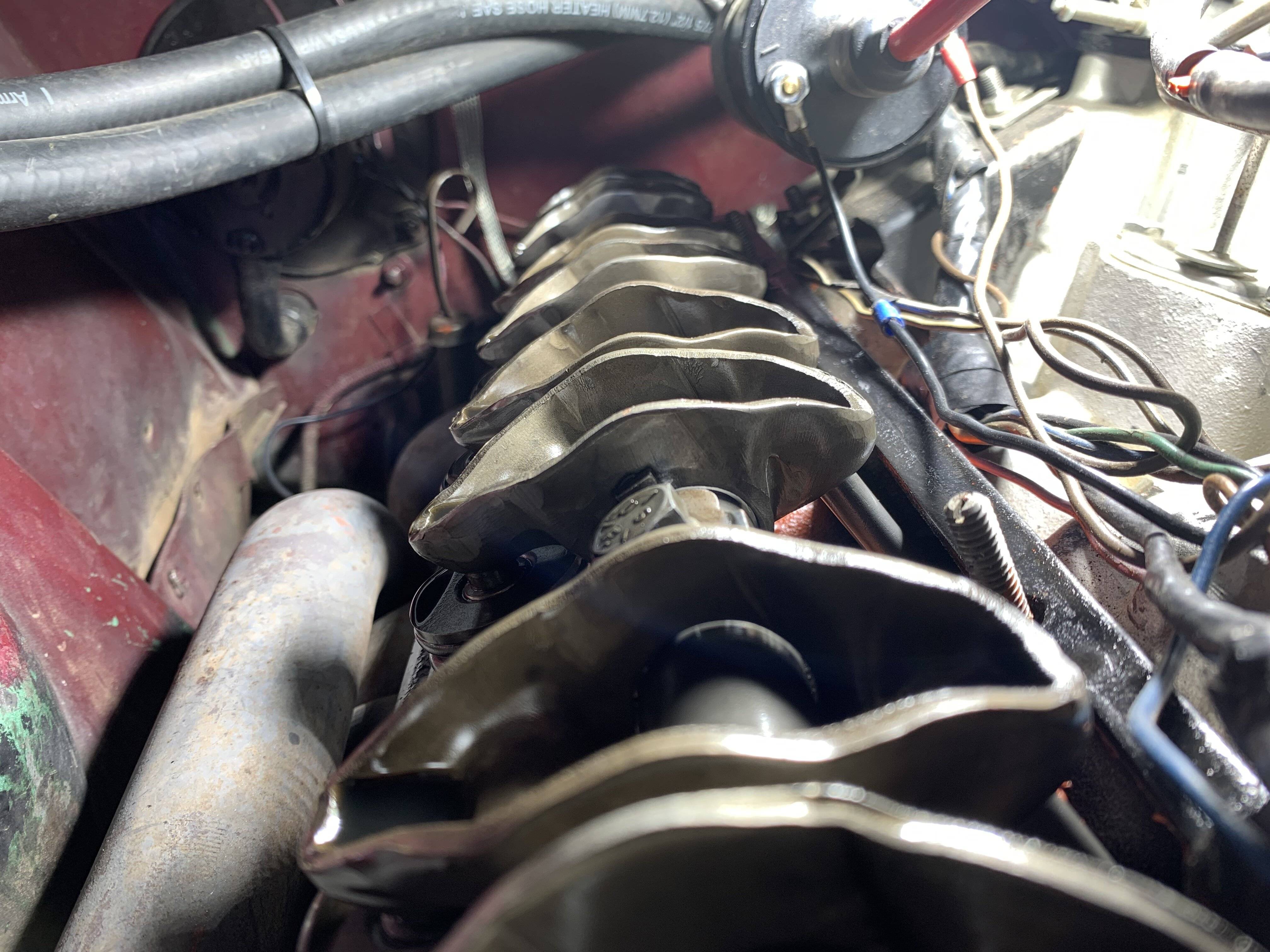

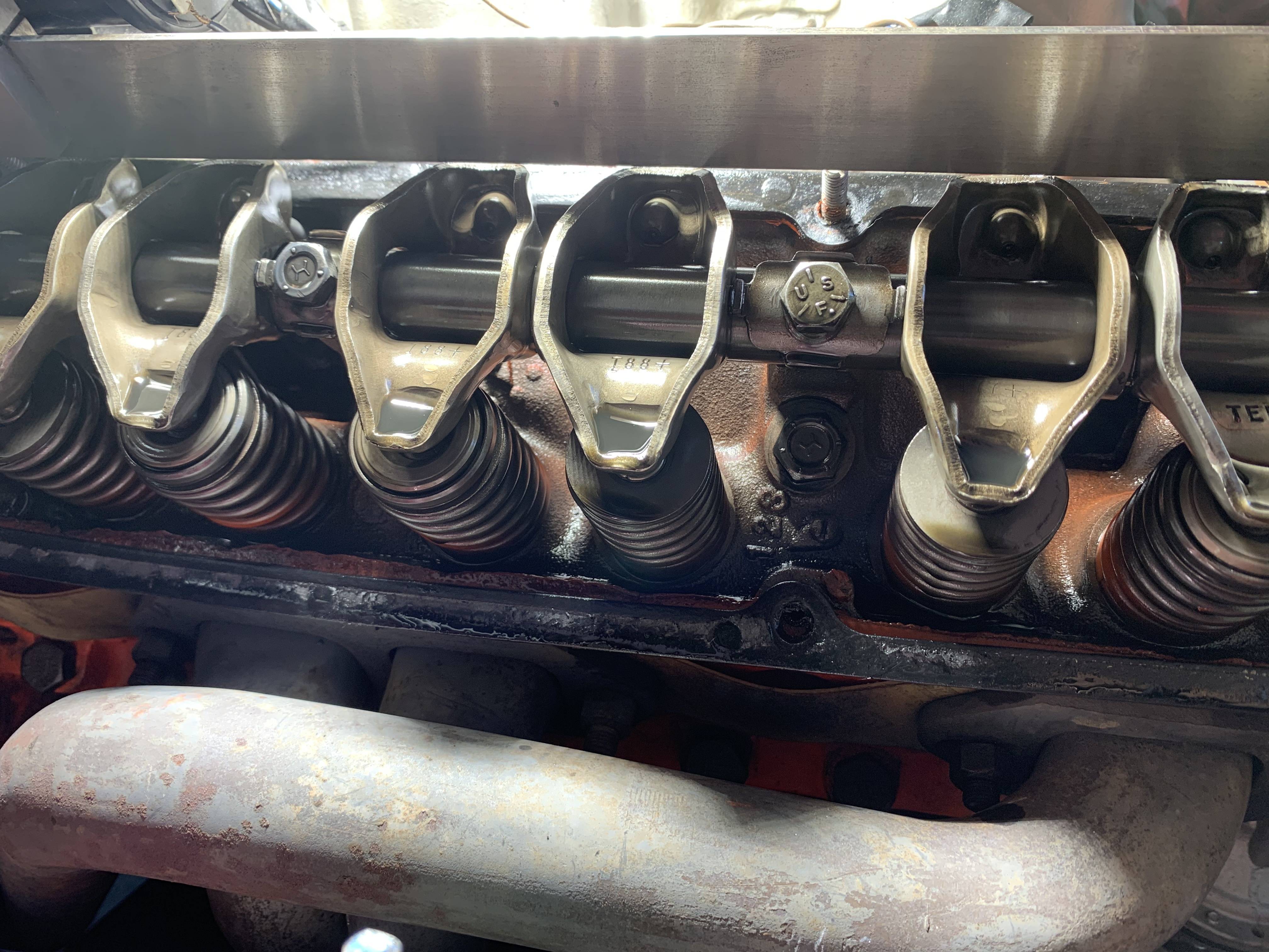

There was always a problem that surfaced around 2800 RPM, and that was a stumble/pop/afterfire out of both exhausts. I tried many things from troubleshooting ignition and fuel, checking plugs, wires, nothing helped. Finally, I had a moment. Yesterday I had a valve cover off, and noticed the rockers were all just about at the same angle. Dammit. I'm pretty sure I know what that means. My cam is flat. Whether this happened because I didn't prime before starting or the previous owner didn't break it in properly, I don't know.

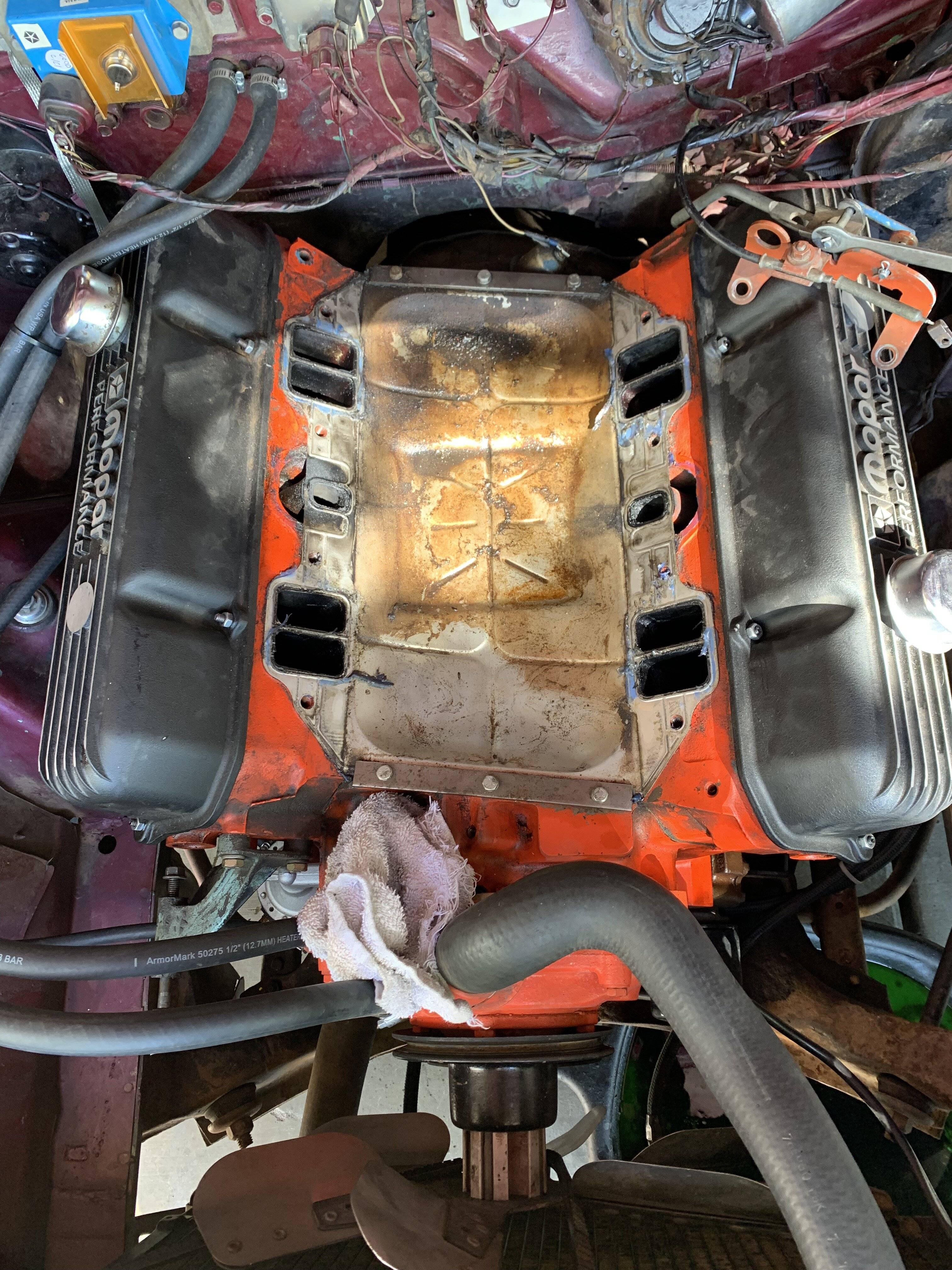

I need to pull the engine and confirm (also cut open the oil filter), but I'm quite certain that's what it is. So, I wanted to start a thread documenting my 440 rebuild for those interested, and because I know I'm going to have questions. I rebuilt my 318LA a couple years ago, and had immense help from the members over at FABO, so I'm pretty confident going into this.
