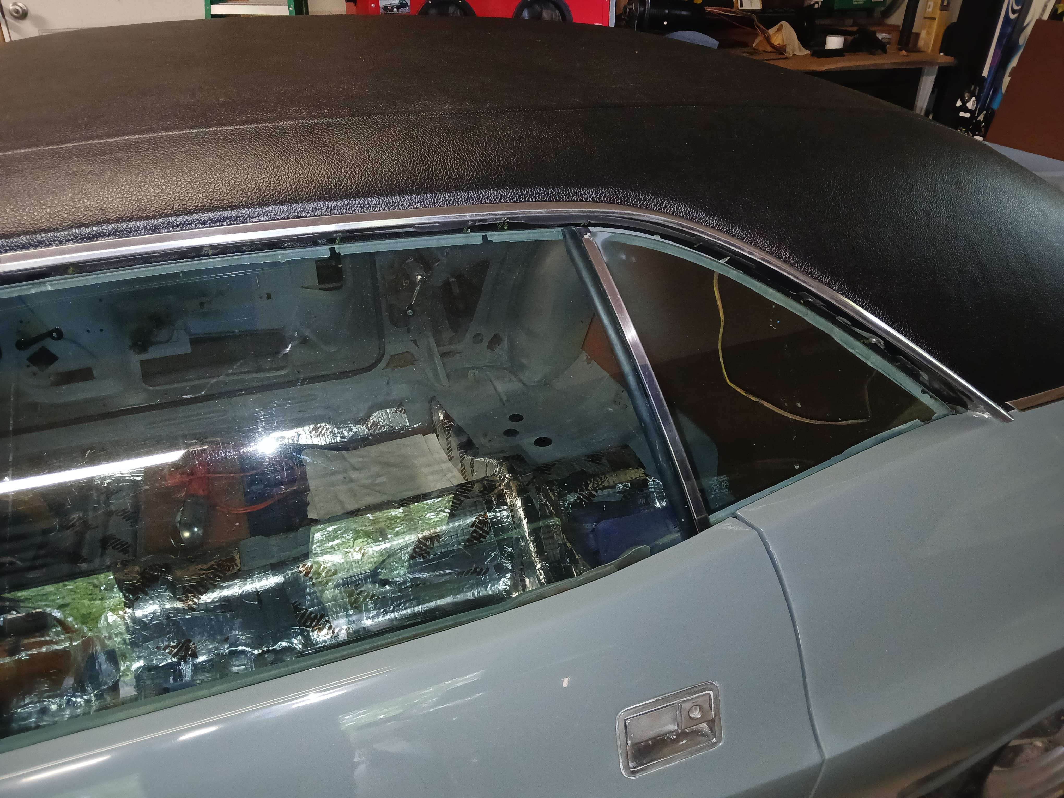

I have a pair of brand new seals for the quarter panel windows on my 73 Challenger. It should be a simple task to insert them into the stainless steel tracks, or rails, that frame the forward edge of each window. However, it is proving extremely difficult to slide them into place without them distorting badly about halfway down. I have tried soapy water and Meguiar's rubber preservative for auto weather stripping; neither worked well. Has anyone tried something that works better? I have seen some discussion online saying this is not an easy task (so far, not many of those LOL).

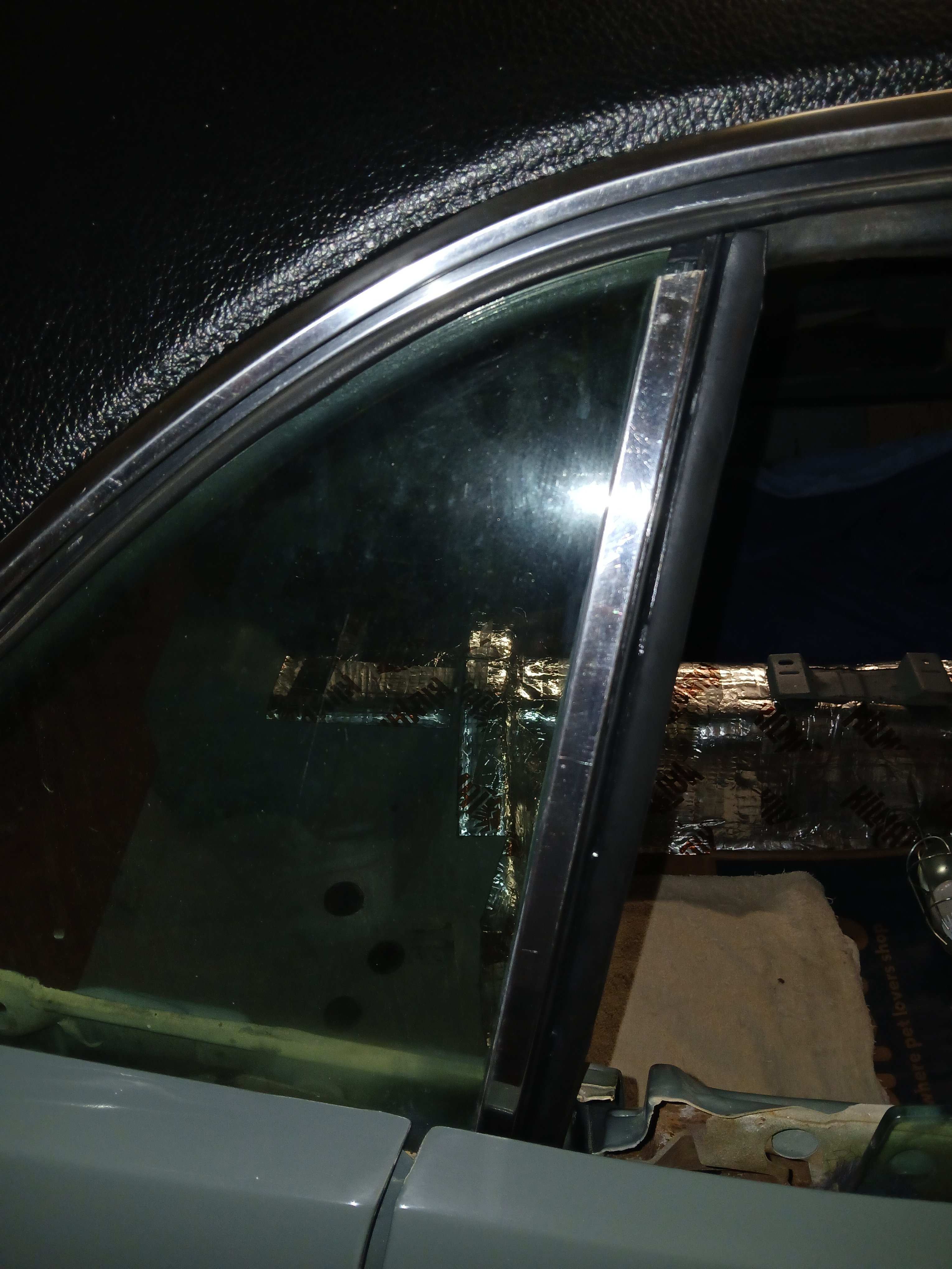

I am glad to report that I had some silicon spray in the garage, long since forgotten - and there was no need to bring in the nuclear weapon of KY. But the silicon worked great, especially on the driver side where I sprayed the heck out of both track and seal. It was a little tougher on the other side for some reason. On both sides, I was worried the whole time that the new seals would tear because I had to put my weight on them to get them to go past half way. I did not want to destroy brand new, fairly expensive seals (I got them at the Detroit Muscle Technologies booth at the Carlisle PA Mopar show in July). But they held up.
Check out the photos. You can see, if you look close, that on both sides there is a slight gap, maybe 1/8 in, between the top of the stainless track and the top of the window that the rubber seal does not cover. In both cases, the seal is down tight against the upper edge of the quarter window glass, so I am not sure what is causing this. Either the stainless track slipped down a bit along the glass, which is hard to believe, or the rubber seal top is not quite tall enough. I can slip some extra rubber material in there to close it.

Here are the two photos I took today.
