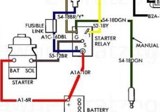

The job of the neutral safety switch and starter relay is doing this very thing, blocking the starter from getting power when conditions are unsafe - example: the gear selection suggests it is not in neutral or park.
Confirming the function of, and the proper grounding of the starter relay would be the first thing on my TODO list to verify, troubleshoot and confirm. Some relays MUST be grounded to the chassis to work correctly.
These cars are 50 years old, and when changing hands through owners they can and will fiddle with, change, and/or break the factory wiring. Changing out the starter relay, or safety switch won't resolve any wiring problems.
Since you can start the car with a screwdriver, and it otherwise runs fine and shuts off with the key, then the other systems appear to work just fine (ignition, fuel delivery, spark, etc.)

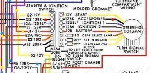

It may be time to crack open the service manual, and study the wiring diagram, and begin checking things out. By checking out, I mean hooking up a meter and confirming the wiring. The problem may very well be the seatbelt interlock system, or a loose/incorrect connection on the neutral safety switch.
The 18 gauge dark blue? wire should be, if memory serves, grounded when in "safe condition" that is, transmission in park/neutral (and for 1974 seatbelts buckled.)
If the 18DBL? wire is not grounded, jiggle the gear selector while testing to see of it goes to ground at any time. For that matter, jiggle the seatbelts and engine bay wiring harness that may show a broken or loose connection.

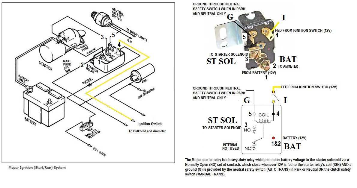

I had to go look myself, because I have a 74 Challenger and have had issues similar to yours (none right now).
Here is more info from for B Bodies only;
74 charger identify this part?
This was a schematic they used (created), so I am not taking credit for this myself...
Hopefully this helps.

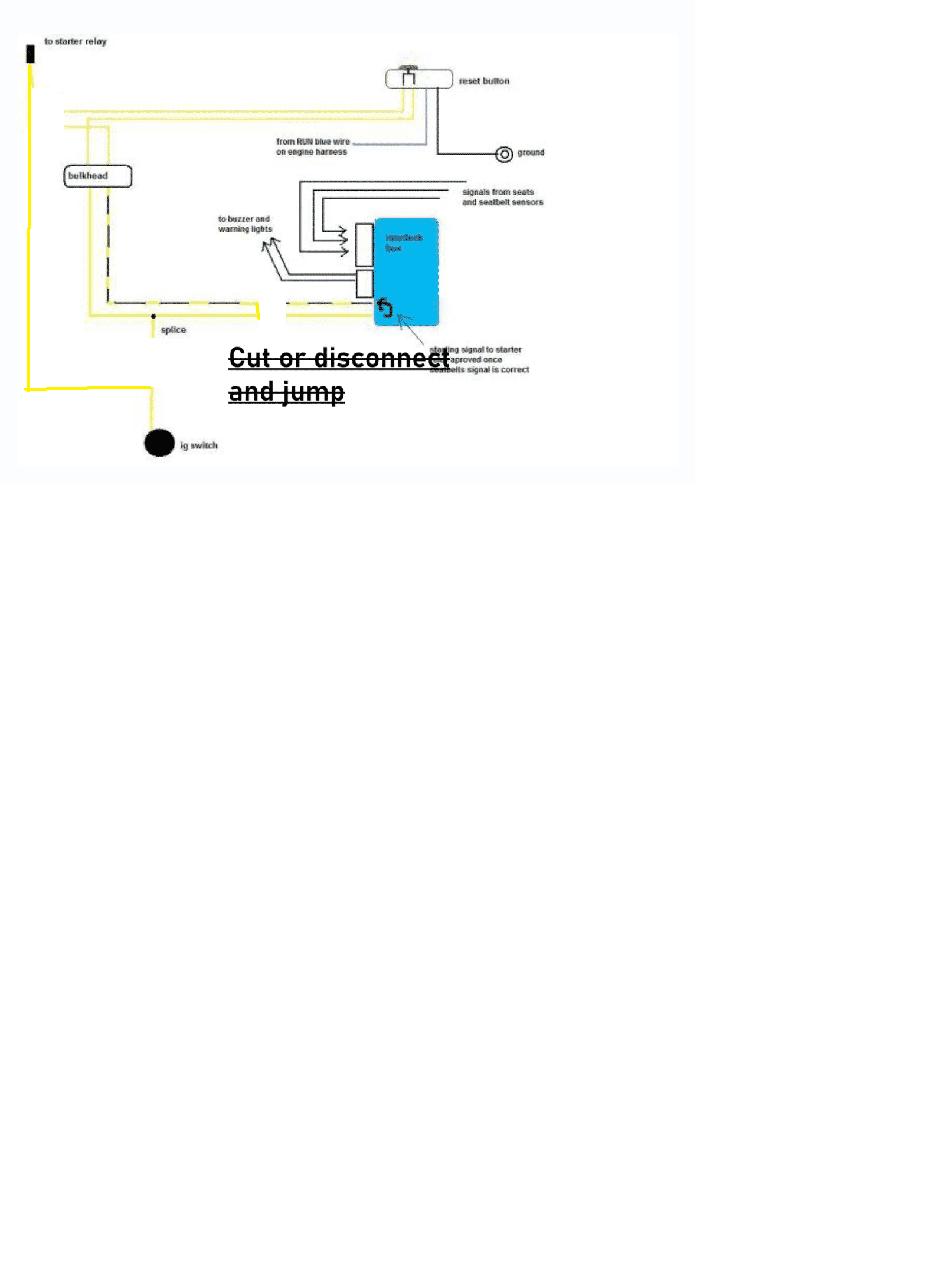

If it's the seat belt warning. This should fix it.
It gets power from the yellow wire for the starter relay. Might be able to disconnect the ground to keep it from functioning. Or disconnect everything just run an other wire to the relay as shown. How ever you do it. There just has to be one wire going out to the relay. Use one of the existing.
1972 AAR Cuda
Sorry for hacking up your diagram. Thanks for posting it.

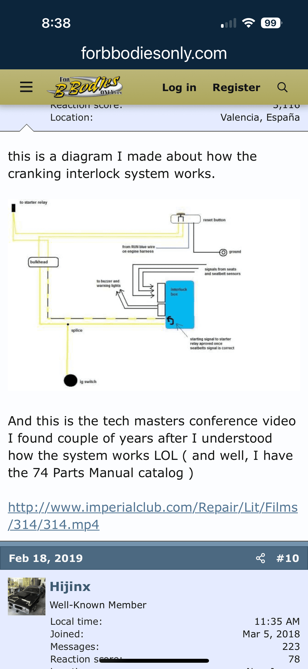

No problem, but its not my diagram - I borrowed it from B-Bodies only, but jumping the yellow wire was what I understood to be the fix (bypass)... I plan to try that with mine, since I also have a 74... my interlok was disabled before I got the car and I needed to understand the system to make sure past start issues are resolved so this looked like what I needed.
Bulkhead connector 19 is the ign starter relay wire without the seatbelt circuit. This where there are some difference in the wiring from year to year. In general there all pretty much the same. Not a big deal just look what your doing. This engine diagram also shows other accessories and state spec requirements.
