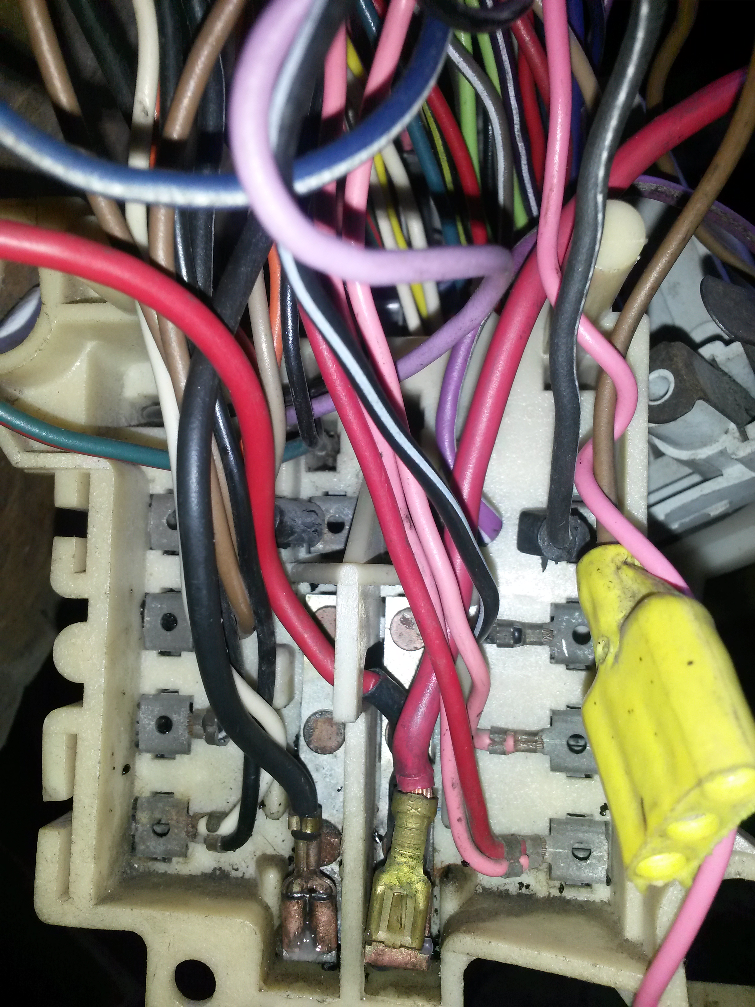

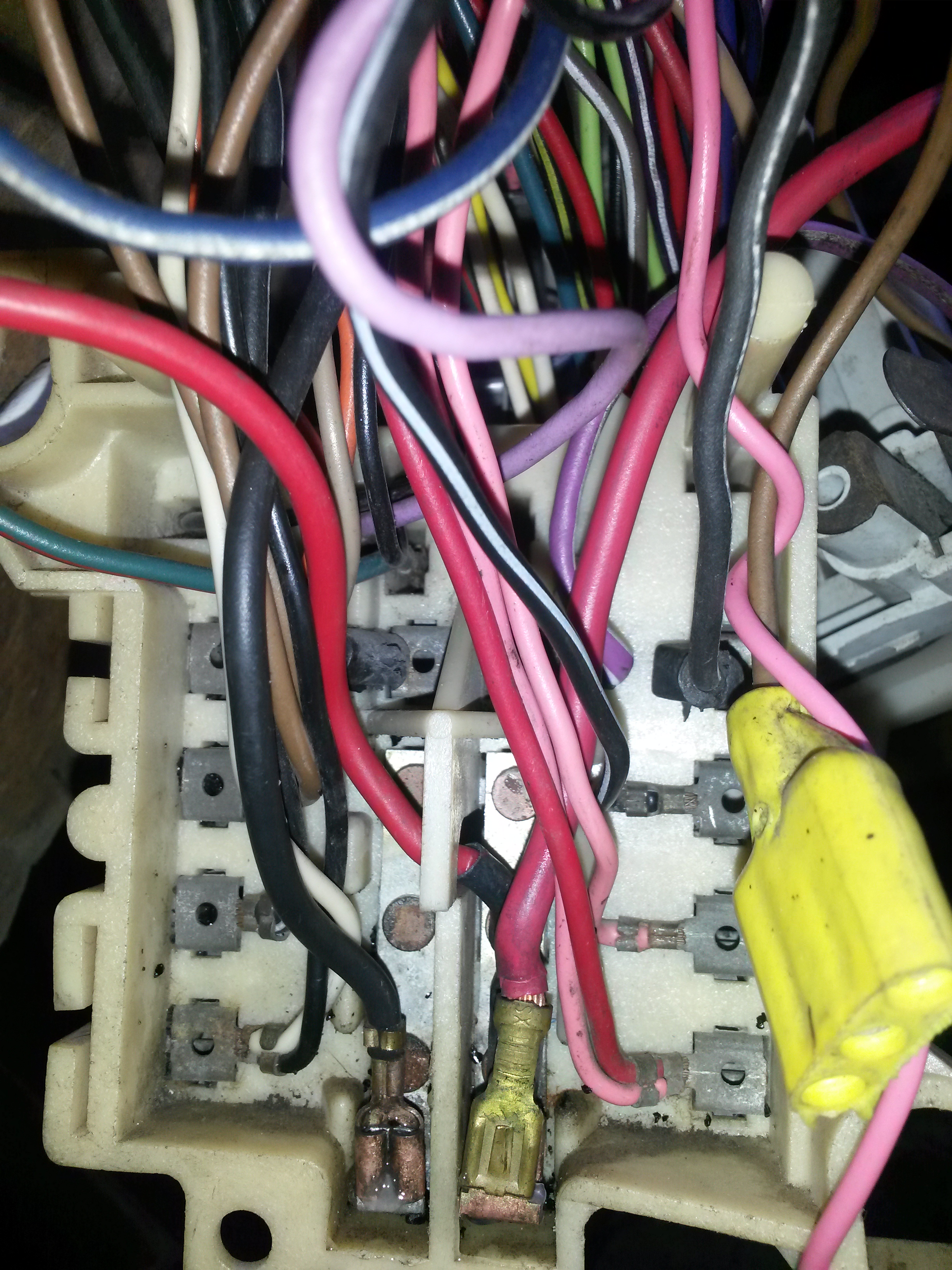

OK that I'm not sure of.that black wire i'm talking about is twelve volts..

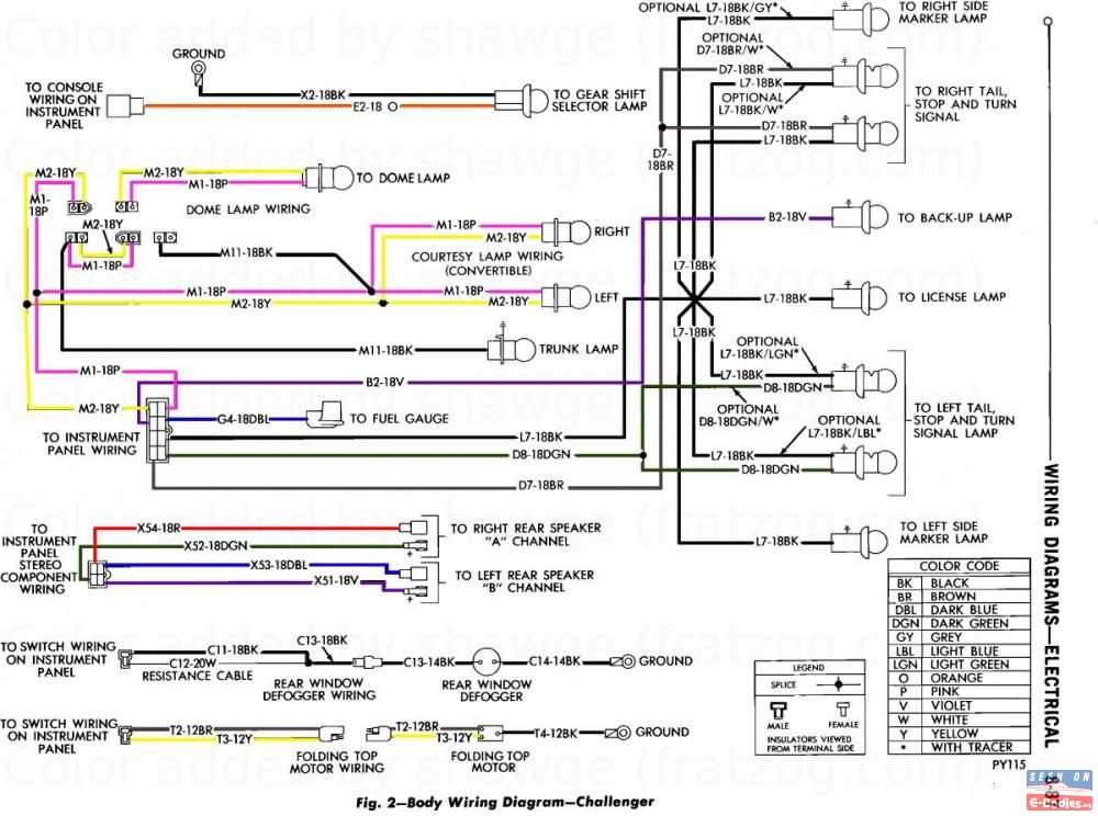

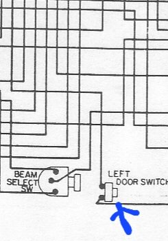

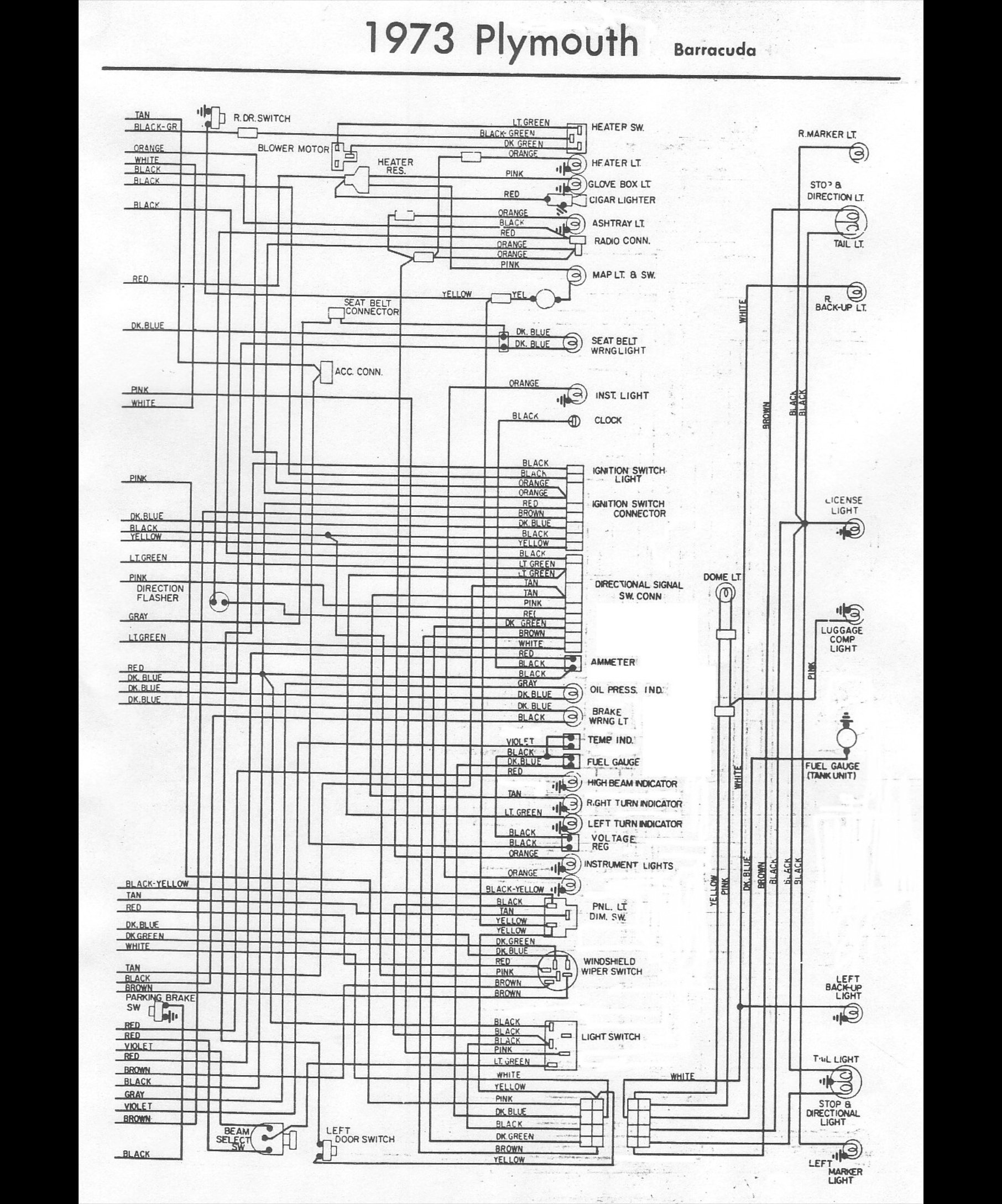

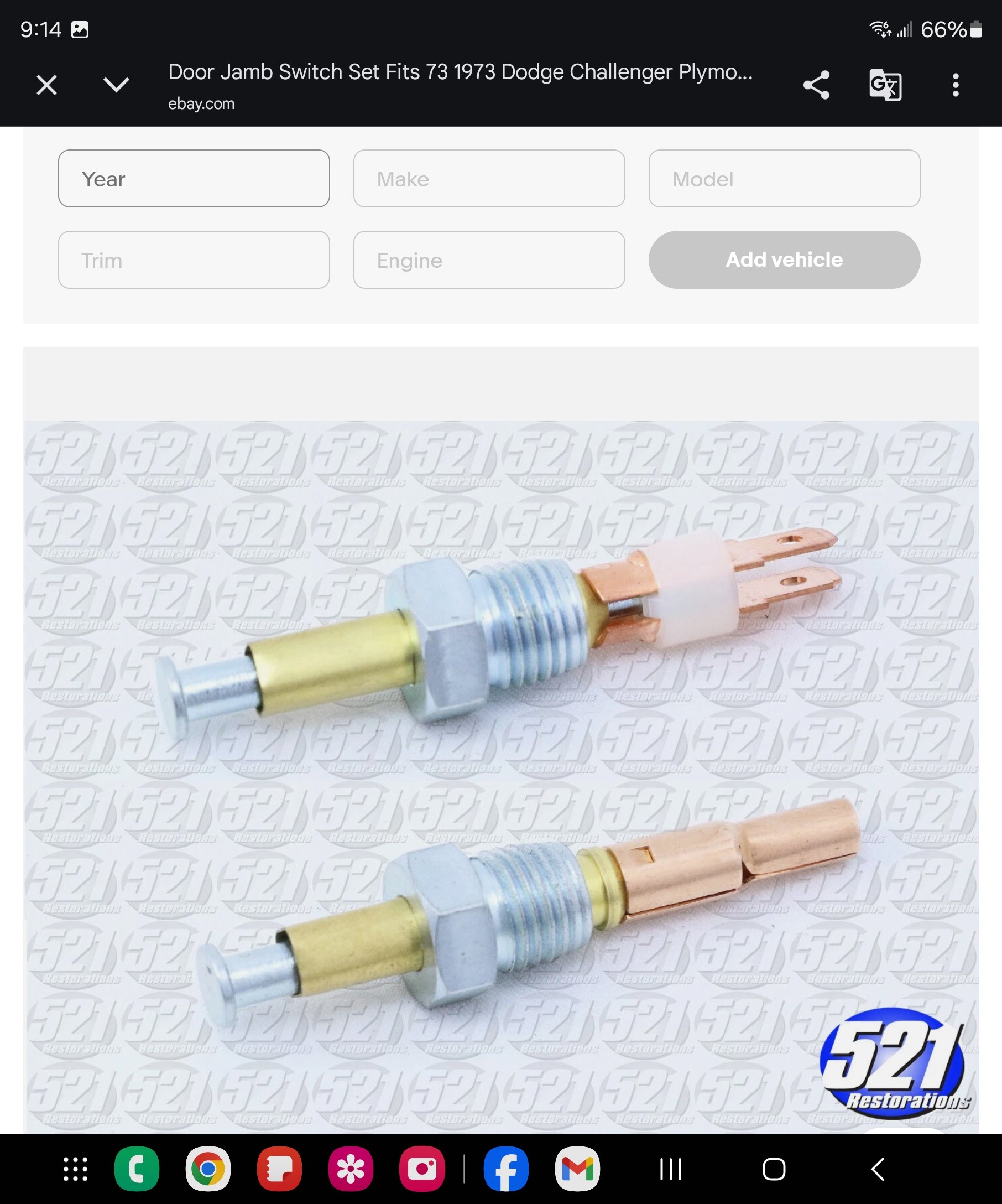

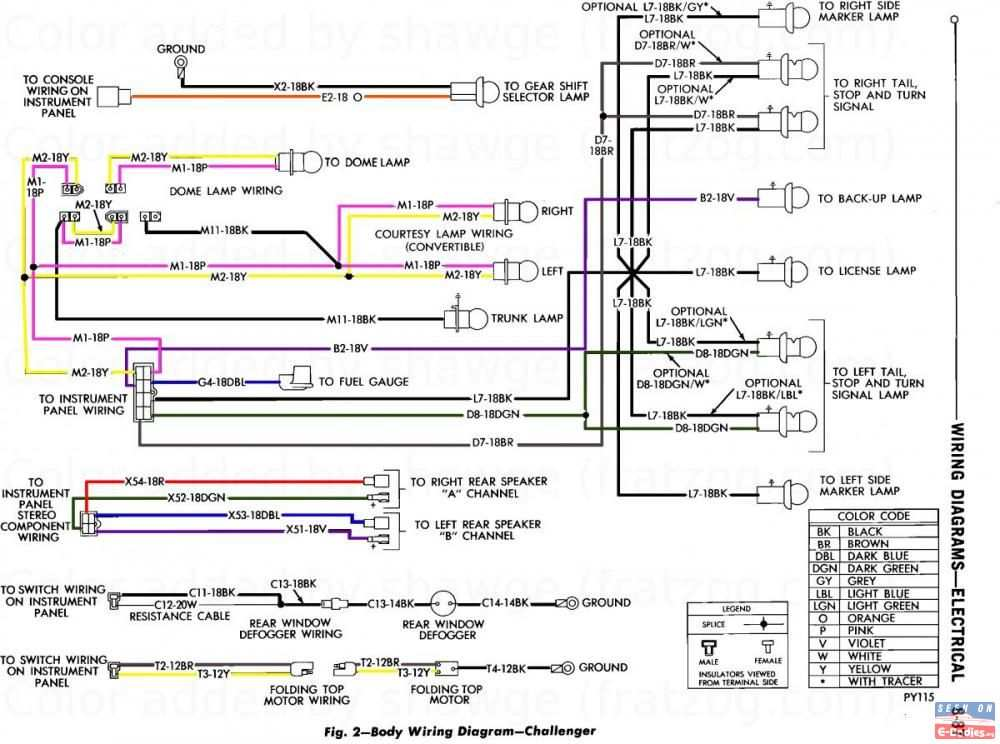

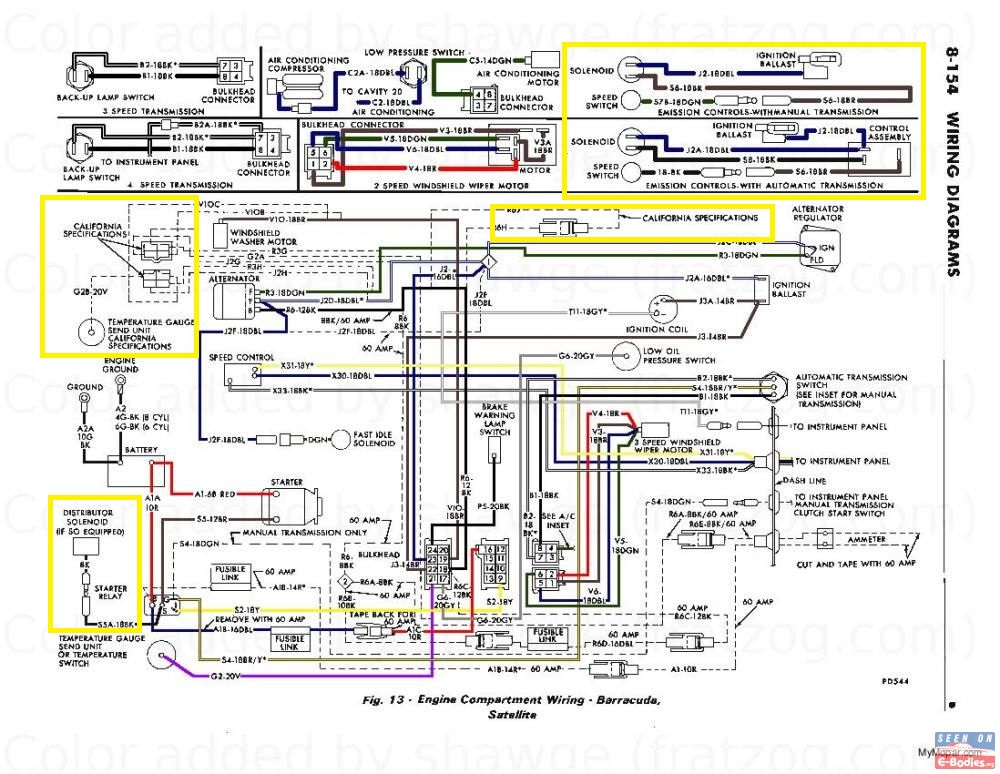

Is the 73 barracuda body wiring different than the challenger wiring....All I can say is that the color is different than stock wiring. It should connect to the door sw. Not sure if you have the right door sw. That wire you are showing goes to the dome light. The dome light is powered by the door sw and the dimmer sw.View attachment 152508
I found this may help explain it lol... four a seventy three barracuda...I do think there were different A01 door switches some years. I know 71 is different then 72.
