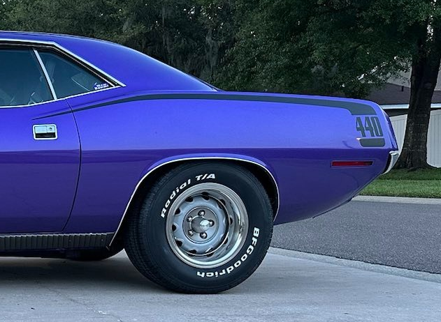

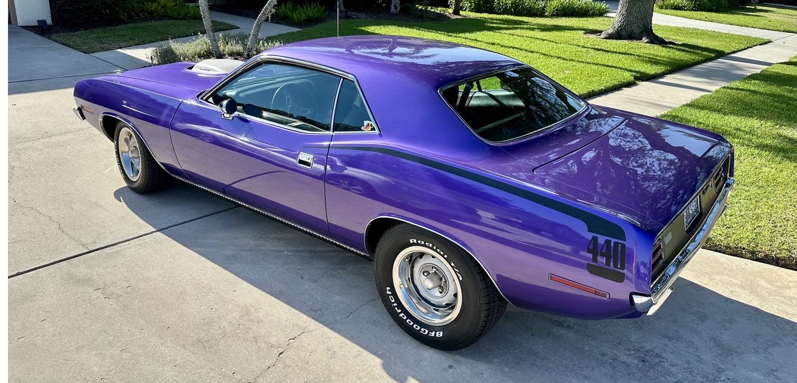

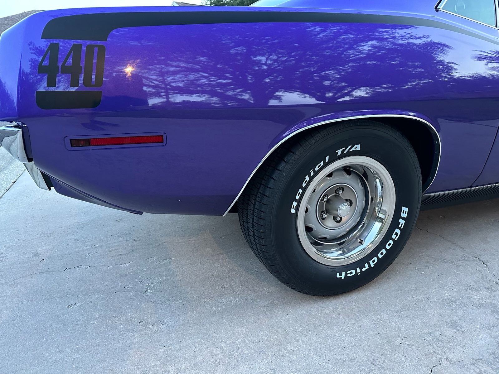

does any one know what the offset was on the factory Chrysler Ralleye wheels. I’m going with 275’s on the rear so I think right around 0 mm would be best. I see a lot of the cars on the site have the rally wheels so if you do, what’s the offset on yours?. my car has no mods at all.
The 14" Rally wheels had a +.5" (+12.7mm) offset. The 15" Rally wheels had a +.25" (+6.4mm) offset. I currently have a set of 17x9s with a +10mm (+.39") all around that fit very well.

Thanks for responding, that answer actually helps. So I think I would be fine with what I want to do.
