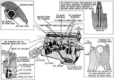

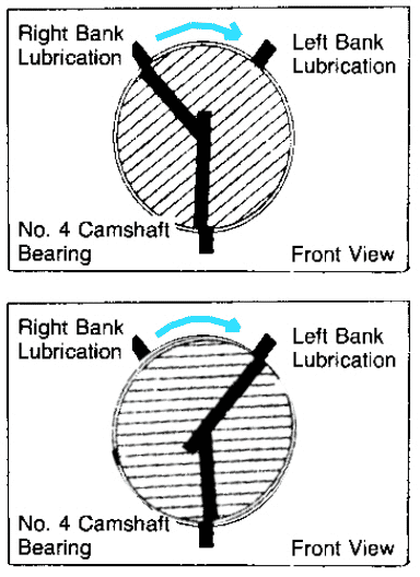

Try this I think it's same for the LA block.
The big block Chryslers that the right bank (2,4,6,8) will prime when #6 cylinder is on TDC and the left bank (1,3,5,7) will prime when #8 is at TDC.
The big block Chryslers that the right bank (2,4,6,8) will prime when #6 cylinder is on TDC and the left bank (1,3,5,7) will prime when #8 is at TDC.View attachment 154500View attachment 154501 View attachment 154502
For a small block:
To get oil up to the rockers on the driver side (1,3,5,7), turn the crank to compression stroke of #6TDC. Spin the oil pump.
To get oil up to the rockers on the passenger side (2,4,6,8), turn the crank to 90 degrees before TDC of #1 compression stroke. Spin the oil pump.
